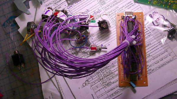

I built the, "digital pattern generator". It is very cool. At the moment it needs a panel so its kinda messy but you can get some cool little sequences out of it. It is kinda wacky and unusual. Each pot sets a "range", so the next pot after the first step covers another range of pitches. The patterns seem random but not quite random. Its great for wacky fills, where you trigger it every once in a while, with another sequencer like the MFB drum sequencer. I will try to get an audio demo on here when I get a min.

Here is a demo of the "digital pattern generator". I recorded it the other day. I used an Oakley VCO, and I just played with the pot settings while it was playing. The audio is kinda irritating, but keep in mind that you can get some nice melodies if you have patience and dial them in just right, though it is kinda tricky.

so you just built that on a bread/perfboard from the synapse schematic? man i wish someone would do a press n peel layout. maybe i will try this on perfboard tonight.
where do you get that nice wire?

btw,those build instructions for the pattern gen, they look different!! never seen those before. where did you get em?

The docs you see underneath are for the JH kraut rock phaser. I think thats the pcb you can see in the upper right. I built this on to a protoboard from the synapse schematics. It wasn't too difficult. Though I was pleasantly surprised that it worked right away after plugging everything up. I got the wire from Halted. Its from a 1000 foot spool, that I paid only $15.00! Frikin excellent deal on that fer sure! I should have wire to last me for a while. I have used a ton of it already.
