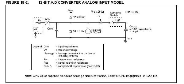

Is there a good, simple circuit for protecting the A/D input pins on a microcontroller? For example, with the dsPIC30F4013 the maximum allowed input voltage to any pin is Vdd + 0.3, and the minimum is Vss - 0.3. I would like my circuit to be robust enough that if someone manages to hook in +/- 10V on accident, that the result will not fry the micro (I tried +10 for a moment and it did, by the way). I thought I could use a simple diode clamp setup, but since turn-on voltages are in the range of 0.6V it does not seem as easy as just single diodes.
I am looking to leave the input signal unchanged except for having a set maximum and minimum, so I would prefer to leave out any kind of voltage division or scaling.
Any help is greatly appreciated.

Use Schottky diodes (like BAT85 maybe) and a current limiting resistor. The Schottky diodes will clamp at a lower voltage and they are faster as well.
Be sure to check the PIC data sheets for the effect that an input resistor will have on the AD sampling time needed, as extra resistance means it will take longer to charge up the internal sampling capacitor.

The dsPIC30F4013 already has protection diodes on the A/D inputs so there is no need to use any at all. Wink What is required is a series source resistor to protect these input diodes from getting damaged. Shocked
The A/D sampling switch resistance in the DSC is specified at 3K maximum. The interconnection resistance to the sampling switch is specified at 250 ohms maximum. If you use, for example, a source resistor of 1K between your analog source and the A/D input, this will equate to a charge time of the internal 18 pF holding capacitor of 383 nanoseconds when using the 5 time constant rule for charging capacitors to the source voltage. The 1K would be all you need with no diodes necessary as I mentioned. Just make sure that a minimum of 400 ns elapses between the time you change the channel address in the ADCON register and when you set the "GO" bit to start the conversion. If you do, you will be assured that no error (read - neglagable error) exists in your aquisition.

But ... should 5 times 383 ns not be more than 400 ns?
Hi Jan,
4.25K * 18 pF = 76.5 ns
76.5 ns * 5 = 382.5 ns

Thanks Bill, I read you wrong, sorry Very Happy
