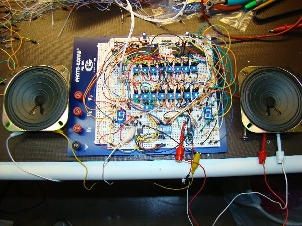

Monokinetic said:
Aha well there has been some interesting discussion that I almost missed out on. Bill the 2 PIC board with ICSP sounds super. I thought I could mention that I recently had a lot of fun sending 0-5v control signals from some basic Lunetta type LFOs into the PIC synth. Maybe your board could have patch points for the pot ins to accommodate also sending in such CVs?
Ahh, but of course, that is a fine idea and could easily "patch" over the potentiometers. Would just have to protect the MCU A/D inputs from anything above 5V but sounds like a nice idea.
Here is my list of things that are going to be sitting on top of this board:
(Fraktal 2x) Synthesizer PCB Ideas
(2) MCU's for Double the Fraktal FUn !
Prototype area
Line level pair (L/R) & standard modular 10V P-P pair (L/R) audio outputs.
(2) Onboard 1W audio amplifiers (left and right channel amplifiers).
(2) 6 pin ICSP programming male header for each PIC chip (For PICKit Programmers)
(2) 6 Pin RJ11 modular programming connectors for each PIC chip (For ICD 2 & 3 Programmers)
(2) analog 2 Pole State Variable Filters with electronically selectable Low Pass, Band Pass and High Pass mode with resonance control.
(2) Patchable "Multi Wave" LFO's
(2) Optionally installed PT2399 Delay processing chips for chorus and delay FX
MIX level between DRY, FILTERED, and optional PT2399 delay FX
PAN LEFT/RIGHT level for each synthesizer
Improved Output PWM filter by utilizing an active 2 pole, low pass filter with a 5 KHz cutoff to keep baseband PWM noise out of the audio chain. (original filter improvement in terms of placement of cutoff frequency and slope)
(*) Addition of BANK select logic for expansion to 16 banks of 16 patches for a total of 256 patches (currently there are 8 patches)
(*) SYNC OUTPUTS (5v or 10v output selectable)
(*) SYNC INPUTS (1.5v to 10v input level)
(*) For expansion
Here is one of the bread boards with the two main MCU chips on it.
Bill
 Filesize:  1.04 MB
 Viewed:  700 Time(s)
tazer
Joined: Oct 18, 2010
Posts: 49
New postPosted: Thu Mar 10, 2011 4:44 am    Post subject: Reply with quote  Mark this post and the followings unread
that is a serious bit of breadboarding there Bill!! Hail the Master

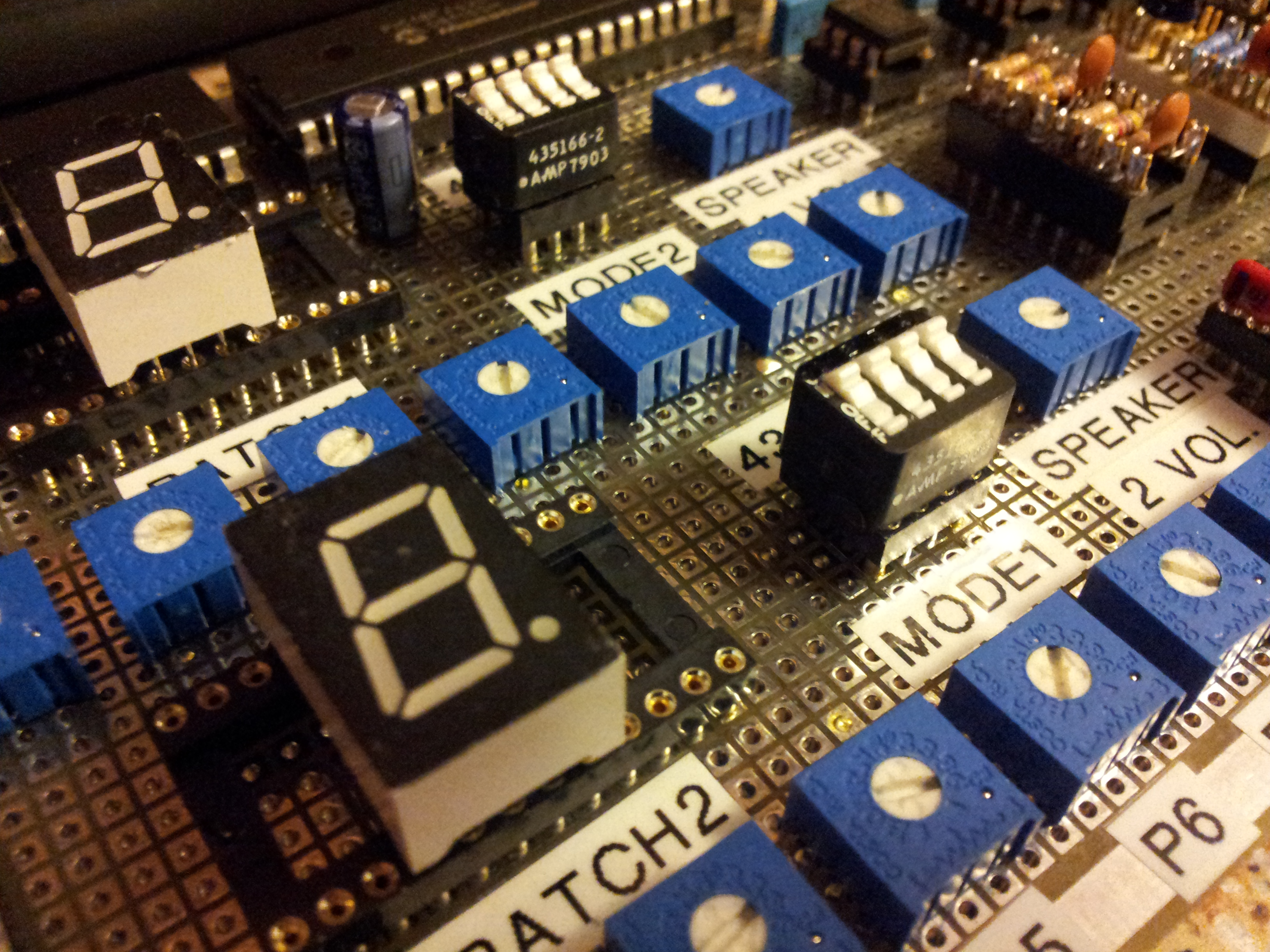

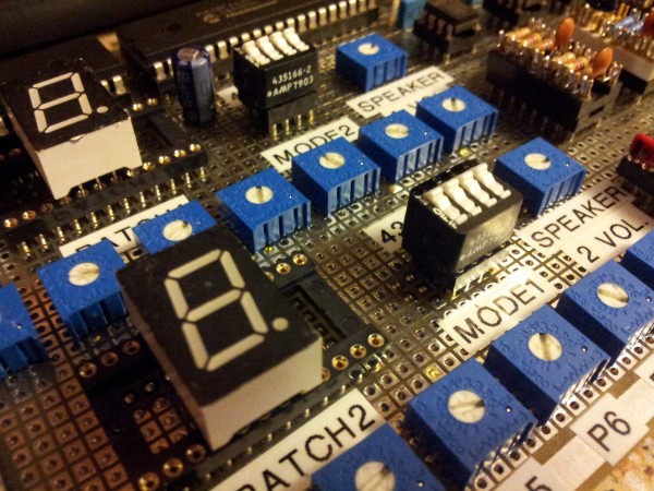

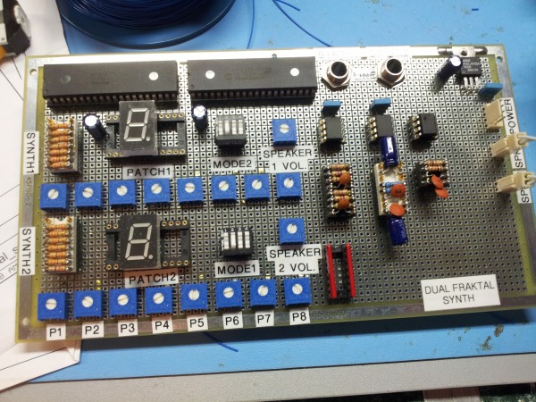

Here are a couple pictures of a dual Fractal Synthesizer on a vector board. The is will used as part of a DIY setup at this years electro-music 2012 electronic music festival. It will be a collaboration entitled "The Soldering Musician and the Personal Digital Assistants". The board contains the original speaker amplifier for stand alone operation when connected to speakers and also has an LM358 based , capacitive coupled, LINE amplifier/buffer to connect to an audio mixer.
The original dual version was on solderless breadboard and did not have the LINE amplifier. It appears earlier in this thread.
I particularly enjoy using the WSG and FM sequencer patches on this synthesizer. It's a fun synthesizer to play around with ! Cool
Next the PT delay chips shall be added.
Its been a LONG while since I revisited this but still have to purchase the CCS compiler to add patches.

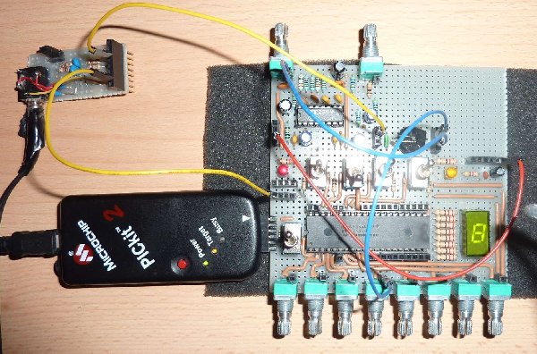

New postPosted: Fri Sep 07, 2012 3:06 pm    Post subject: Reply with quote  Mark this post and the followings unread
Here's a Picture of a fraktal synth I just breadboarded.The sounds are real cool.
 Filesize:  2.02 MB
 Viewed:  3220 Time(s)
Indeed ! Just very small amounts of input on the controls reveals some very unique changes in the sounds produced. You can experiment for hours ! Cool
I find that it's fun to play two of them and move each around in the stereo field.
