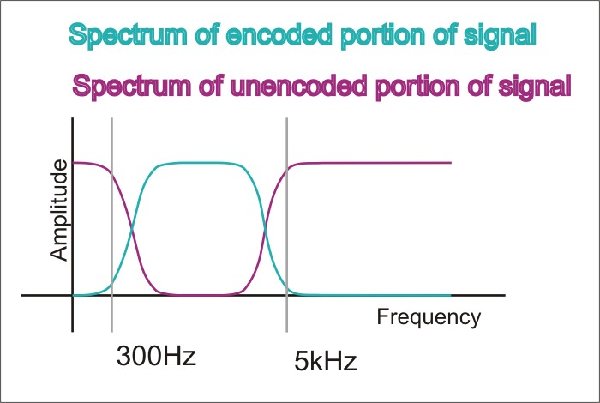

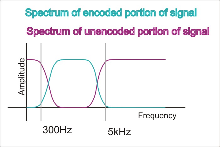

durwood (in another forum) had asked about the role of the filters in the race encoders. They are simple one or two pole HP and LP filters which separate the portion of the spectrum that is to be encoded from that which is not.
