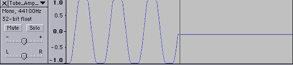

PostPosted: Tue May 06, 2008 8:57 am    Post subject: Reply with quote  Mark this post and the followings unread
OK, it took a lot of finagling around with gains and offsets and such, but I managed to get the model to properly simulate a saturated tube, or so I believe. Looking at the photo below, you see the tube-saturated sinusoid on the left half and the newly beginning zero-amplitude sinusoid on the right half. This waveform is exactly the shape you would expect from an overdriven tube amp, including the rounded corners at the maxima. Listening to the attached audio file will give you a feel for how it sounds. I'm happy with the results - are you?

DrJustice
Joined: Sep 13, 2004
Posts: 2112
Location: Morokulien
PostPosted: Tue May 06, 2008 10:22 am    Post subject: Reply with quote  Mark this post and the followings unread
Best so far in this thread! But, as Jan mentioned a few posts back, it is much easier to evaluate the effect with a phrase played on an instrument. Perhaps continue to use that previous sample as a refererence? If testing for authenticity, then it might even be an idea to use an actual electric guitar sample.

PostPosted: Tue May 06, 2008 8:10 pm    Post subject: Reply with quote  Mark this post and the followings unread
Well, that's the funny thing, you all detected the ringing but it comes from the tube amp model only for some reason. I haven't used a ring modulator and the "clean" signal has no reverb or echo in it, yet you hear something sort of like this in the tube-amped signal. Oops, I forgot to mention that this song uses the above Tube_Warmer_In.mp3 file as its source file, the "clean" guitar.
So now I'm wondering if ringing is caused by tube distortion or if it is this wrap-around effect that occurs. See, the table-lookup gizmo that I'm using is imperfect. If you exceed the table values, it wraps the signal around to the other side of the output rails. So if you put in a value of 1.10, out comes -0.9 for some reason. It puts the "peaks" on the opposite rail. I had to expand the clipping zone to prevent this, and perhaps it needs even more expansion.
Well, I will play around some more and see if I can get a "tube" sound without the ringing somehow. Thanks for checking the thread and adding your comments, they are helpful.

PostPosted: Tue May 13, 2008 4:55 am    Post subject: Reply with quote  Mark this post and the followings unread
Hi folks, just thought I'd leave a quick note to let you know I haven't dropped the tube amp model project. I've been busy doing other things, primarily making a chainmaille guitar strap and visiting with my mom and chatting online.
The ringing sound I believe is due to the coarseness of the lookup table that I'm using. It's based on line-segments, and I just have fewer than 8 or 10 segments defining the entire linear region, which makes angles and doesn't model the soft tails that transition between cutoff, linear, and saturation modes. So after thinking about it for some time, I believe I will customize that table so that there are more entries in the linear region and fewer in the cutoff and saturation regions.
That should reduce the slight ringing that people heard. In addition to that I will scale the whole thing to a wider range so that even more of an effect is produced and we can hear it better. Plus also I buy my guitar in about ten days, so we can run the model with real guitar input pretty soon. I'm *really* looking forward to that!
So, like anything else that's good, we have to be patient and we'll get there soon enough. Thanks to all who've contributed and I'll keep you posted on progress.

PostPosted: Tue May 13, 2008 5:57 am    Post subject: Reply with quote  Mark this post and the followings unread
Hm.... listening again I'm quite certain that there's reverb on the input sample. Either that or something which sounds exactly like it Smile
If using a lookup table, there can never be too many entries - well, it depends on the interpolation method. What order/method of interpolation are you using?

PostPosted: Tue May 13, 2008 6:39 am    Post subject: Reply with quote  Mark this post and the followings unread
H Dr. J, I am using a ChucK feature called a GenX, specifically the Gen7 version of it. You specify a table like this:
Code:
[0.000000,
0.025000, 0.000000,
0.025000, 0.000000,
0.025000, 0.000000,
0.025000, 0.000000,
0.025000, 0.000000,
0.025000, 0.000000,
0.025000, 0.000000,
0.025000, 0.000000,
0.025000, 0.000000,
0.025000, 0.000000,
0.025000, 0.000000,
0.025000, 0.000000,
0.025000, 0.000000,
0.025000, 0.000000,
0.025000, 0.000000,
0.025000, 0.000000,
0.025000, 0.035097,
0.025000, 0.151663,
0.025000, 0.292996,
0.025000, 0.447347,
0.025000, 0.611553,
0.025000, 0.786116,
0.025000, 0.965360,
0.025000, 1.000000,
0.025000, 1.000000,
0.025000, 1.000000,
0.025000, 1.000000,
0.025000, 1.000000,
0.025000, 1.000000,
0.025000, 1.000000,
0.025000, 1.000000,
0.025000, 1.000000,
0.025000, 1.000000,
0.025000, 1.000000,
0.025000, 1.000000,
0.025000, 1.000000,
0.025000, 1.000000,
0.025000, 1.000000,
0.025000, 1.000000] => gen7.coefs;
In fact, that is the actual table from the latest code. Notice that I only have 7 data points, forming 8 line segments to describe the entire linear region. That's not very good. Plus I'm spending lots of computer resources defining duplicate little line segments in the cutoff and saturation regions, duh!
Oh, I forgot to mention: it's linear interpolation, which is also not the best.
But as we said it's a process of learning and improving. So what I plan to do next is add code to the equation solver that makes one big long line segment for the cutoff region and one for the saturation region, plus make little bitty steps in the active region. That should be much better.
You'll also notice that the table varies only from 0 to 1, that is a limitation of Gen7, which was originally intended for mapping HID sensor inputs. That's why I had to do a lot of tricky trial-and-error attempts to get the biasing and gains right. I have to do attenuation and offset on the input side, then gain and reverse offset on the output side. It's still not "just right", as you or someone observed that the output is louder than the input, but I'm getting there.

I also looked at the waveform of the output signal and it sure looks tube-like to me, with soft clipping, though the soft bending occurs in only the upper 5% and lower 5% of the signal. Perhaps a pentode simulation, which is next on the list to do, would be more "bendy" at the extremes, I don't know.
So... success or not? You decide! It seems totally tubular to me, but what do I know, I'm biased. What do you think?
Don't worry, tubes are biased too Smile
What do you think?
As for the exact degree of tubularity, I'll leave that to someone who really knows their references. There's certainly lots of harmonics, but probably also lots of aliasing. It does sound a bit harsh in my ears. Looking at the waveform it may seem like the clipping is somewhat brutal, and an FFT reveals quite a bit of content below the fundamental (at lest the background noises are showing up. I think that at this level of squaring off, band limiting is in order. Of course any kind of non linear function should ideally be oversampled anyway.
One test you could do is to run a slow sine oscillator sweep from 20Hz - 20kHz through the transfer function and listen for artefacts (mainly aliasing).

DrJustice wrote:
Your G and B strings are tuned to G# and C. Maybe it's not tuned yet? Guitar ownership will soon get your tuning habits sharpened anyway Wink
Yes, well, I did a crude, rough and tumble tuning job with a ChucK tuner that I cooked up really quickly by taking the FFT and looking for the first harmonic, but it doesn't work very well at all! An FFT approach is not the best for a tuner, as I have learned. Perhaps I will figure out how tuners work and code that up in ChucK. After spending all I had and then some on the guitar and amp, I just couldn't get a tuner just yet. So I'll ChucK it for now.
Thanks for studying the signals that way, Dr. J! You know, I have some background noise coming from my apartment somehow. It occurred on both amplifiers, the one they sold me which was a Line 6 Spyder III, and the one I exchanged it for, which is a Fender Frontman 15G. There is a tickitty-tick sound that I recorded and attached to this post so y'all could hear it.
The ticking is not as loud as you hear in the recording, I boosted it 12 dB with Audacity, but it is quite noticeable while the guitar is not playing. I have tried shutting off every electric device I have except the refrigerator and the ticking does not subside (computer, arcade game, scope, tv, radio, clocks, printer, cell phone, lights). The Guitar Center expert suggested it could be from a neighbor with a shortwave radio, I don't know. When I unplug the guitar but leave the cable connected to the amp, the ticking gets louder and when I unplug the cable from the amp, the ticking goes away. Also with guitar plugged into amp, when I lower the guitar volume (the Strat has a volume knob), the ticking goes away. Vewwy stwange, mistwer Bugs, vewwy stwange indeed!
DJ
OK, I'll run that test sometime soon. Good Idea!
