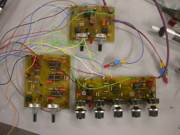

And i got another email from Michael and this gives good hope.
One channel needs three boards: The reason is, that the cymbals have another sound source and the envelope generator is also used in other projects. And: To search a fault is much easier. I like the design with the pots fixing the whole thing to the front panel.
Also the newest version needs three boards: The moog filter on board 1, the envelope and VCA on board 2 and noise generator and LFO on board 3. To be flexible, the RUN generator is also on an extra board.
 Filesize:  211.46 KB
 Viewed:  226 Time(s)

this is good news i am a bit fed up troubleshooting this. last night i spent 3hours trying to minimize LFO bleed through. Mad

The 3 boards is the sds3 circuit with some minor changes.
And yes the moog vcf as oscilator just like the real sds3.
All other atemps to clone the unit basicly died.
