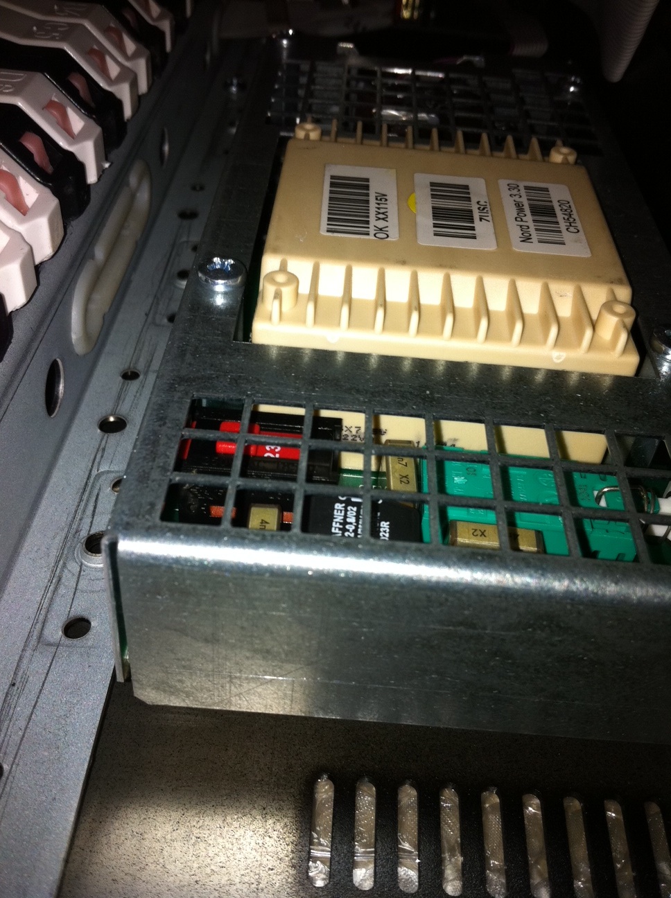

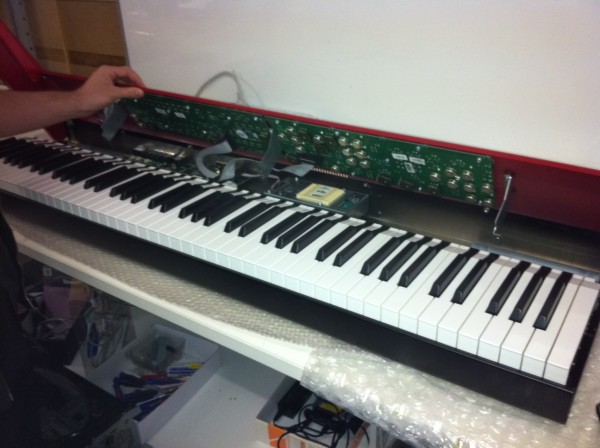

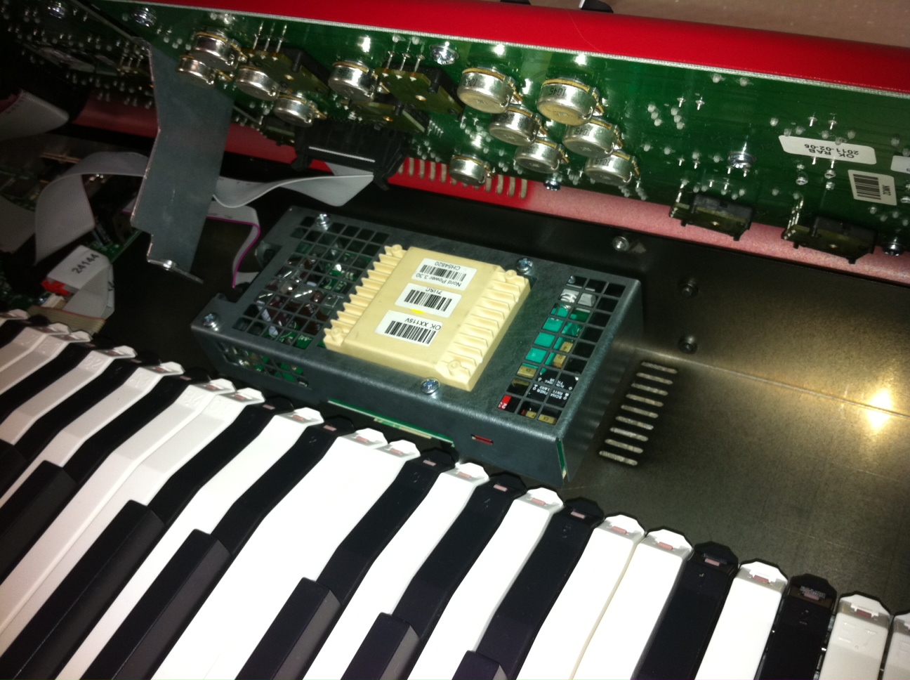

Thanks for this thread! I changed the voltage on my stage 2 yesterday, and they've added a metal cage around the switch. We attempted to remove the cage but it's like they've glued the screws on or something. Anyway, the switch was easily reachable through the cage. I will attempt to attach a picture to show this.
Thanks again for posting all that information. It was so helpful!

It's obvious Clavia build the case to reduce the power supply hum Smile
The switch is the red thing reading 23(0), I assume...
Nice to be at help here.
