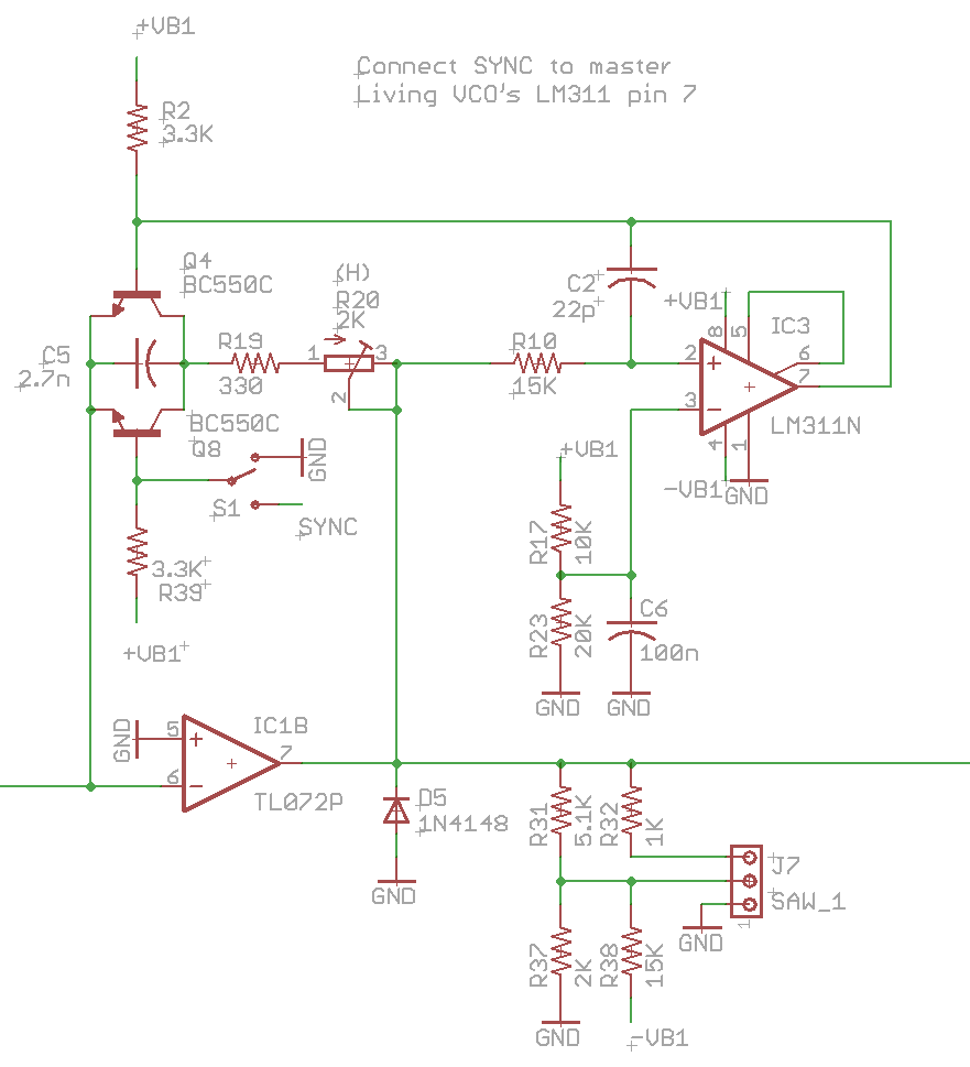

PostPosted: Mon Mar 12, 2012 12:17 am    Post subject: Living VCOs sync Reply with quote  Mark this post and the followings unread
I was playing with two Living VCOs built on a breadboard and tried oscillator sync. It works great and is very easy to implement, see attached screen shots and schematics. However, I decided against including it on the pcb since it seems to increase chances of oscillator lock.
/Peter
Living VCO Sync schematics
 Filesize:  49.48 KB
 Viewed:  1001 Time(s)

PostPosted: Tue Mar 13, 2012 7:03 am    Post subject: Reply with quote  Mark this post and the followings unread
Cool!
I'm assuming the schematic is a part of the Living VCO schematic that you've modified for sync? If so, it's hard to tell what parts of it you altered to make the change (other than the obvious switch).
Would you elaborate, please?
kvitekp
Joined: Feb 24, 2012
Posts: 22
Location: Santa Clara, CA
PostPosted: Tue Mar 13, 2012 7:29 am    Post subject: Reply with quote  Mark this post and the followings unread
No parts were altered, I just added Q8, R39 and S1 to provide additional discharge channel, identical to the existing Q4, R2 one, but connected to sync master VCO comparator output.
/Peter

PostPosted: Sun Jun 03, 2012 10:09 pm    Post subject: Re: Living VCOs sync Reply with quote  Mark this post and the followings unread
Hi Peter! that looks great, is it possible to synchronise that way a J.H living vco to some other brand VCO...?

PostPosted: Mon Jun 04, 2012 6:19 am    Post subject: Reply with quote  Mark this post and the followings unread
I mean with a pulse or a saw from another kind of VCO...

PostPosted: Mon Jun 04, 2012 8:47 am    Post subject: Reply with quote  Mark this post and the followings unread
Yeah, this should be possible, however you will need some sort of signal shaper that would convert saw or pulse from master VCO to a series of very narrow pulses, similar to the ones that are coming out of LM311N comparator. A simple RC differentiator with a clamping diode may be enough, however I did not try it.
/Peter

PostPosted: Mon Jun 04, 2012 8:37 pm    Post subject: Reply with quote  Mark this post and the followings unread
Hi Peter!
I ve tried that :
I needed to amplify a bit the narrow pulses resulting from the differenciator and it worked!
however as far as the frequency from the master VCO was getting higher, the resulting waveform from the slave Living VCO had a more and more poor amplitude (sorry for my english, I mean : master VCO more and more Hertz => slave Living VCO less and less Volts or db )

PostPosted: Mon Jun 04, 2012 9:29 pm    Post subject: Reply with quote  Mark this post and the followings unread
Hi Saint Gillis,
Glad it worked! Amplitude degradation when master osc frequency increases is expected since ramp speed of the slave osc does not change so if you discharge it earlier it has less time to increase hence it reaches lower amplitude.
/Peter

PostPosted: Tue Jun 05, 2012 6:49 am    Post subject: Reply with quote  Mark this post and the followings unread
Alright, so if I understand well I have to tune the slave Living VCO just a bit lower than the Master VCO...?

PostPosted: Tue Jun 05, 2012 8:28 am    Post subject: Reply with quote  Mark this post and the followings unread
Hi Peter, I ve checked all that, it works really great ! Just need to amplify the output of the RC differenciator to about 10V; that way the master drives the living VCO perfectly, so I ll try to add a little aop in the circuit and maybe it will be ok, thanx Peter all that sounds very good! Very Happy

PostPosted: Tue Jun 05, 2012 8:58 am    Post subject: Reply with quote  Mark this post and the followings unread
Although it is doable with a simple transistor switch, you may also want to try adding another LM311N comparator circuit, similar to the one in the core osc. This way it would be identical to how JH decided to drive cap discharge switch, which may have some additional benefits that we don't necessarily understand.
/Peter

PostPosted: Tue Jun 05, 2012 12:25 pm    Post subject: Reply with quote  Mark this post and the followings unread
Hi Peter, excuse my poor level of knowledge.. would it be something like that?

PostPosted: Tue Jun 05, 2012 12:34 pm    Post subject: Reply with quote  Mark this post and the followings unread
Yeah, something like this... i'm not sure why you need that extra transistor if you use comparator though.
/Peter

PostPosted: Wed Jun 06, 2012 12:42 pm    Post subject: Reply with quote  Mark this post and the followings unread
Hello Peter! I ve tried it but nothing comes out from the lm311...

PostPosted: Wed Jun 06, 2012 1:38 pm    Post subject: Reply with quote  Mark this post and the followings unread
You may need to tweak R21/R22 to set the desired comparator threshold level: check the shape of the signal comping out of differentiator and choose R21/R22 voltage divider accordingly. You may also need to reverse clamping diode to ensure proper polarity of comparator output signal.
/Peter

PostPosted: Wed Jun 06, 2012 7:46 pm    Post subject: Reply with quote  Mark this post and the followings unread
Hello Peter its me again Smile
Yes of course the diode direction was a mistake in my drawing...
Ok it looks like I have a beautiful synchro... here are the best value to get the cleanest waveforms

PostPosted: Wed Jun 06, 2012 9:30 pm    Post subject: Reply with quote  Mark this post and the followings unread
Congratulations! It's always pleasure to modify JH's designs -- everything works as expected with just a little tweaking.
