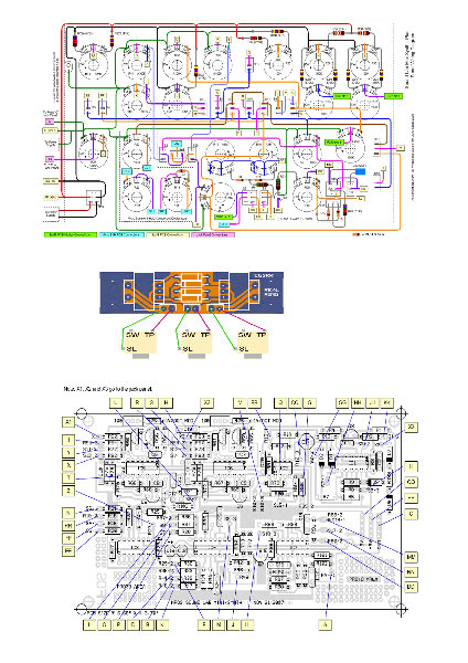

Hi guys , please I need some help.
I bougth a CGS-RRR and I would like to put inside my SL Minisynth, the problem is I don´t know how connect them together.
Please mates, somebody can help?
Apologize for my poor skills of English.
Regards from Spain.
 Filesize:  2.96 MB
 Viewed:  433 Time(s)

The Real Ring Mod is a passive, standalone module. It doesn't need to be connected to the soundlab pcb to function. What i would do, is make a place for it in your Soundlab enclosure, and wire its inputs and outputs to the panel, and simply run your soundlab's output into it, for ring-modulated effects.
