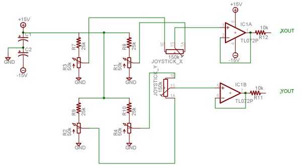

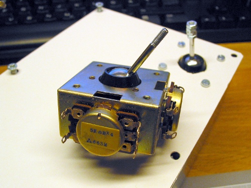

I built a joystick controller module using one of those and this circuit.
I have no idea who to credit for the schematic...sorry.
The joystick is tough to panel mount, is a bit small, not very precise and does not return to zero very well.

Thanks for that circuit RF! I recently got two of these of Ebay and this is just what I have been looking for!
