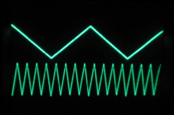

PostPosted: Wed Mar 25, 2009 9:51 pm    Post subject: Reply with quote  Mark this post and the followings unread
I've seen it, and it looks very clean! Very Happy

PostPosted: Wed Mar 25, 2009 9:57 pm    Post subject: Reply with quote  Mark this post and the followings unread
Symmetry is excellent, because the circuit basically just flips the phase of the input wave at the right moment - don't have a scope shot of the sawtooth, but the top triangle in this scope shot is the triangle from the circuit (the higher frequency on the bottom is from a different circuit I'm working with - that signal is two octaves higher than the input - these two signals signals are simultaneous). Sawtooth is just as good.

PostPosted: Wed Mar 25, 2009 10:14 pm    Post subject: Reply with quote  Mark this post and the followings unread
Dang - you're fast Andy. Very Happy
I used the CD40106 in this circuit because the main concern with this method is the connection points at the splice. The splice on the triangle is at the peak; splice at the sawtooth is mid-slope. Results using just an op amp comparator alone, even with hysteresis, were unsatisfactory. Biasing the CMOS from the minus supply made it handy for controlling the FETs.
You can see the merest wisp of thin transients at the splice points; filtering can eliminate them, but I didn't bother - I can't hear them, regardless of the frequency.

PostPosted: Thu Mar 26, 2009 12:07 am    Post subject: Reply with quote  Mark this post and the followings unread
P'dang! That's a clean looking triangle. Have you tried to use the other half of the 4013 to knock it down another sub octave? Using another op-amp for a TH sine shaper could be a good idear.

PostPosted: Thu Mar 26, 2009 8:20 pm    Post subject: Reply with quote  Mark this post and the followings unread
Hey Synthmonger,
Here's a scope shot of the sawtooth. Top is the sub-octave, bottom is the input waveform.
Cheerios,
Scott

PostPosted: Fri Mar 27, 2009 12:37 am    Post subject: Reply with quote  Mark this post and the followings unread
Thanks Scott! That is a pretty slick and clean sub saw.
Are the MP102s acting as VCVR's to keep the saw in correct phase?
What vco are you using?

i cant wait for the rest of the circuits...very intrigued by your idea of imposing drift, and also your Other waveforms you speak of
Can you possibly explain more on how this works?
i see that the waveform comes in, gets squared and feeds a 4013...i see the u1 is wired up as a differential (?) amp but i dont know much about those...ahh hell...even the idea of a voltage controlled inverter is amazing.
soon to the breadboard!
there are so many ideas!!

Hi Scott --
thumleft That's a very clever circuit.
Have you thought any about including dynamic mixing? Say a 3-input MXR/VCA for each octave (to mix a combination of the three waveforms and VCA the sum)?
When I say embiggenment, BTW, that means I've employed techniques to make the outputs sound as if they're not locked to the same frequency - I impose a bit of drift, which embiggens the sound.
So this would be like the sawtooth phase-shift animator?

Here's one with the four lowest octaves set to PWM and the top octave is a triangle. It's some rather in-your-face PWM, driven by a klunky Klee sequence.
