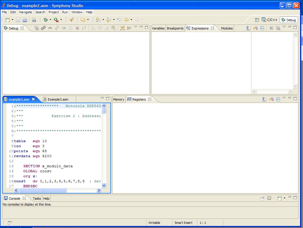

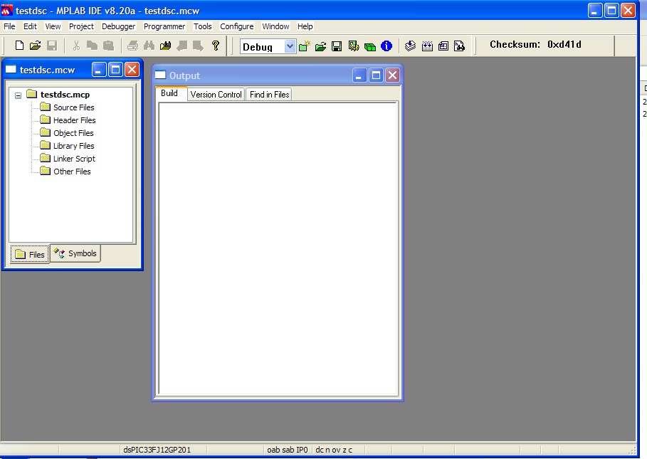

PostPosted: Sun Mar 29, 2009 10:23 am    Post subject: Reply with quote  Mark this post and the followings unread
Hi Les,
No Problems.
I re-installed the IDE and DSC compiler and its really weird it looks totally different to the first time I installed it. This of course if probably something to do with me, I have a bit of a fever!
Which image does yours look like?
Andy

Joined: Oct 13, 2007
Posts: 6221
Audio files: 267
PostPosted: Sun Mar 29, 2009 10:58 am    Post subject: Reply with quote  Mark this post and the followings unread
Mine looks like the first image, in blue, but I saw the second image on one of the C pages. I think the link I gave you was inside the hierarchy of Microchip web pages, not the main page of the C compiler. The main page shows a tan colored setup like the second image. Perhaps if we read on the website we can figure this out.

PostPosted: Sun Mar 29, 2009 11:22 am    Post subject: Reply with quote  Mark this post and the followings unread
Well they are two totally different IDEs, it is very strange I think I may be going a little mad!
Mine looks like the first one and I am going with that!
I have you example built and simulated, had to change the include stuff as follows:
#include "p33FJ12GP201.h"
#include "timer.h"
#include "outcompare.h"
#include "ports.h"
And set the include path. I don't quite know why we have a difference here.
I am looking at the docs at the moment to work out how to simulate input and output at the moment.
