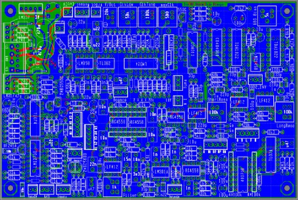

PostPosted: Mon Aug 03, 2009 6:40 am    Post subject: Reply with quote  Mark this post and the followings unread
UPDATE
Feature List:
Two BBDs - can choose long/short delay for left/right channel independently.
Long Resonance loop or short resonance loop
1/x modulation for "natural" Flanging
1V/Oct input (temperature compensated) for Physical Modelling
Approximating Thru Zero Flanging with All Pass Filters in the direct path and "rectified 1/x" sweep
ARP-Quadra-style compander and germanium diode clipping for ultra-smooth high-resonance sound
"Bounce"
4 Built-in Modulation sources:
Triangle Wave
Expo-slew'ed Square Wave
Sample & Hold Random Steps
Envelope Follower
Voltage controlled Modulation Rate
Built-in power supply (only need AC wallwart) or MOTM +/-15V supply
Requires two TDA1022 chips!
JH.

PostPosted: Wed Aug 19, 2009 1:30 pm    Post subject: Reply with quote  Mark this post and the followings unread
Prototype board populated - got the first sounds out of it - sounds very promising so far. As far as I can tell with alligator clips and all.
Too soon for real audio demos, but I'll keep working on it, slowly, as the baby allows ...
Keep up your interest, spread the information: a JH Flanger is definitely coming, if there is enough demand for a PCB run, and enough TDA1022's out there.
JH.

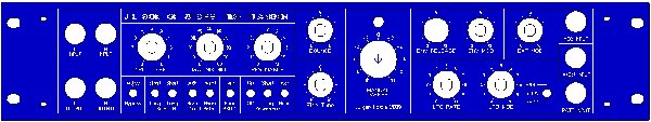

PostPosted: Fri Aug 21, 2009 3:29 am    Post subject: Front Panel Preview Reply with quote  Mark this post and the followings unread
That's what I'll put my prototype behind ...
JH.

PostPosted: Fri Aug 21, 2009 5:22 am    Post subject: Reply with quote  Mark this post and the followings unread
looks very complete Shocked
hmm wander how i gonna crop that into a 5u panel

PostPosted: Fri Aug 21, 2009 5:56 am    Post subject: Reply with quote  Mark this post and the followings unread
I won't, but I'm sure somebody will! Laughing
You can either make a very wide 5U panel, or omit the modulation stuff.
JH.

PostPosted: Fri Aug 21, 2009 7:02 am    Post subject: Reply with quote  Mark this post and the followings unread
myes,depending on the potvalues,i will probably need to use concentric pots.
as soon as you have a wiring diagram plz post it juergen,can start the layout check for my panels

PostPosted: Fri Aug 21, 2009 9:01 am    Post subject: Reply with quote  Mark this post and the followings unread
LOL, I haven't even wired it myself, yet!
