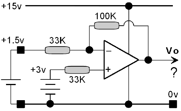

Tony Deff
Joined: May 25, 2008
Posts: 51
Location: Suffolk, UK
PostPosted: Wed May 06, 2009 11:13 am    Post subject: Op-amp bias
Subject description: When pin 3 doesn't necessarily connect to Ground
If you are confident you know the output voltage of the following arrangement ( Twisted Evil cough cough, assuming it is wired-up correctly!), then there is no point in downloading the following PDF attachment.
This is actually a filter — it filters-out those who know their op-amps!!
 Filesize:  10.66 KB
 Viewed:  243 Time(s)
Universal Op-Amp Bias.pdf
Universal formula for op-amp output, which can include a DC bias at the + input.
 Filename:  Universal Op-Amp Bias.pdf
 Filesize:  137.23 KB
 Downloaded:  220 Time(s)
JovianPyx
Joined: Nov 20, 2007
Posts: 1988
Audio files: 224
PostPosted: Wed May 06, 2009 12:46 pm    Post subject: Reply with quote  Mark this post and the followings unread
Cool That looks like a homework question for an electronics class... Cool

gddfp
Joined: Jan 11, 2009
Posts: 21
Location: Belgium
PostPosted: Wed May 06, 2009 2:26 pm    Post subject: Re: Op-amp bias
Pretty clear to me: 42 !
(I've always felt that there was something fundamentally wrong with the Universe)
