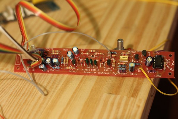

Hello, I could use some help trouble shooting a Steiner VCF.
There's no output.
Power is reaching the board.
The wiring is correct.
Polarity of capacitors and diodes are correct.
Diodes test ok.
TL071 switched out, no change.

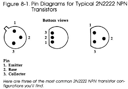

After a bit of testing I realized the 2N2222's I had were in backwards.
I have the middle ones in the attached chart. For some reason the emitter is on the other side for this type.
After switching them around they test ok,. still no output.
At this point I'm not sure what I have left to test.
Any ideas/help/direction would be appreciated.
I've attached a close-up of the board.
Thanks.
EDIT* I can hear the filter working when I turn the psu on and off, it's not loud. Also, I can hear the input signal bleeding through really quietly while it's on.

ok,. I found that bypassing that last resistor makes it a lot louder, about signal level.
Now it seems to be working ok except for the resonance pot.
When I turn it down, it attenuates the signal as well.
Also, it doesn't approach self-oscillation when turned up.
Is that how it's supposed to work?

assuming you have PN2907 for the PNP transistor, it looks like it may be in backwards.
PN2907 datasheet
hope it is as simple as that. this filter is the best!

Thanks guys.
I tried switching the 2n2907 around and that made it sound really crazy so I changed it back. Weird.
But it's working great now,. the 2k2 resistor in the resonance section just needed some adjusting. I ended up putting a 1k pot with a 1k resistor in it's place so now I can get really wild overdriven resonance if I want.
And with all that resonance there's a lot more signal so I put the output connection back to normal.
This ended up being really fun and made me want to fine tune the other modules I'm working on.

That sounds like the diode chain is being reverse biased. Are you sure you are driving the correct base with the CV?

I think I have it right, but it is the kind of mistake that I might make... Wink
Many thanks for the suggestion!

Okay, I still have all my hair but I am developing a pronounced facial twitch thanks to this build.
You're right, the diode chain IS reverse biased. This is because the collector voltage of - let's call it Q1, as in the original Nyle Steiner circuit - is permanently stuck at 8V, and I can't figure out why. The transistor is good; the base voltage varies with the frequency pot from -10 to +40 mV; but the collector voltage doesn't budge. Meanwhile, Q2's collector merrily scans from 4.5V to just over 8V, never quite reaching a high enough value to forward bias the diode chain. And I can't see why.
Yes, I've checked all component values. I can't find any shorts or breaks or miswirings on the build. And I can't see how the collector voltage of Q1 can remain static as the transistor is turned on and off at the base. It's back to the breadboard on this one.
[BTW: the gains of the BC547A transistors I used for Q1 and Q2 are about 190, not 250 as I stated earlier.]

I take it from your comment that you have compared the circuit to the original diagram in Nyle's article too.
What are you doing for the CV? Do you have the initial frequency pot there? Have you tried reducing the value or the resistor in series with it? Is it between the +VE and 0V , not -VE and 0V?

The CV input is as per your v1.2 - two inputs, each via a 220k resistor, one fed from a 100k pot between +12V and earth. 1k resistor and 1uF capacitor to earth. Capacitor is correctly orientated.
Thanks for your quick response!

Just swapped the 220k resistor for the 47k used in Nyle Steiner's original circuit, and also took the 1uF smoothing capacitor out of circuit. Both Q1 and Q2's collector voltage ranges increased slightly and the overall result is the same - no filtering yet...
Sad
Can you confirm that Q1's collector voltage should vary over several volts with adjustment of the CV?

Left TR is the one with its base connected to the CV
Voltages given are the collector voltages
CV Left tr Right tr
0V 5.8V 4.7V
4.3V 4.4V 6.0V
15V 3.0V 7.5V
So yes, the left collector voltage does vary with changes in CV, and the two collector voltages move in the opposite directions to each other.

Well, there's my problem - right transistor is behaving, left transistor ain't. It's GOT to be something trivial, but I just can't find it. Mind you, this has been one of my "stupid" weekends, where everything has been - what was that marvellous phrase from Scott Stites? - oh yeah, "a great batch of loser cakes drenched in fail sauce."
Back to the veroboard tomorrow, if I can swallow those cakes. Confused
