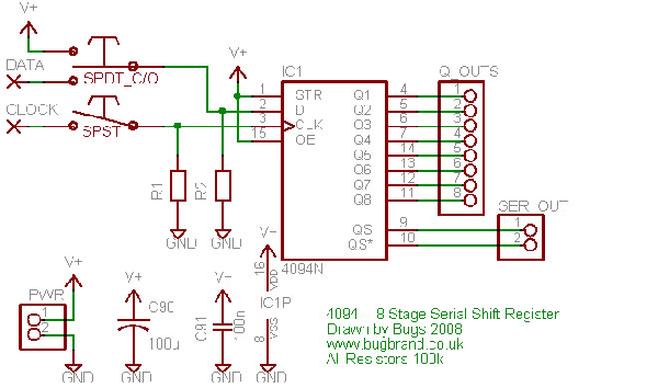

Here's my basic understanding of a Lunetta.
The concepts laid out initially on this board by mosc were extensions of what he and others were doing as inspired by Stanley Lunetta.
Logic chips with the I/O's taken to front panel patch points. Maybe some diodes or resistors on the I/O's for protection. Some variable clocks, some way to interface with an amplifer (mixers).
I think many of the schematics you see drawn out on this board are extensions beyond that initial understanding, just because the basics are so very simple - they don't really need a drawing.
I'll try to post a drawing or two Tom Bugs did for us over a year ago.
The Shift register typifies what most of the circuits on my machines are.
Just the basic chips and a little protection.
Have fun!

As for the shift register, I'm not really sure what that's all about but I've seen it mentioned much on here. Time to go look for some data sheets.
