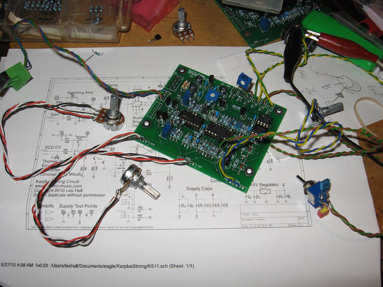

kkissinger wrote:
It turns out that Q2 is reversed on the schematic -- the collector should connect to GND and he emitter should connect to R27.
Whoa, nice find! And yet, it still works (barely?) So that means Q4 is also reversed, right?
frijitz
Joined: May 04, 2007
Posts: 1734
Location: NM USA
Audio files: 54
PostPosted: Fri Oct 01, 2010 1:25 am    Post subject: Re: A breakthrough! Reply with quote  Mark this post and the followings unread
Yes.

PostPosted: Sat Oct 30, 2010 9:33 am    Post subject: Reply with quote  Mark this post and the followings unread
seems like i was quite lucky being so slow Smile as i would never have found any of these issues by myself.
now i'm populating 2 KS boards. i've turned around the 3906s (the 3906/3904 pairs look like DD seen from above) and took the 27K value for R27 and R32 (i will use a +/-15V supply)
are other 'weird' values very critical or can i also take closeby values, for example:
2K (not the tempco) could i use 2K2 instead?
40.2k -> 39k ?
49.9k -> 47k ?
i guess i could use 4x 500R trimpots for the 100R guys, just because i have them here. or could i damage something here?
also i have already used a 20p cap for the specified 18p.... (hope thats ok)
i also have a bunch carbon 100k's lying around but no more 1% metal type... would they work instead or should i wait until i can order new stuff?
(i have to wait for BBD chips and some caps anyways)
thanks!!

Well, I've got my K/S module working pretty good on +15/-15v.
Here are some of the tweeks that I made:
1) Changed R27 and R32 to 3.9K ohms.
2) Changed R26 and R31 to 10K ohms.
The low-end volts/8ve tracking is ok (not perfect yet) but the top two octaves don't track so well.
However, if I can find a 256 step BBD to raise the range by two octaves, I think this may work better for me -- right now the bass runs clear into the contra-contra bass range! Smile

PostPosted: Mon Dec 27, 2010 10:46 pm    Post subject: Ah... tracking nicely through 5 1/2 octaves now! Reply with quote  Mark this post and the followings unread
Well, I just can't put this project away for too long until I'm back with it again!
I discovered that as I rotate R39 (the filter frequency) to the left of the 12 o'clock position or to the right of the 4 o'clock position that the VCO tracking changes. However, I'm not likely to use such low filter settings -- the range from 12 o'clock to 4 o'clock happens to be the most useful.
The good news is that I've achieved excellent tracking across 5 1/2 octaves -- from 8 hz (64' C) to G above middle C (392 hz) Above 392 hz, there is an additional octave however tracks at less than a semitone per 1/12 of a volt.
I am using the vintage 256 stage BBD device.
This is a very musically useful range and the deep bass sounds rather metallic and (dare I say) digital.
In order to tweak the volt/8ve tracking, I added a multi-turn trimmer in series with R19. I used a 50K trimmer however it may be a little easier to adjust with a smaller value.
The only possible improvement will be to replace the transistor pair with a matched complimentary pair -- however this part is surface mount and I have to build an adapter board in order to implement. Who knows... I might get that top octave to track, too!
I've had some time just playing it -- very nice module for both plucked string sounds and that kind of airy Andes flute sound. And the bass sounds are really cool. I will give this module a good workout during my set on the New Year's streaming broadcast. Smile

been working on 1 of 2 KS boards...
Checked pcb with a multi-meter and Q2 is correct to the schematic , but when powered up, the pitch pot exhibited a fall in pitch then a spike, then normal rise to high pitch (turning a low to high sweep).
Turning Q2 around (emitter to ground / collector to R27) fixes it and now has a nice low to high sweep.
i turned round the vcf Q4 but have now lost a bit of character with the feedback , will try something later Smile.
im using 2N3904 / 3906 with 2K tempco on vco section only.
i liked Woody's mod with a cap change for the vcf C7 , im trying out a dp/dt/center off switch for 2N2 center , +3N3 or +1N5.
going to try another cap for the vco , i only had a 22pf not an 18pf like on the schematic ,
sounding very interesting so far , good twangy bass sounds with a 3209 and triggering with a slow pulse train.
also at high frequency trigger in it produces some great metallic phasey drifts Smile
off to try a fine tune control pot for the vco , 2 of these together will be evil Very Happy Very Happy Very Happy
 Filesize:  195.26 KB
 Viewed:  224 Time(s)

kick butt dave! I love to see the mods. Let's put all this into the design to make it extra cool.
I know I gave this design to em, but am I gonna have to do the final edits on the schematic? I'm cool with that. Just let me know what to change.
