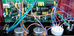

Hi, I'm just about done building the Bi'n'tic with the Bridechamber board and I need to know how to wire the dual 100k pot for the bandwidth.
I've managed to figure out how to wire everything else from looking at the pictures and comparing them to the CGS build page but this one is eluding me. It's a shame there's no diagram or instruction for the wiring.
Has anyone else built one of these that can lend a hand?
Thanks.

Hi
i don't know if the Bridechamber board is different to the CGS one, but does this pic help?

It may be different,. I really can't tell.
In this picture it looks like the wires are blue-green-blue-green from the board and the blues hook up to the left side of the pot?

PostPosted: Mon Aug 17, 2009 5:32 pm    Post subject: Reply with quote  Mark this post and the followings unread
yep, now I pull my finger out and look at the pics, the Bridechamber has a few mods and different layout.
Assuming the markings are similar to the original CGS PCB, the holes connected together with the white lines go to the same pot.
so on the Bridechamber PCB, it looks like left pin (pot 1), centre pin (pot 1), left pin (pot 2),centre pin (pot 2).
Whereas on the CGS PCB in the pic above it goes: left pin (pot 1), left pin (pot 2), centre pin (pot 1), centre pin (pot 2).
....maybe? Wink

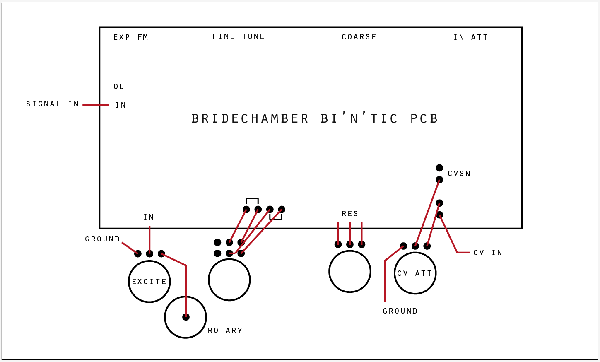

PostPosted: Sat Aug 22, 2009 3:31 pm    Post subject: Reply with quote  Mark this post and the followings unread
Here's the way I ended up doing the wiring in case anyone needs it..

PostPosted: Sun Sep 06, 2009 11:36 am    Post subject: Reply with quote  Mark this post and the followings unread
I forgot, for 1v/oct add a 100k resistor in series with the CV attenuator output.

PostPosted: Tue Sep 15, 2009 1:07 am    Post subject: Reply with quote  Mark this post and the followings unread
Thanks! This helps a lot. I'm currently in this build and was scratching my head over this. I take it your not using a Bridechamber panel with that CV attenuator?
