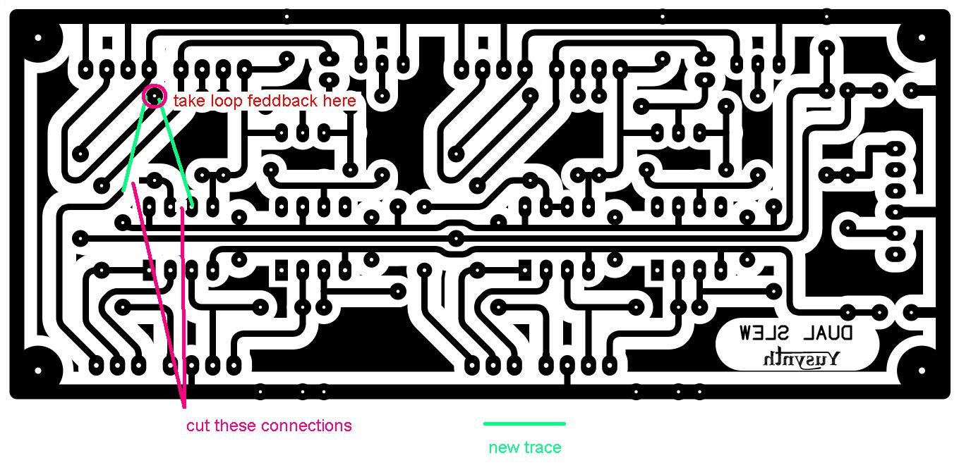

PostPosted: Thu Oct 29, 2009 4:24 am    Post subject: Reply with quote  Mark this post and the followings unread
numbertalk wrote:
IThe reason for this is touched upon in this thread:
http://www.electro-music.com/forum/topic-32384.html&postorder=asc
I was reading this thread and is very interesting, the conclusion was that if you take the feedback loop after the protection resistor shouldn't be voltage drop. So maybe here, the solution could be cut the trace that conect the 6-7 pin of the TL072 and connect the 6 pin after the 470ohm resistor.
What do you think?
What do you think?
Yes inserting the protection resistor before the feedback loop does limitate the voltage drop.
Yves

PostPosted: Thu Oct 29, 2009 10:41 am    Post subject: Reply with quote  Mark this post and the followings unread
Hello again.
I have very good news . I've made the modification on my Slew limiter and works very very well.
Now with the same configuration that I have in the beginning I don't have problem at all.
The voltage output of the slew limiter with 1V on the input is 999mV and after connect it to the multiples ( with 2 VCO and to the 1V/oct filter ) I have 1001 mV , where I had before the mod 980mV
Anyway I will try to build an active multiples but at least this problem is solved
