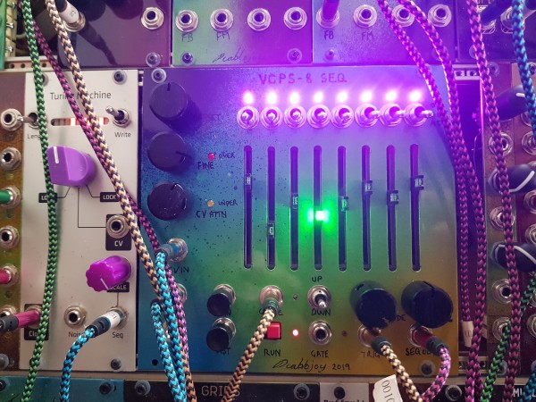

PostPosted: Fri Apr 26, 2019 11:44 pm    Post subject: Reply with quote  Mark this post and the followings unread
Recently did a euro build of this
came out ok still working out a bug or two though Laughing
aged a gated slew and a run /stop button
(first time I did a self etch double sided board for the panel controls only)
still have to do a second one.
[/img]

PostPosted: Sat Apr 27, 2019 12:35 am    Post subject: Reply with quote  Mark this post and the followings unread
wow! that looks great. and see a build after all these years!
i am working on a MK2 from time to time. it has a s/h for the CV output and the pattern could be loaded by an external pulse (latch for the ADC). the first eurorack prototype had some errors, the 4U version worked out well, though.
the eurorack MK2 has slider jsut like yours, the 4U come in two versions, one with CV, another just with gate outputs:
