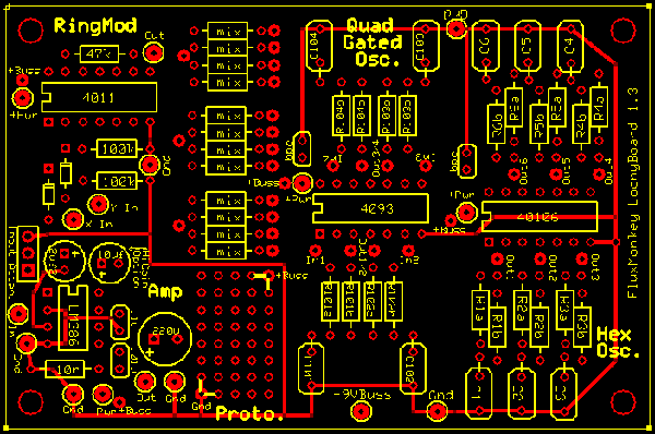

I'm working on a series of CMOS/Lunetta-ish building block PCBs, which i'm hoping to offer for sale shortly. here's a preview of the first one: 6 oscillators based on a 40106; 4 more gated oscillators on a 4093; a digital ringmod on a 4011, and an LM386 audio amp... plus some utility mixer arrays and a prototyping area.
anyone interested?

Have you tried using a 4070 or 4030 instead of the 4011 for "ring modulation"? I tend to like the sound of those chips more.

& with 10 Osc.s it would make alot more sense (to me at least) to use a Quad XOR chip... 4 "ring mods" hell yes!!
The only other thing that occurs to me is the Amp / Proto section; the proto area is a little small, it would only just fit another 14/16 pin DIP right?
I think it would be neat to make the 386 amp a seperate board & expand the proto section into a nice big space for adding 1 or even 2 more ICs.
That way the amp board could have some extra bells & whistles as well, maybe a 385 for an active mixer; with summing node(s) to link into the mix sections.
Either way, its a cool idea & I'd grab a few; would make putting together little noise makers for friends alot easier, everytime I show off my lunetta / weevil I always get a request or 2.

I'm not really all that keen on the lm386 myself. Seems like every time I try to use on my regulators start getting really hot. It also just does not sound good, not very useful unless you absolutely need to drive a small speaker.
i haven't... but looking quickly via google, it looks like all 3 of those have the same pinouts, so they should be interchangable?
edit: just tried both of these out, and all 3 chips seemed to work fine... i did not hear much difference myself, but i was listening thru the cruddy 386 amp... Laughing
the main reason for including it, as you say, is to drive a small speaker... in the workshops i've been doing, folks need to hear what they're building. but you're right, it's not that great sounding... but maybe good enuf for noize music?
the 386 also draws a lot of power, and you just skip it... but the way i have this laid out, you can link any or all of the sub-modules to a common power buss, or power any of them separately. so you could have 2 batteries, one for the 386 and another for everything else. or, you could add a power-starve option to either of the osc chips. or, you could power one oscillator with the output of one of the others. my goal was to balance flexibility and convenience...
also as mentioned, this is intended as the first in a series. obviously, this is a "voice" board; also have a sequency board and a modifier board sketched out. would welcome input or suggestions as to what you'd like to see...

ezikiel, I have more of those little eChucK Lunetta breakout boards if you want to get started with those. The thing is, the value price point for any of these little boards is like $200 or more each. So if we made these designs it would take thousands and thousands of dollars to do it and we'd have to have 50 customers to make any money.
In contrast, a general purpose board can be used for anything. That's why I was so excited about the eChucK Lunetta breakout boards - it's just one design so you can build what you want.
I'm thinking of making the next batch of boards a little bit bigger to accommodate more potential designs. I'm open to suggestions there.
For the Lunetta board described here, how is the interconnect done between the different modules? Is it hard wired or configurable?
I think there is room in the Lunetta world for some Lunetta noisemakers like this board as well as the little breakout boards. They serve different purposes. I'd be interested in developing a simple noisemaker board if anyone wants me to do such a thing. What would you like me to put on it?
configurable... all 10 oscillator outputs are available separately, no hardwired connections between any of the oscillators, ringmod, or amp. right now, i have one of the prototypes wired so the 40106 is doing a sort of angry bee swarm sound while the 4093 is doing a rhythmic click track both straight and into the ringmod.... the other prototype has a powerstarve pot on the 40106 configured with low-mid audio range caps and photocels... one of which is a VLFO feeding power to the 4093 via a big electrolytic... sickness.
unlike the complete blank slate of the echuck board, these layouts will provide building blocks of some standard configurations, like oscillators or sequencers... hopefully making it easier for folks to build composite collections of circuits into flexible instruments, without locking 'em into a single design.

1) Try to move the designators (silkscreen legends with things like R10, C4, etc.) so that they are still visible when the component is in place. It takes a little extra room, but it makes assembly and troubleshooting a lot easier.
2) Maybe outline the separate sections of the board with a line on the silkscreen layer. This is just a graphical aid to show people where the separate sections are.
Neither of these is critical, but they might be nice graphical aids for your users. Just a thought. Smile
