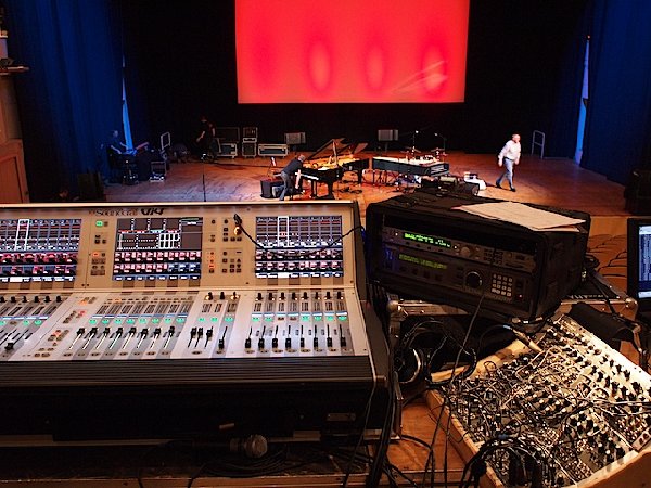

Digital and Analog - They do get well together :-)
 Filesize:  185.96 KB
 Viewed:  1044 Time(s)
