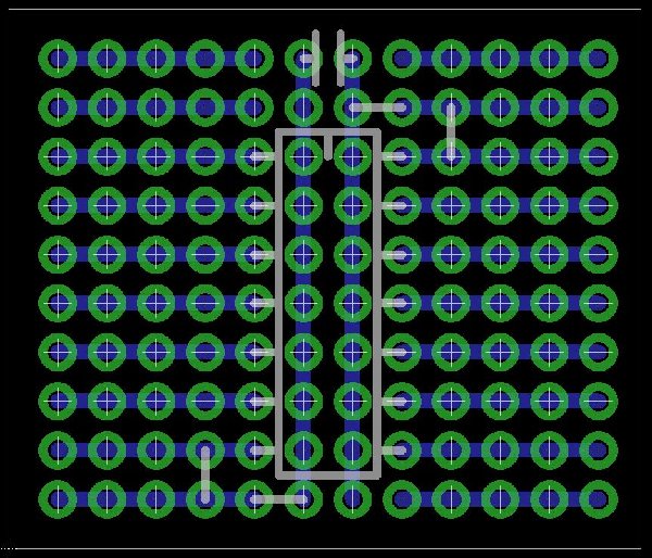

Mahte, below is a layout on the eChucK Lunetta breakout board design for a 14 pin IC and power supply cap. You can make similar drawings with the design files in EAGLE CAD.
The reason I say that I'd like to make the boards a bit bigger is because this design doesn't really work for a 16 pin IC. We need one more row to do it right. That is, unless someone can come up with a more compact layout.
Your comments about the hole sizes ring true with me, they are big holes but you know what? Big holes are good. I might go just one size smaller and that's it.
Ah, you have the center busses assigned to + an ground. I have both to ground. The board suits 16pin CMOS just fine.
The + buss is seldom used, if so, for manual clock, inhibit/engage, reset, or other "shoot a high into some point" function. You need more ground busses, not so much + bus.
Here's my setup: Red= + bus, White (and Green jumpers) are ground, Blue are header connector for battery, also Green is bypass capacitor.
