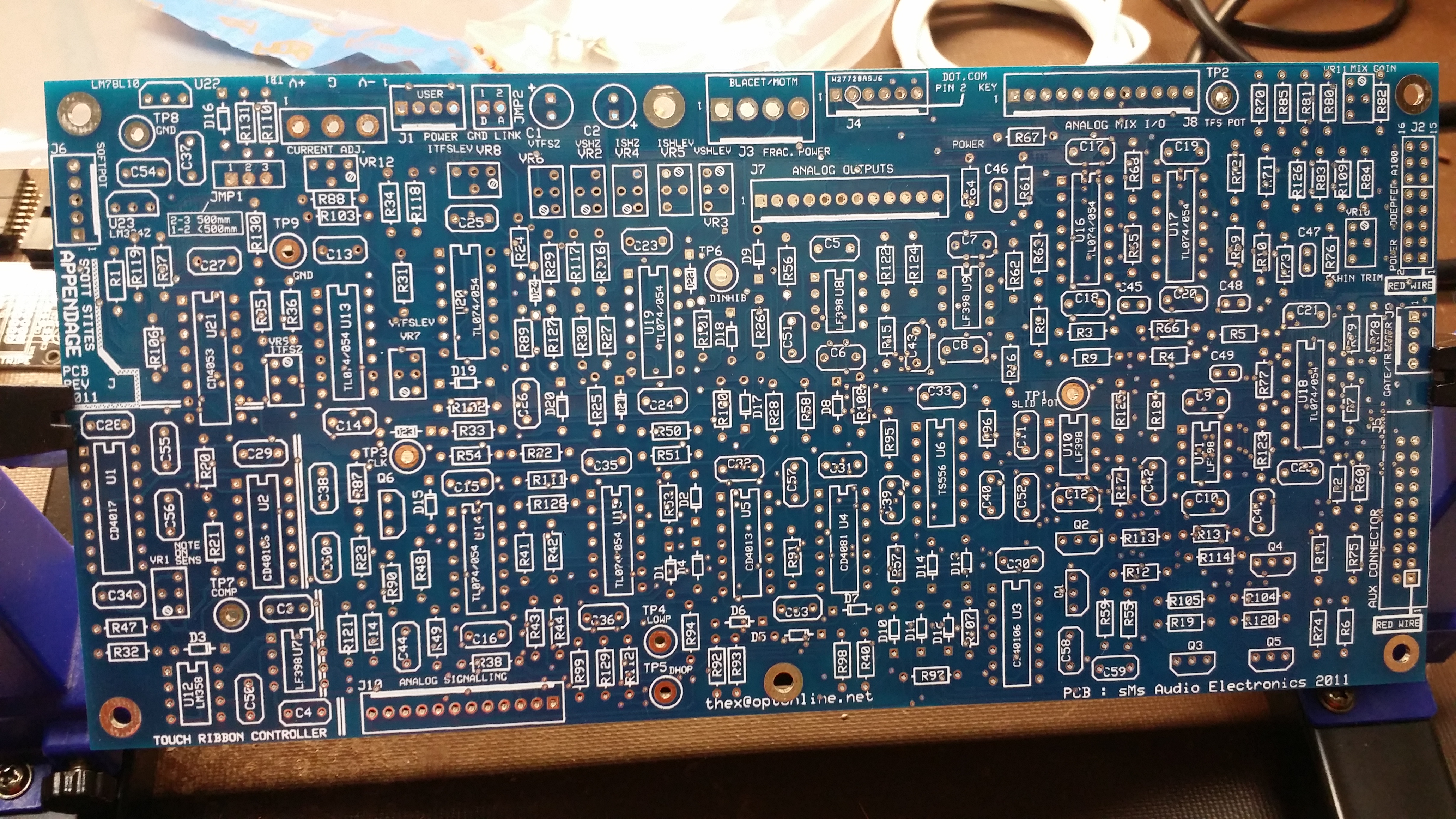

Boards are now available for sale. Please go to Page 1 of this thread for ordering details.
Thank You Very Happy
Bill
 Filesize:  4.01 MB
 Viewed:  2200 Time(s)

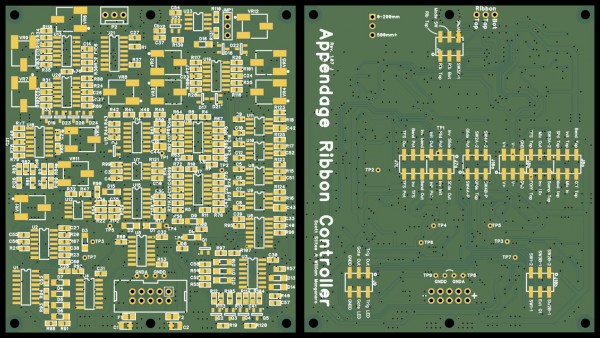

I'm almost finished converting the latest schematic to DipTrace using just SMD parts. Right now it looks like it would fit on perhaps 100x100mm.

100x100mm.
Wow. That's more like it. The original always seemed like it was both an imposing thing to build and huge. Best of luck.
welcome and thanks for joining the EM forum Cool Sounds like some great work here. Are you planning on using finer pitched headers to save on space? Also, SMD headers can also be used. Would like to see the layout when completed.

I'm using SMD 2.54mm headers on the reverse side of the board. That way a simple board with panel mounted stuff can be made easily.
I won't include the MOTM or other format power headers. The 10-pin box header for Eurorack is taking up enough space as it is.
I can post the schematic file (DipTrace .dch) if anyone would like to check for errors. I send free boards for the effort perhaps? Smile

It's a busy board with wires all over the place, but current format is 3x3.6".

I'm waiting for the boards to arrive at the moment.. I might have them within 2wks or so.
Hopefully there won't be too many errors Smile
The dimensions are 91x81mm.

The layout looks very good !! Certainly more compact. Eager to see your post on the results. I like the use of the SMT headers opposite component side to allow more efficient use of board real estate. I did not take a deep dive but did you add the expansion signals that I had on the through hole board?
PostPosted: Mon Sep 11, 2017 7:37 pm    Post subject: Reply with quote  Mark this post and the followings unread
Dayum, that is densely compacted.
I don't think so. If they're not on the headers, they were left out..
