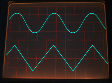

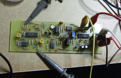

PostPosted: Thu Jan 28, 2010 9:31 am    Post subject: Reply with quote  Mark this post and the followings unread
new saw-core VCO board i made a few days ago.. and derived tri and sine in testing Cool this is a serge-sized board for a panel i am making.

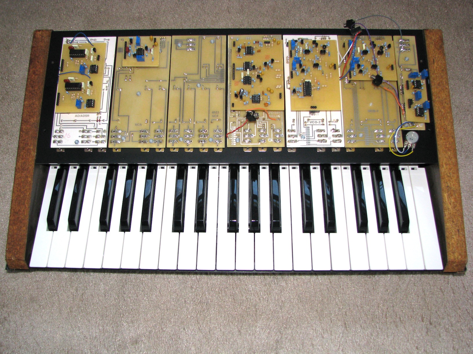

PostPosted: Fri Jan 29, 2010 9:08 am    Post subject: Reply with quote  Mark this post and the followings unread
ericcoleridge wrote:
wow, i guess those pcbs with the board mounted sliders are your Odyssey clone boards, yeah? Have you decided how you'll house them?
I had a beat up Jen SX1000, a truly dreadful synth, but the case was the perfect size. I had the panel made by Front Panel Express (currently looking for a cheap screen printing company).
Everything is identical to the Oddy except for the envelope generators, I had problems getting 1Meg 30mm sliders needed for the original design, so I opted for a couple of CEM3310 ADSR's so I could use 100k sliders instead.
The keyboard is from an M-Audio controller, feeding a Midimplant CV converter, so I can switch from keyboard to external midi control whenever I want... not duophonic though, but I can live with that.
I've got to find time to recover the case in tolex, but I've also got some brown leather left over from renovating my MkIII Odyssey, so I'll slap that on the sides as a token gesture, then probably flog it on ebay Very Happy
Andy.

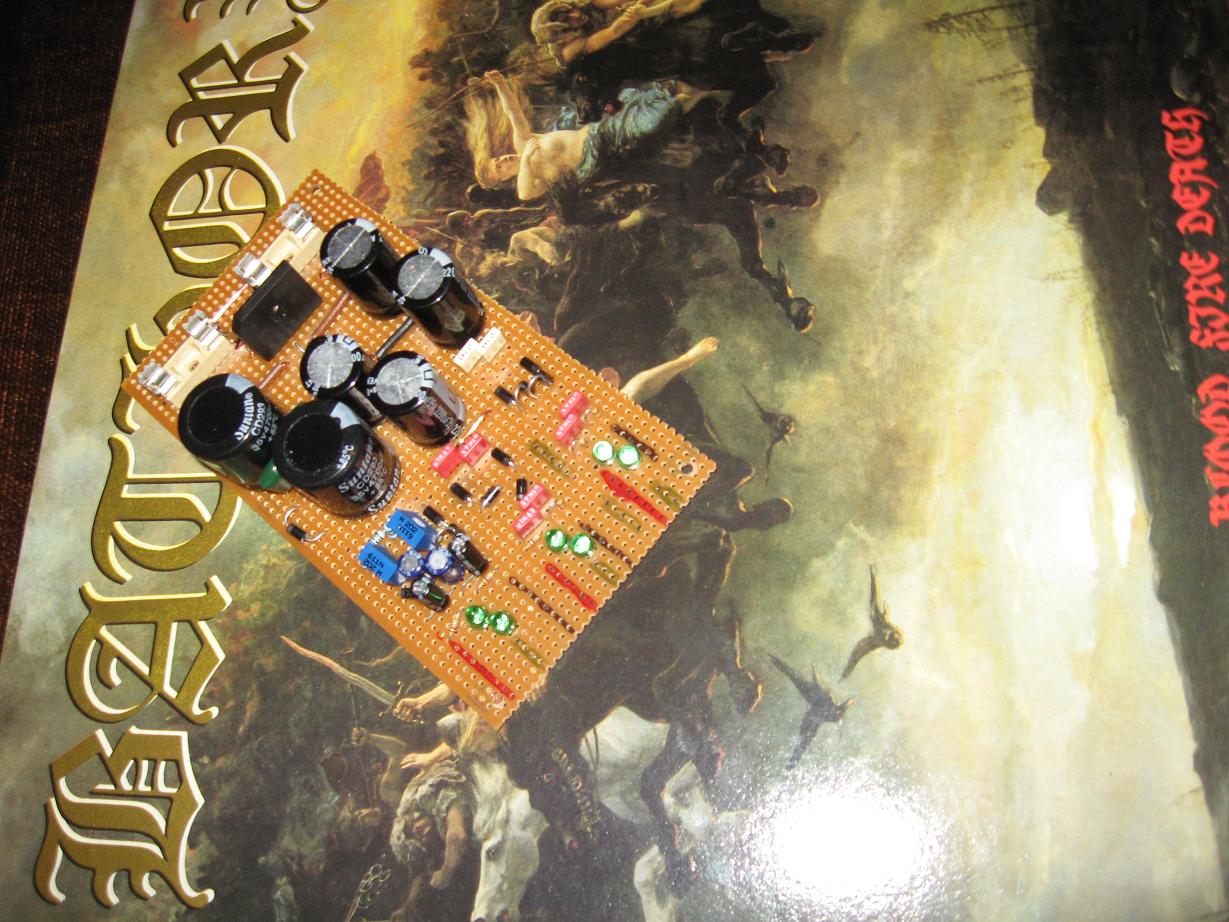

PostPosted: Fri Jan 29, 2010 1:24 pm    Post subject: Reply with quote  Mark this post and the followings unread
Hi folks.
New power supply for my modular system finished providing ....
+ & - 12V (1.5A per rail) for the main modular/ 32 modules.
+ & - 15V (1A per rail) for the poly-dac & Klee sequ. & others to be built.
+ & - 9V (1A) for soundlab ++ & WSG with 8 step sequ.
No regulators on the board yet, they are mounted on big alum heat sinks and fly leaded to the vero/perf board with thick stranded wire.
Big 3A rectifier sorts the modular supply and a smaller 1.5A rectifier does the 15V & 9V supplies.

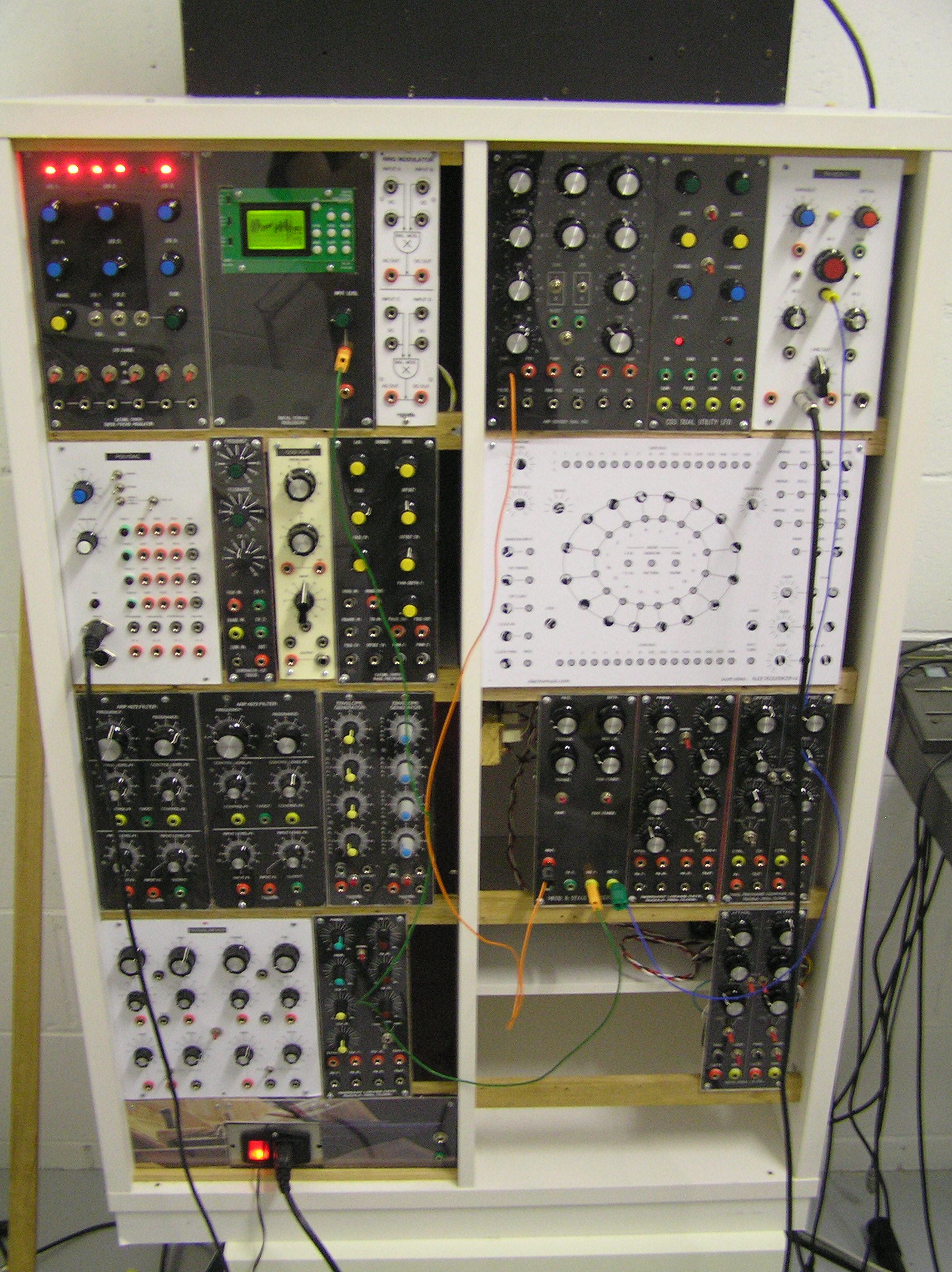

PostPosted: Mon Feb 01, 2010 2:23 am    Post subject: Reply with quote  Mark this post and the followings unread
This is the last 18 months or so. I am a terrible front panel thief.
Hope nobody minds. I had it in a diy dotcom box and have moved it into this freedom furniture cupboard. I'm still trying to work out how to make it look nice.

PostPosted: Mon Feb 01, 2010 4:22 am    Post subject: Reply with quote  Mark this post and the followings unread
Wow , looks great , what did you use for your power supply , i see the mains cable going in at the bottom left ?.

PostPosted: Mon Feb 01, 2010 5:43 am    Post subject: Reply with quote  Mark this post and the followings unread
Thanks.
I used these for the PSU:
http://www.elby-designs.com/power/mains-ac-dc-rectifier/mains-ac-dc-rectifier.htm
http://www.elby-designs.com/power/psu-2/psu2-about.htm

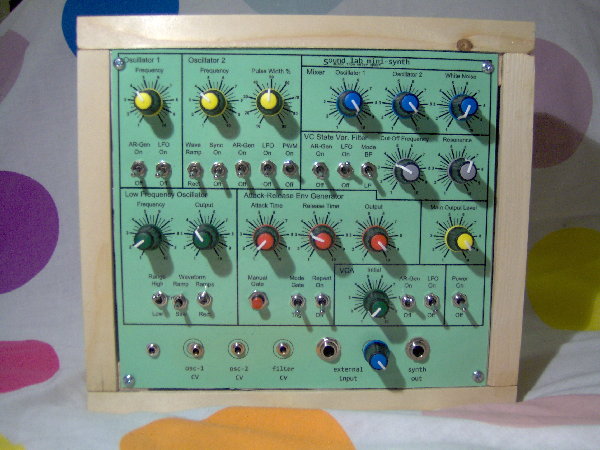

PostPosted: Mon Feb 01, 2010 2:40 pm    Post subject: a soundlab and a dual DS7 Reply with quote  Mark this post and the followings unread
2010 is just one month old and already I have completed my two most ambitious projects to date.
many thanks to uncle krunkus for such a great stripboard layout for the DS7 and everyone else for inspiring me to get of my arse and finish some projects.
