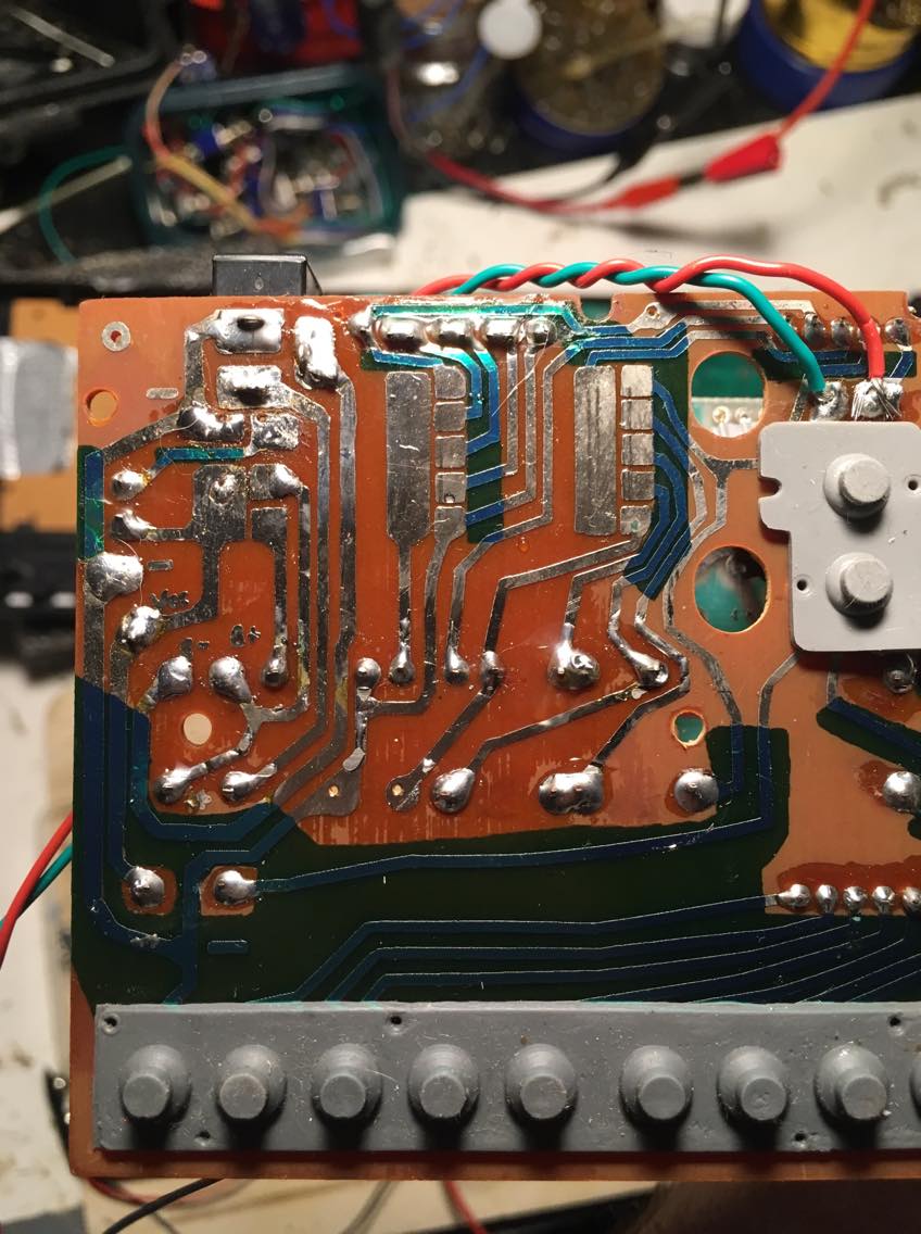

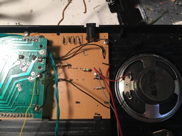

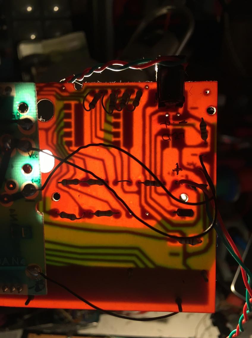

dear hing hon ek-001 people,
I need your help. I already set a new on/off switch, pot for the volume and a kind of pitch-control pot. but unfortunately one of my speaker-cable disconnected and I can't find the right spot on the board.
I've got the single-board version. One speaker-cable is still on it's old place (same stripe as headphone-jack on the board).
maybe u can help me (with a picture or drawing Smile )
thank u!

there are a few versions that could be described as single-board, but this seems to be the most common. if it's not this version let me know I have a couple of other versions::
I se the post is quite old hopefully still of help to you are at least somebody
