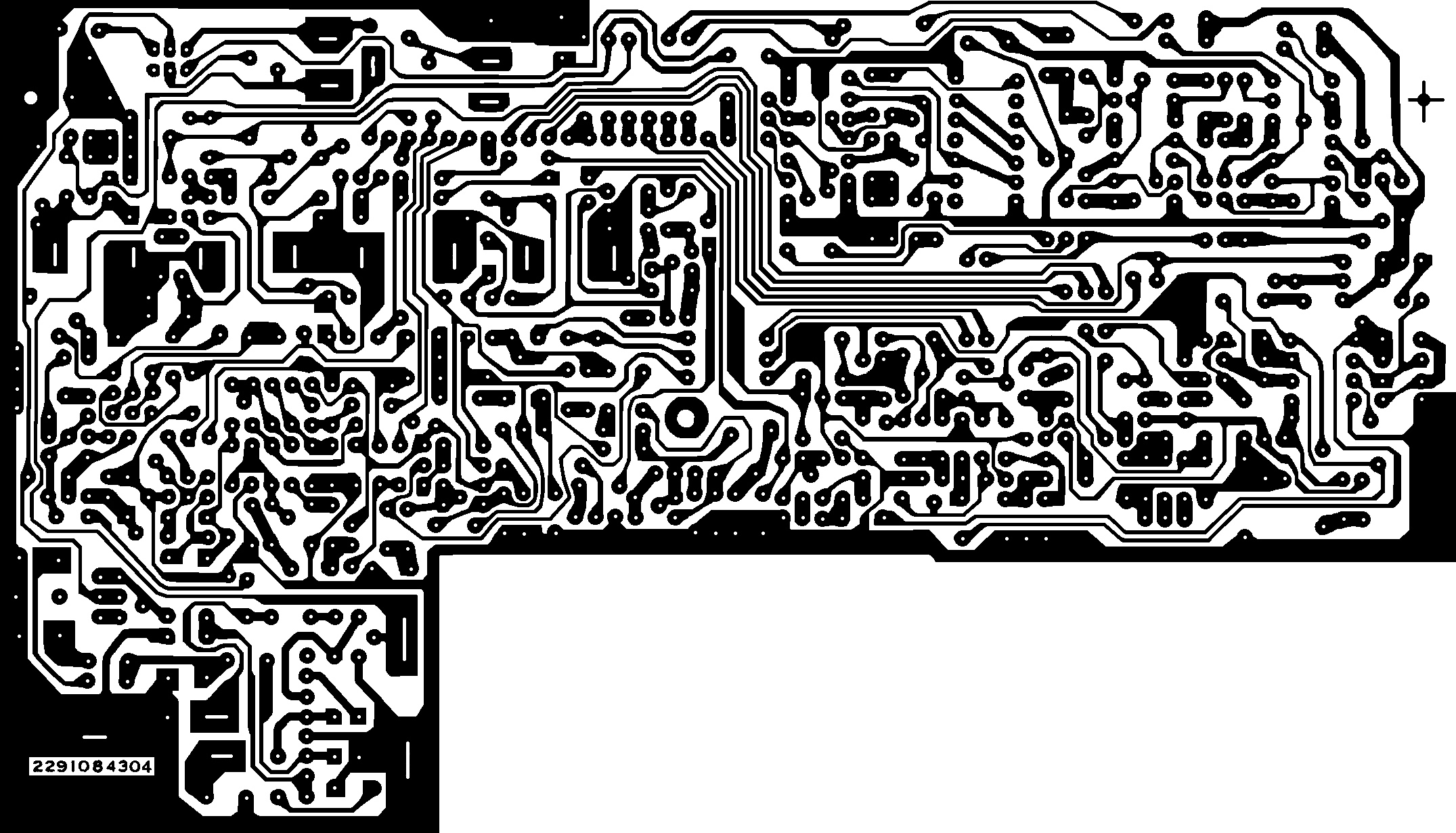

PostPosted: Thu Mar 18, 2010 2:31 am    Post subject: Reply with quote  Mark this post and the followings unread
Sebo posted it quite some time ago, and after 15 mins of threadhunting I could not find it.
I hope Sebo does not mind me reposting it.
Just to make this clear: SEBO did all the work of scanning/retouching the image! Thanks Sebo!
Also: please be aware that this PCB differs from the PCBlayout as shown in the service manual floating around the net. The headphone section is different, the voice/clock/power section the same.

PostPosted: Thu Mar 18, 2010 5:50 am    Post subject: Reply with quote  Mark this post and the followings unread
Thanks Creekree and Sebo!
Just a note to anyone attempting to build this: Roland uses 1/8W resistors, although I suppose one could use 1/4W and bend them around into pseudo-radial parts.

PostPosted: Thu Mar 18, 2010 8:30 am    Post subject: Reply with quote  Mark this post and the followings unread
Thats exactly what I do. The PCB will probably just barely fit underneath the digital board in the stock case, but to me that does not matter:
I will go for a slightly slanted casemod in order to be able to include trigger outs, my cloned Dr-55 rimshot and Dinsync Smile

PostPosted: Thu Mar 18, 2010 8:56 am    Post subject: Reply with quote  Mark this post and the followings unread
Hey, great you find the PCB usefull, as I said before I'd put this project in hold.
Just note that if you want to use Press'n'Peel you need to flip the image.
Cheers.
