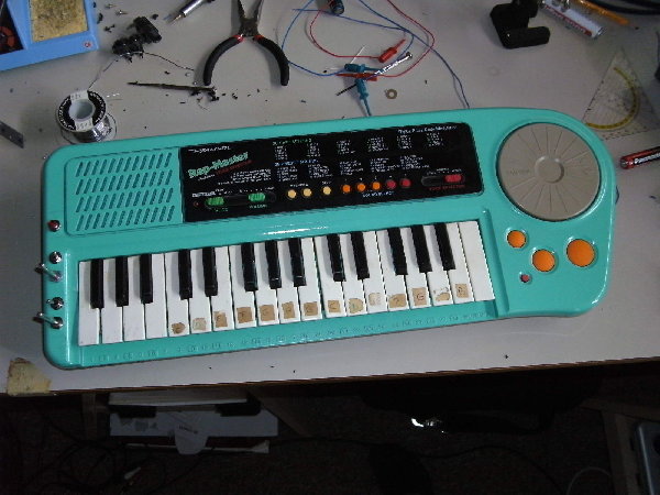

PostPosted: Sat Apr 03, 2010 6:19 am    Post subject: Reply with quote  Mark this post and the followings unread
Well I'm done! Smile
I finished one with a distortion button, feedback pot and glitch pot (both with on/off switches). To make it more usable I added a 1/4 line output and a speaker mute switch..
.. now it's time to enjoy the rest of this long weekend.
I will record and upload some samples and further discuss this. I now have a much better idea of what is possible and I made all the mistakes to learn from!
circuit bent casio rapman
 Filesize:  234.47 KB
 Viewed:  711 Time(s)

".. now it's time to enjoy the rest of this long weekend. "
EDIT: it's bad to post pictures ( more pictures are on my blog ) and no sound in a circuit bending forum Wink , here's a quick and dirty demo:
http://husc-sound.com/stuff/rapmasta_dirty_demo.mp3

[quote="Alexander] it's bad to post pictures and no sound in a circuit bending forum Wink[/quote]
Well, it's got a beauty paint job. Smile
[quote="Alexander]here's a quick and dirty demo:[/quote]
Nice! And thanks for posting the pitch changer datasheet. Very interesting. For a moment I even considered to remove the chip from the Rapman and put it in a seperate little box.
