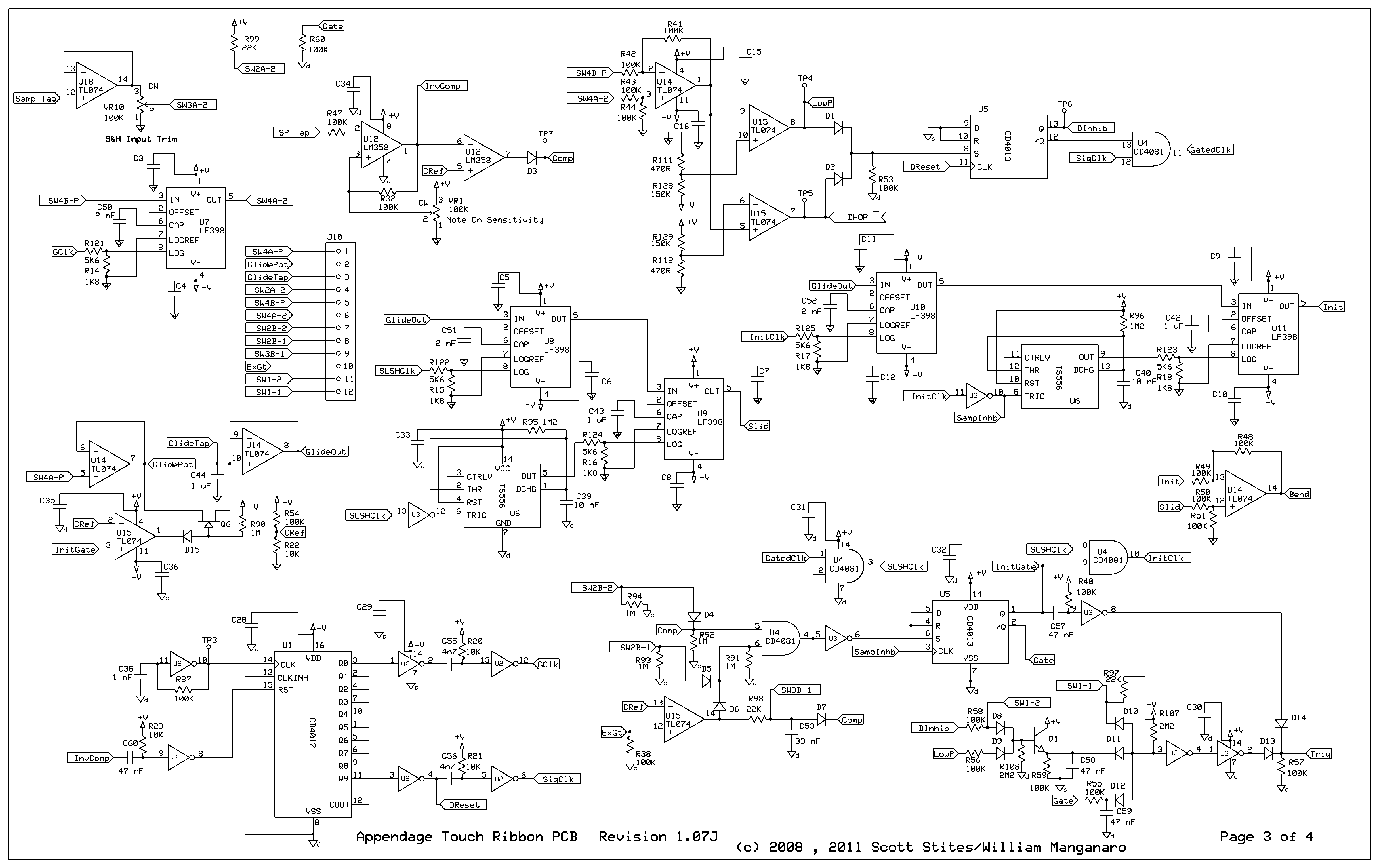

PostPosted: Wed Sep 26, 2018 3:50 am    Post subject: Really weird problem with Appendage Reply with quote  Mark this post and the followings unread
So, here’s the thing. I built the appendage on stripboard (don’t ask!), and it works completely – provided I warm the boards up with a hot air gun! The weird thing is, when it is cool (and depending on the ambient temperature), it works with the bottom couple of inches of the ribbon, but not higher up. As I warm the board up, the usable length of ribbon increases, until all functions work for the full length of the ribbon. Then, as it cools down, the top end ceases to function. (The usable length also increased slightly over time, presumably as current flowing in the circuit warms it up.)
I have traced the problem to the SLSHClk put out by AND gate U4 pin 3 (all references are to the 1.07J schematic, attached). The inputs to this gate, on pins 1 and 2 are the GatedClk, and, effectively, Comp – which goes high when the ribbon is pressed. I measure the GatedClk as a pulse with a frequency of about 1.1 kHz (my main clock runs at 11kHz), with the positive going pulse being 37us wide. That is present on pin 1 regardless of where, or whether, the ribbon is pressed, or the temperature. Likewise, pressing the ribbon, at any temperature and anywhere, makes Pin 2 go high.
The output on Pin 3 SLSHClk, ought therefore, to be identical to the GatedClk, when the ribbon is pressed. Which it is – at the bottom end of the ribbon or when I warm the board. But at the higher end of the ribbon, pin 3 remains Low. In a transitional length of ribbon, pin 3 goes High with a 1.1kHz pulse, but the width of the pulse decreases over half an inch or so of ribbon from 37us down to less than 1us and then to nothing.
Since the output on U4 pin 3 also ultimately drives all the S&Hs, and the sample deinhibit, it makes sense that the absence of a SLSHClk would indeed mean no sample.
Been tearing my hair out over this one. Any help welcome!
I have swapped the 4081 in U4, to no avail. I am using ST HCF4081’s – not sure if using CD4081 would help? My other thought was that the SLSHClk signal is fed into pin 8 of U8 (LF398) via a voltage divider consisting of 5k6 and a 1k8 resistors. That means there is a 7k4 path to Ground, which assuming SLSHClk is at 12v (when High), would seem to mean U4 pin 3 has to source about 1.6mA. The datasheet for the HCF4081 says the maximum output drive current at 10v supply is typically 2.6mA, but could be as low as 1.1mA. At 15v supply, the minimum is 3.4mA and typical 6.8mA. (I’m not sure if these are per gate or total for the whole IC). So I am just wondering if my IC, at 12v supply, is just on the cusp of being able to supply the necessary current – and presumably if it is unable to do so, the gate won’t function properly. Quite why, or how, this depends on both temperature and the voltage sampled by the ribbon (which as far as I can see is not directly in the various clocking signal paths) is a mystery.
Is there any reason why the voltage divider on U8 pin 8 uses such low values? The LF398 doesn’t need any significant input current to that pin, so why not use, say 56k and 18k? That would reduce the load on the AND gate.
But maybe there is some other explanation?

PostPosted: Wed Sep 26, 2018 8:27 am    Post subject: Reply with quote  Mark this post and the followings unread
The first thing that occurs when you talk about heating up the board is solder joints. Heat makes things expand and could complete connections that are otherwise dodgy. Those are often hard to find by poking and probing because usually putting your meter probe onto something can *also* complete a dodgy connection.....

How did all work out? Did you get this working and if so, what was the remedy? I was starting to think the same thing that pin loading is the issue considering the inputs to the AND gate were the same always when working and not working. By design, there really has not been a loading problem on this gate and there have been many Appendages built. If you have not changed the chip to a CD4081, I would try that. If that does not work, then pull each chip that the signal feeds one by one and see if any of the these devices are causing the problem.

PostPosted: Sun Nov 18, 2018 10:42 am    Post subject: Reply with quote  Mark this post and the followings unread
thanks for the response. Been moving house, so not been able to work on synth recently. I've sort of parked this problem for a while - the board is a fiendish triple stacked stripboard with a rats nest of wires to the panel - not easy to get at components. But I think I can disconnect the output of the 4081, which should allow me to test the 'load' theory.

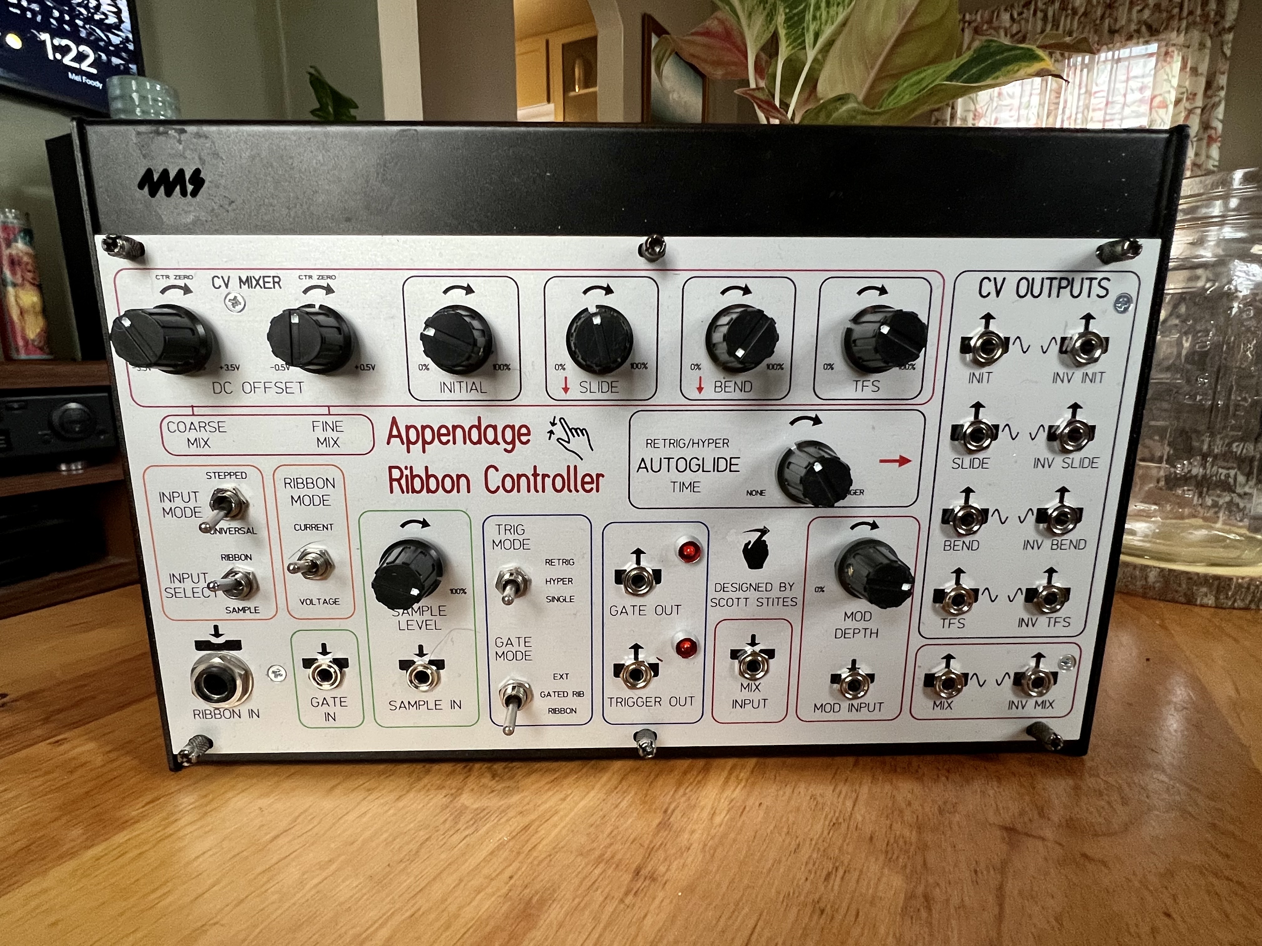

PostPosted: Sat Mar 25, 2023 11:05 am    Post subject: Appendage: Calibration issue Reply with quote  Mark this post and the followings unread
Hi there, I started building the Appendage about 6 years ago, had to put it down for a bit. But picked this up a couple months back. I know this is digging up stuff on an old thread, but like film, analog synths are not dead.
Everything seems to work, I have it configured for 10V (not 5V Euro). I am able to configure steps 1, 2 and part of 3 (1-Cool as per the build guide.
However, for step 3, part 9.
"While applying pressure to the lowest portion of the ribbon as possible, observe the DMM display:
9A. If the voltage is not a negative voltage, adjust VR2 until you observe the
reading go to a small amount of negative voltage just under 0V on the DMM.
9B. After observing a negative voltage, adjust VR2 until the voltage just changes
over to 0V on the DMM.
10. While applying pressure to the highest portion of the ribbon as possible, observe the
DMM display. Adjust VR3 for a reading of 10V on the DMM.
11. The adjustment between VR2 and VR3 is interactive, so the voltages will need to be
“balanced out”. Repeat steps 7 and 8 until pressure on the lowest portion of the ribbon generates 0V and pressure at the highest point of the ribbon generates 10V."
I am never able to obtain a positive voltage. The best I can do is -1.27v to -7.7V from the lower end of the softpot to the high end.
I am using a 750mm 20K softpot. I have been fiddling with this for days and it will only stay with the negative voltage.
Any Ideas where I messed up?

PostPosted: Sat Mar 25, 2023 6:32 pm    Post subject: Reply with quote  Mark this post and the followings unread
A couple starting points.
You say "not Euro 5V" but not what your actual supply voltage is. If it's 12V,
the 78L10 is awfully close to the +12V rail. Are you getting a good solid 10V? Or is it more like 9.6 or 9.8?
Are you sure you're using voltage mode and not current mode? (You don't say anything about whther you're using the panel PCB, in which case it's possible you have the switch backwards?)
So Step 5 and Step 7 you get the specified voltages?
Meausre at U19 pin 1 and see if you're getting as much swing as you think from VR 2 -- it should be about 6V, which it sounds like you're getting.
What are the voltages from the ribbon itself directly at the top and bottom, measure U13 pin 8.
In theory your ribbon should be measuring from not quite 10V (or whatever your voltage from the regulator is) to somewhere not too far under 2V.
is R117 correct (330K)?
The other thing that seems weird about the voltages you're reporting ...
U19A is summing the positive voltage from the ribbon, with a negative voltage from VR2 and then inverting them. If you're getting the expected ~1.9V from the bottom position of the ribbon, there should be *no way* that your output voltage could go more negative than that, because VR2 is supposed to swing between ground and the -rail, and the divided by 3 (the 330K resistor, with 100K feedback resistor) and inverted. The VR2 component should be (at the output of U19A) 0 -> +4V or +5V depending on which supply values you're using.
Stupid question: do you have the bottom and the top of the ribbon mis-identified? Maybe the ribbon is mis-wired to reverse them, or maybe you have top/tap/bottom wired wrong in some other way?

PostPosted: Sat Mar 25, 2023 6:45 pm    Post subject: Reply with quote  Mark this post and the followings unread
It seems to me that your Ribbon Mode switch is in the wrong position.

PostPosted: Sun Mar 26, 2023 9:57 am    Post subject: Appendage Calibration, Step 3 Reply with quote  Mark this post and the followings unread
Wow! Thank you or the assistance.
My answers are listed under each question.
Q: You say "not Euro 5V" but not what your actual supply voltage is. If it's 12V,
A: The 78L10 output is 9.99V
I am using a linear AC-DC +/-12V power supply, providing 1.5A (max) per rail. Wall wort is AC and rated for 2500mA
Q: Are you sure you're using voltage mode and not current mode? (You don't say anything about whther you're using the panel PCB, in which case it's possible you have the switch backwards?)
A: I am using a hand wired DIY box.
- When mode switch is closed (current mode) R37, U21-9-10-11 have continuity to ground. When switch is open (voltage mode), voltage at R37 is 12.03V , U21-9-10-11 is 12.03V
Q: So Step 5 and Step 7 you get the specified voltages?
A: Step 3-5, I have adjusted to -4.77V
Step 3-7, I have adjusted to +0.600V
Q: Meausre at U19 pin 1 and see if you're getting as much swing as you think from VR 2 -- it should be about 6V, which it sounds like you're getting.
A: VR02, set to the furthest extent clockwise, U19-1 is 0.00V
VR02, set to the furthest extent counter-clockwise, U19-1 is 3.57V Max!
Then I recalibrated All steps back to Step 3-7 as follows:
Step 1, voltage at R34 in voltage mode: 1.475 V, at R34 in Current mode: adjusted up to 1.475V
Step 2, Gate set at low and high end of softpot with voltage at 10.46V
Step 3-5: adjusted again to -4.751V
Step 3-7, adjusted again to +0.607V
Q: What are the voltages from the ribbon itself directly at the top and bottom, measure U13 pin 8.
U13-8 A: press Top = 1.485V
press Bottom (where the connection is) = 8.03V
Q: In theory your ribbon should be measuring from not quite 10V (or whatever your voltage from the regulator is) to somewhere not too far under 2V.
A: Yes.... Orange, Orange, Black, Orange Brown
Q: The other thing that seems weird about the voltages you're reporting ...
Note: Calibration not completed beyond step 3-8
A: voltages on U19
U19-2 = 0V
U19-1 = Idle = 1.438V, press ribbon top = -0.047v, press ribbon bottom = -6.57V
U19-6 = 0V
U19-7 = Idle = -0.082V, press ribbon top = 0.013v, press ribbon bottom = 8.96V
Other voltages:
U21-4 = Idle = -0.081V, press ribbon top = -0.014v, press ribbon bottom = 8.96V
U21-14 = Idle = 8.09V, press ribbon top = 8.09V, press ribbon bottom = 8.09V
U21-15 = Idle = -0.001V, press ribbon top = 0.003v, press ribbon bottom = 0.003V ***** Does not seem right *****
U13-1 = Idle = 1.4751V, press ribbon top = 1.483v, press ribbon bottom = 1.483V
U13-3 = Idle = 1.4751V, press ribbon top = 1.483v, press ribbon bottom = 1.483V
U13-10 = Idle = 0.002V, press ribbon top = 1.504v, press ribbon bottom = 8.03V
U13-14 = Idle = 8.10V, press ribbon top = 8.09v, press ribbon bottom = 8.08V
U13-7 = Idle = 0.024V, press ribbon top = 0.032v, press ribbon bottom = 0.034V
U20-1 = Idle = -0.025V, press ribbon top = 0.03v, press ribbon bottom = 0.03V
U20-14 = Idle = -0.026V, press ribbon top = 0.034v, press ribbon bottom = 0.049V
U20-7 = Idle = 0.001V, press ribbon top = 0.006v, press ribbon bottom = 0.009V
Q: Stupid question: do you have the bottom and the top of the ribbon mis-identified? Maybe the ribbon is mis-wired to reverse them, or maybe you have top/tap/bottom wired wrong in some other way?
A: I thought of this at first (because mistakes I make are usually stupid ones Smile, then tried reversing at the softpot connector. All it did was reverse voltages top to bottom. Pulled the entire thing up and retested from the PCB, through the Jack and trough the softpot. Wired correctly. No change.

PostPosted: Sun Mar 26, 2023 10:19 am    Post subject: Re: Appendage Calibration, Step 3 Reply with quote  Mark this post and the followings unread
You have your top and bottom backwards. The 1.485V is the bottom.
YES it is SUPPOSED to reverse voltages top to bottom. You need to press the 1.485V end (whichever it might be) in order to calibrate.
sixbyseven
Joined: Jan 28, 2016
Posts: 26
Location: hamilton, Ontario
PostPosted: Sun Mar 26, 2023 10:54 am    Post subject: Just to clarify.. Edited Reply with quote  Mark this post and the followings unread
Edited.
I was getting -1.186 at the bottom and -7.29 at the top measured at TP1.
I traced the circuit from "SH Scale" flag on page 2of8 through to U14-7 where I am getting 0 through 5V, top to bottom. But -6.08V to -0.996 top to bottom on U14-10.
Then I realized the glide pot was all the way up, I then rotated it to minimum and now I get 0V to 4.675V top to bottom at TP1
I can't get the voltage higher than 4.743V no matter how far I adjust VR3
Weirder yet, is that it is acting more like a logarithmic pot, even though it is linear (tested). I can move from bottom to 3/4 of the way up the softpot until the voltage breaks below 4 V.
Question: Should the glide pot have that much effect to send this to -7V when fully turned up?
wondering if Q6 (MPF102) is messed up

PostPosted: Sun Apr 02, 2023 12:28 pm    Post subject: Reply with quote  Mark this post and the followings unread
After using this thing for several years I recently decided to repackage it in Eurorack format. I borrowed from State Machines designed but shrunk it to fit into 48hp. This way I could put the thing in a 4MS 48x case. Love it!
