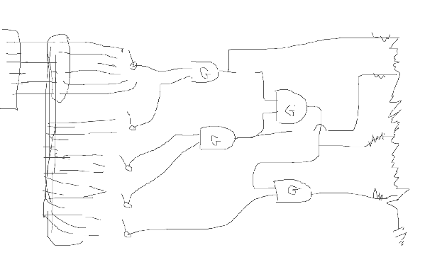

PostPosted: Wed Apr 21, 2010 4:15 am    Post subject: Reply with quote  Mark this post and the followings unread
I'm only talking CVs here.
What I would try to give more control and variation is to replace the 2*4 way gate input switches with 2*6 which are both across the 6 least significant bits. (I don't think you even need to bother with more bits than that, as it provides for a 64 step sequence. Adding access to higher bits if needed is a relatively easy option to add later.)
Then arrange the gates like this:-
Four (6way) bit switches into the dual inputs of two gates,
The outputs of those two gates into a third gate,
The output of that into a fourth plus another (6way) bit switch.
Take your 4 bits to the R2R from the outputs of these four gates.
As before, make the gate types for all four switchable.
I'm pretty sure that will allow virtually all logic combinations across 6bits into a 4bit R2R. Expand from there with a similar approach.
PS If I didn't have my hands tied under my arse I'd be breadboarding this as we speak. I've got Sat/Sun off so maybe I'll get a chance then. Very Happy

OK Uncle, I understand where you're coming from with your latest suggestion. I'd say "add it to the list" of possible options. As you can hear from my previous post, your original idea gives plenty of musical interest to me at least when there are two of them.
Your second logic structure may provide more musical diversity per board, however, so it's worth a look. I do feel that your original design is more intuitive, more basic, more fundamental, etc. We'll have to see what pans out, but I like your first idea best so far.
Les
PostPosted: Wed Apr 21, 2010 5:08 am    Post subject: Reply with quote  Mark this post and the followings unread
Man I love the sound of that KS board! Shocked
And I don't even know how it works!! Rolling Eyes
BTW That last gate layout is what I originally meant. It's just taken me a while to describe it properly. Laughing
BTBTW How's this for a work of art?!? Rolling Eyes

PostPosted: Wed Apr 21, 2010 5:14 am    Post subject: Reply with quote  Mark this post and the followings unread
You know the old joke that the older and wiser an engineer gets, the sloppier his schematics get, haha. By that measure you must be a sage indeed Andy! I get the idea, if I get a moment I'll prototype it in ChucK.
Les

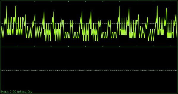

PostPosted: Wed Apr 21, 2010 5:55 am    Post subject: Reply with quote  Mark this post and the followings unread
Psyingo in the chatroom requested a waveform shot of the BS run at audio rates. Here it is. It sounds very machine-like as it is a control voltage sped up really fast.

PostPosted: Wed Apr 21, 2010 7:46 am    Post subject: Reply with quote  Mark this post and the followings unread
I got a very similar waveform from funnily enough from a custom Weird Sound Generator i've made for a friend yesterday.

PostPosted: Wed Apr 21, 2010 9:21 am    Post subject: Reply with quote  Mark this post and the followings unread
How about that? I just took a quick look at the WSG block diagram and schematic. The circuits are completely different, so why would they generate similar waveforms? Perhaps the combination of a few oscillators running at different frequencies is analogous to the binary patterns that are grouped together into musical phrases, though only in the most vague sense. Thanks for noticing the similarity.

PostPosted: Wed Apr 21, 2010 7:28 pm    Post subject: Reply with quote  Mark this post and the followings unread
Inventor wrote:
Les
Yeah that's pretty much it. Oh and the filter added to the equation.
