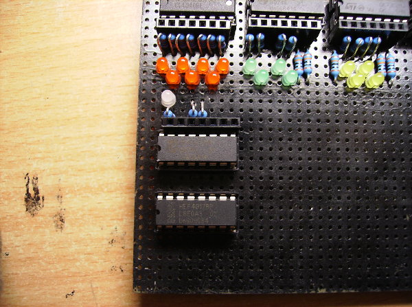

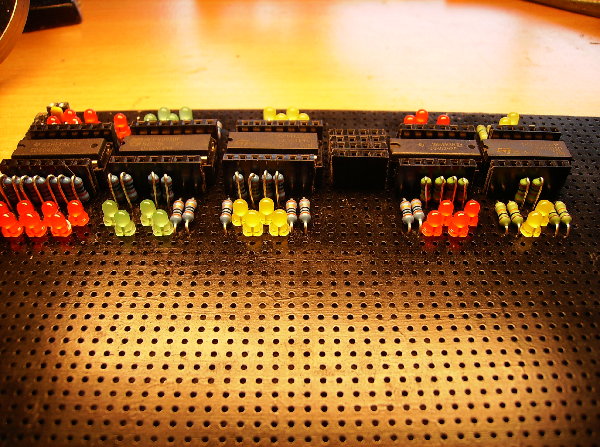

Finished the order today, among a lot of other cool stuff I got some chips: C4029, C4014, C4030, C4066 and C4069. Ive seen a couple of good uses for these(bookmarking rules when embarking on long internetsearches) so I guess there will be a lot more updates still to come Very Happy .
Last few days I found myself entangled once again in datasheets, schematics and forumposts. It's really easy to stray off the path and end up with a headache Sad . I still have a lot of IC's waiting for a home on the board so today I regained some focus and added the 4024 and 4011. Really getting the hang of this type of build now. Socket, headers, read the datasheet, power, pulldown resistors, led resistors, leds, ground lines.
My header connectors come in rows of 20, I ended up with a lot of 4 hole pieces. I connected them in 4 rows of 4, very usefull for your gating leds and outputs. The scale of the whole unit is also really nice, current unit is just 14x8cm with already some nice sonic potential.
Up next:
Some more oscilators on a seperate board, I have a 556 and a 4093.
And ofcourse, a melodygen!
future stuff:
A 4029 binary/decade sequencer, very excited about this one. Has anyone tried this? datasheet: http://www.ti.com/lit/gpn/cd4029b , there is an interesting page about linking them together, a 8 or 16 step sequencer maybe? Wish I had bought more than 1 Razz
And ofcourse some more pictures:
left to right: 4040, 4051, 4015, kludge, 4024, 4011.
 Filesize:  1.84 MB
 Viewed:  608 Time(s)

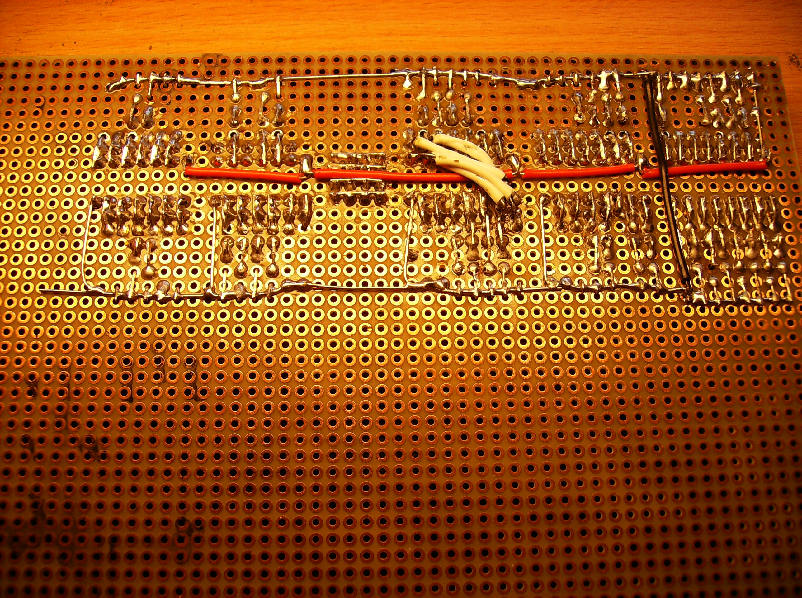

Getting less and less excited to show the belly of the beast, but it might be usefull to someone...
 Filesize:  2.72 MB
 Viewed:  578 Time(s)

Rykhaard
Joined: Sep 02, 2007
Posts: 1290
PostPosted: Fri Jun 18, 2010 4:17 pm    Post subject: Reply with quote  Mark this post and the followings unread
I used to be a fan of the CD4029 but there's 1 thing with it that really put a damper in my spirits for it - it advances it's count on the DOWNswing of the input clock. That throws it being in 'sync' with other things, out, by 90 degrees! Sad
Ken Stone had also used it in his Dividers (original and new one). At least his new one, has outputs at all 4 of the 90 degree divisions, to making syncing things with that divider a LOT easier. Still though - I'm not a fan of that chip, and I may have - quite a few of them. I'll have to check. As well - rethink, whether I'll use them ever again or not. If not - they'll be available for gifting. Smile
And again - BEAUTIFUL looking perfboard work! I can't wait to see more videos, especially with yourself using the LEDs as Droffset does! I LOVE that look! (Missing orange, blue and white LEDs though but - I'm an LED freak and would use purple and pink as well - if they'd release superbright versions of them. (And _STILL_ wanting, a 'brown' LED. Razz Laughing )
hmm, can a 40106 inverter be of any use here? I find myself quite confused with the whole sequencer bit of this build. I would like a seq. where I can plug in any output from anywhere into the board on a step and have a common output to go to the filter/mixer/amp board. Might have to think this one through a bit more...
Yeah definately not regretting all the work it took to put in the leds, it's amazing how far a little visual feedback goes! Ive also been thinking about more colours but they are more expensive(where I get them) and I have to keep remembering myself this is still a experimental board.

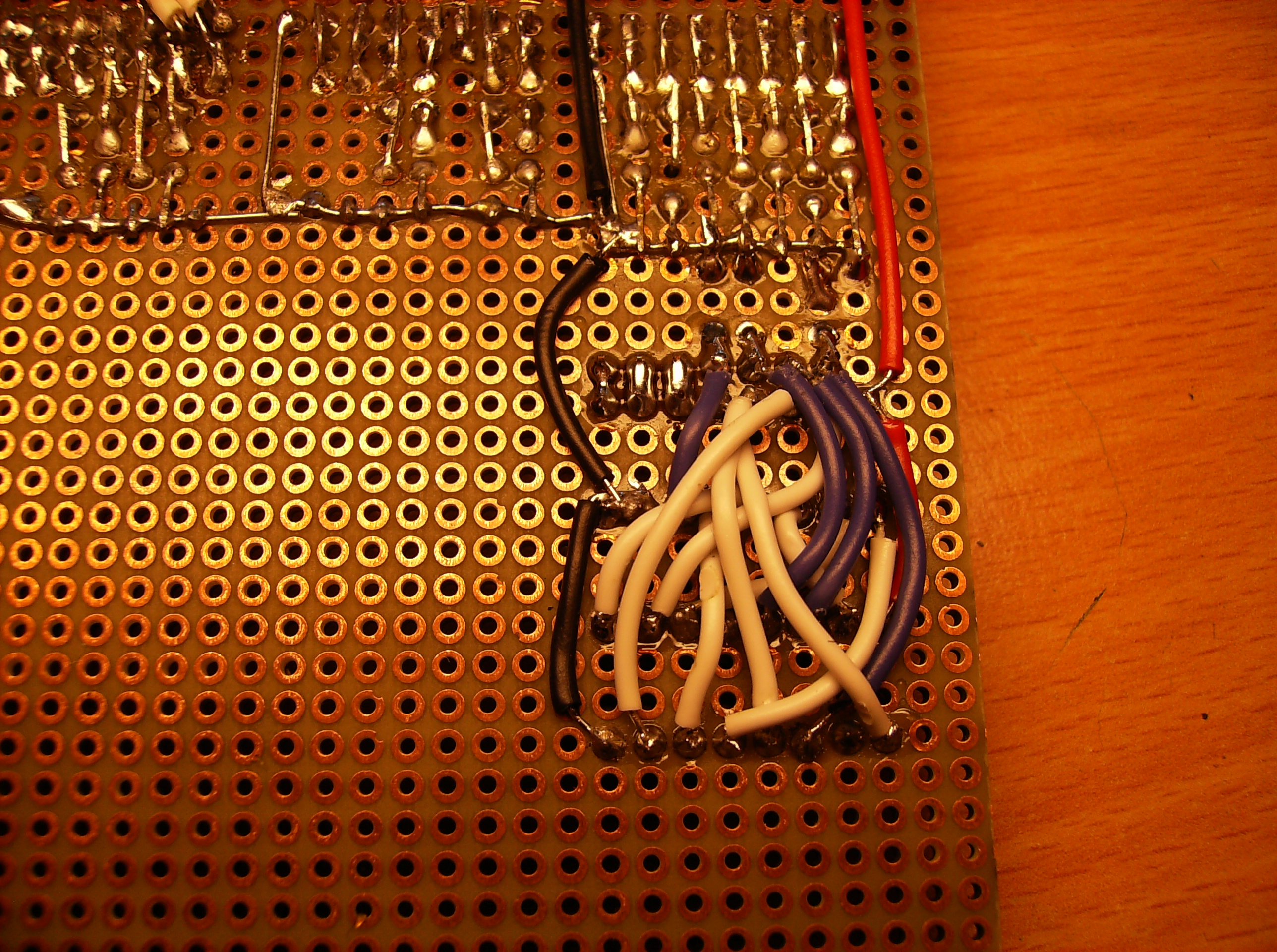

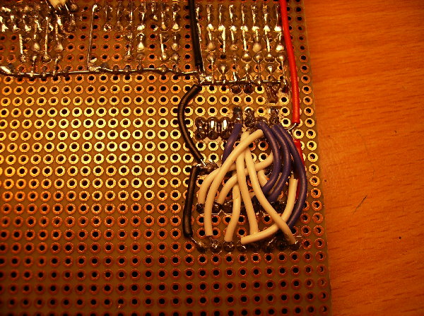

Hi minus, nice to see you over here, I guess it was bound to happen. I hook the leds up like this:
OXRRLL-G
OXRR-LLG
OXRRLL-G
OXRR-LLG
O=IC
X=header
R=resistor
L=led
G=ground
Hope this makes sense to you, otherwise, use the foto's for reference. The leds have to be placed like this or they wont fit next to eachother. Sometimes you have to snip of a corner to make them fit.
I think 4040 and 4051 are a good place to start, check http://milkcrate.com.au/_other/sea-moss/
After having to disassemble the melodygenerator for the second time because my breadboard is tiny I thought I might as well add it to the board.
The underside is resembeling a nest of snakes but it all works and once again the led on the output is very usefull for visual feedback.
 Filesize:  1.6 MB
 Viewed:  410 Time(s)
 Filesize:  2.14 MB
 Viewed:  388 Time(s)

-minus-
Joined: Oct 26, 2008
Posts: 787
PostPosted: Sun Jun 20, 2010 7:43 am    Post subject: Reply with quote  Mark this post and the followings unread
Yep, makes sense! Thanks. The photos are great too. Particularly when you zoom in on them. I'm going to make a start tonight. I had Inventor's Quad osc breadboarded up a while ago but will redo this and get it soldered onto some stripboard. Might make use of the other two oscillators on the IC and have 6. Keep on posting! I'm learning heaps!

Just a quick question... Your 40106 oscillator seems to have a variety of caps there. I see 100n used a couple of times, and a red one of unknown value, and an electrolytic. I assume this is giving you slower oscillations. Inventor used 0.047uF caps on all 4 oscillators I think. I've mucked around a bit with cap values on the heterodyne space explorer found elsewhere in this Lunetta section of the forum... I was curious about the mystery values. I'm guessing you just experimented and decided what would be useful. Thanks.
tjookum
Joined: May 25, 2010
Posts: 360
Audio files: 26
PostPosted: Sun Jun 20, 2010 11:21 am    Post subject: Reply with quote  Mark this post and the followings unread
Good question, as you can see on the photo it's 2x 0.1uF, the red one is 0.022uF and there is a 1uF electrolyth as an pseudo LFO. In hindsight I think 0.047uF will give you the best audio range, and even smaller for the clocks. Ive also thought about using header pins so they are switchable. The next 4xosc is probably going to be a lot higher values to act as clocks, it's easy to divide, a lot harder to make them higher.I think the 556 has a better frequency range so that might be usefull.

hehehe, great to see you're getting into it Minus! I have no doubt you will pick it up in no-time. The lunetta virus is a pretty nice one to catch, you never know where you'll end up next Very Happy . Confused Dont forget to sleep though, I find it very relaxing Wink
I can definately recommend the perfboard with headers design, it's so simple and instead of finished modules you just have a bunch of blocks you can build with. And ofcourse you'll always have the option to connect the headers to a bananajack frontpanel. Im probably going to make a simplified frontpanel with some switches and knobs so friends can play it more intuitively(is that even a word?). A important goal for me is to make people want to play it, now most of them are just scared to touch anything Rolling Eyes
And I really do apologize for filling this thread up with the rants of a madman....
No need for apology's here man, you're among friendly people Smile . I quite like the rants of madmen actually, but for the purpose of keeping the info clear and readible I would recommend starting you're own thread. I for one would love to see how you get along.
Maybe I'll post another update later today, been experimenting with an fx pedal and hopefully my new parts arrive in a few hours, Cool !
