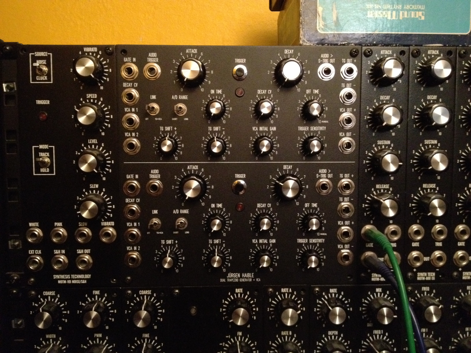

Oh, BTW, here's a pic of the panel Dave & I cooked up, with some MOTM panels for comparison. The alignment of the bottom jacks is a little off, the "VCA IN 2" should be "VCA CV", the "TG SHIFT" should be scaled -5 to +5, and the "AUDIO TRIGGER" should be "SWITCH TRIGGER". Oh, and the black paint isn't quite as black as the MOTM paint. It ain't perfect, but I'm pretty darned happy with it. Please cut us some slack - it's our very first custom panel! ;)

PostPosted: Tue Jan 24, 2012 9:37 am    Post subject: Reply with quote  Mark this post and the followings unread
Looks really nice!
emdot_ambient
Joined: Nov 22, 2009
Posts: 667
Location: Frederick, MD
PostPosted: Tue Jan 24, 2012 11:10 am    Post subject: Reply with quote  Mark this post and the followings unread
Yeah, it looks pretty awesome!
Do you have an electronic version of the front panel design of it you could share? It looks like a good jumping off point for the ones I'll eventually build (I've got 2 in my inventory).
MR-808
Joined: Sep 30, 2010
Posts: 28
Location: Portland, OR
PostPosted: Tue Jan 24, 2012 7:09 pm    Post subject: Reply with quote  Mark this post and the followings unread
Thanks! Here's an FPD with the legends fixed - hope it's useful!

emdot_ambient
Posts: 667
PostPosted: Wed Jan 25, 2012 2:13 pm    Post subject: Reply with quote  Mark this post and the followings unread
Cool, thanks! I'll end up messing around with it to suit my needs but this'll really help. Cheers!
