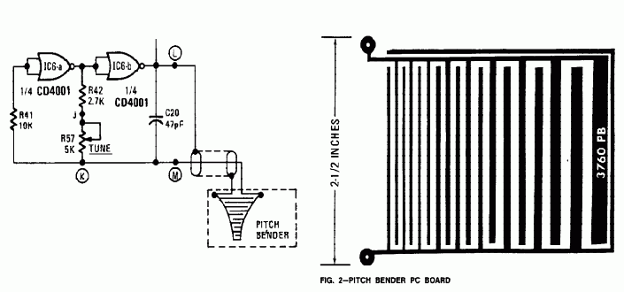

PostPosted: Sat Nov 27, 2010 3:07 am    Post subject: Reply with quote  Mark this post and the followings unread
Instead of using the human body's conductivity -- which you have already discovered is poor -- to alter a resistance, utilize its dielectric constant (a fancy way to say "poor conductivity",) to alter a capacitance.
The circuit below is from PAIA's Oz Mini Organ. Touching the plate increases the capacitance, lowering the oscillator frequency. The good thing about this is the conductors are insulated with a coat of paint, or tape so that skin is not in direct contact with the circuit. (What happened to all the concern about static discharge damaging CMOS?)
There is a thread about touch switches in the DIY section.
http://electro-music.com/forum/viewtopic.php?highlight=touch&t=20222
You might also look into how Theremins work.

aerogramma wrote:
Just one quick question: what if more than one body is in contact with the plate circuit you suggested eg. a chain of 5 people?
With resistance I found very little change
A chain of people holding hands, beside making the participants feel all warm and fuzzy inside, would equal large value resistors in series. (I just now measured myself as 6-8MegOhms left hand to right.) A large resistance in parallel with a smaller resistance will have very little effect on the total. To have a greater effect, bodies' resistances would have to be in parallel -- which could be interesting when more than two people are involved.
I'm not certain the above reasoning would hold true for capacitance, but if the dielectric constants of bodies in series add up, then that would equal a smaller capacitance than one body. And a small cap in parallel with a larger one would also have very little effect on the total. In theory. scratch
