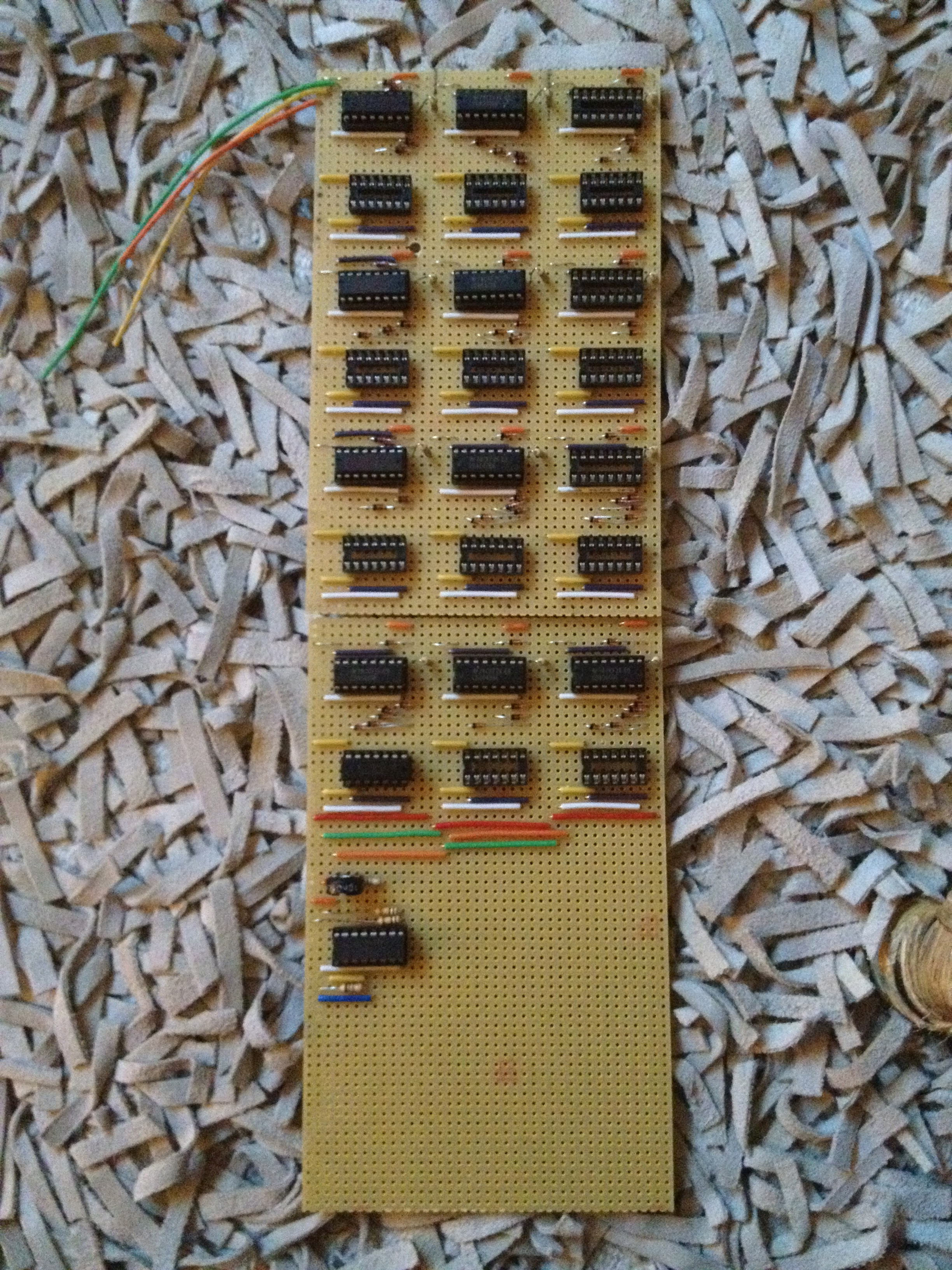

i finally got round to starting this project, thanks for the schematics Marco!! Very Happy took about 11 hours to build the TOG board, now to work on wave shapers, EG, VCF and VCA per voice......

Wow bod. Very clean and organised work. I didn't follow this schematic, but my top octave synth was a little messier...

good work! thats some rats nest!! to be fair mine will end up the same in all likelihood!
think i'm going to aim for an LM13700 hp/bp/lp vcf and vac for each note, but i need to work out a simple voltage controlled a/r envelope generator first.
