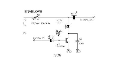

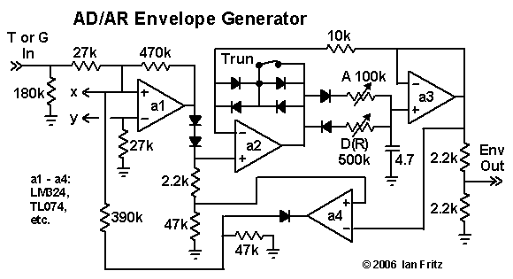

Paradigm X wrote:
need a basic AR nd vca to get this running. Can anyone suggest a good pcb/schematic of what id need?
Ben
Here's what I used...
Eric Archer one transistor VCA and Ian Fritz AD/AR.

PostPosted: Sat Mar 26, 2011 8:53 am    Post subject: Reply with quote  Mark this post and the followings unread
Nice! Thanks for the help, Bruce Smile
To be honest with you, I would probably not be of much help, because I have not designed this circuit. I just took the project and made the board run happen because I saw a way I could help out Smile
It would be Rich that would be able to answer questions easier, and he is currently very busy with other things right now!
So, thanks once again Bruce for taking the reigns on that one Very Happy
Bruce has built the past versions and had a lot of time to mess with his, so he is a very good resource for information on the project if he doesn't mind answering your questions Smile

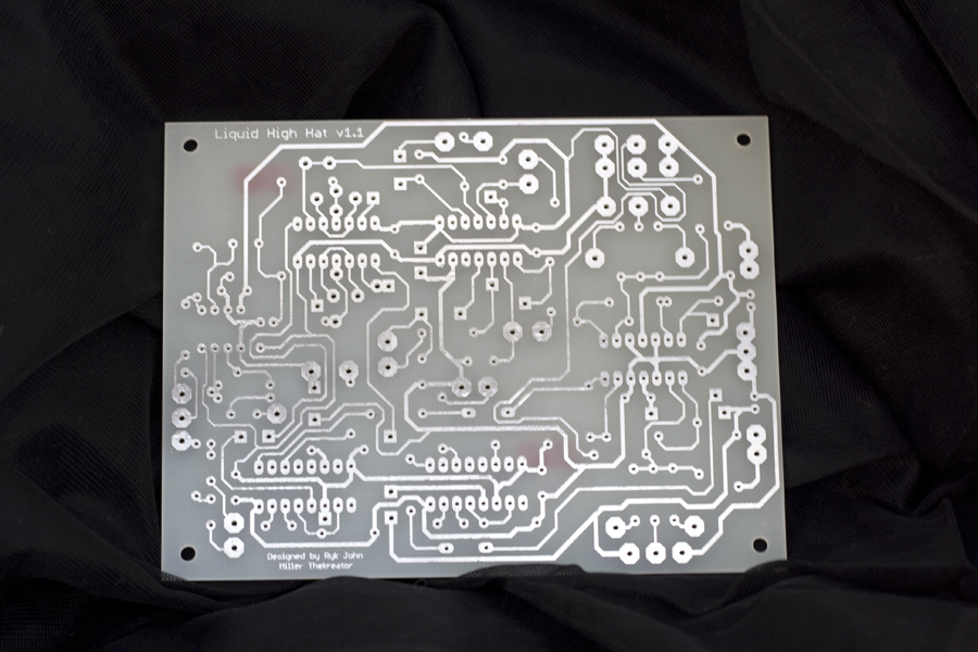

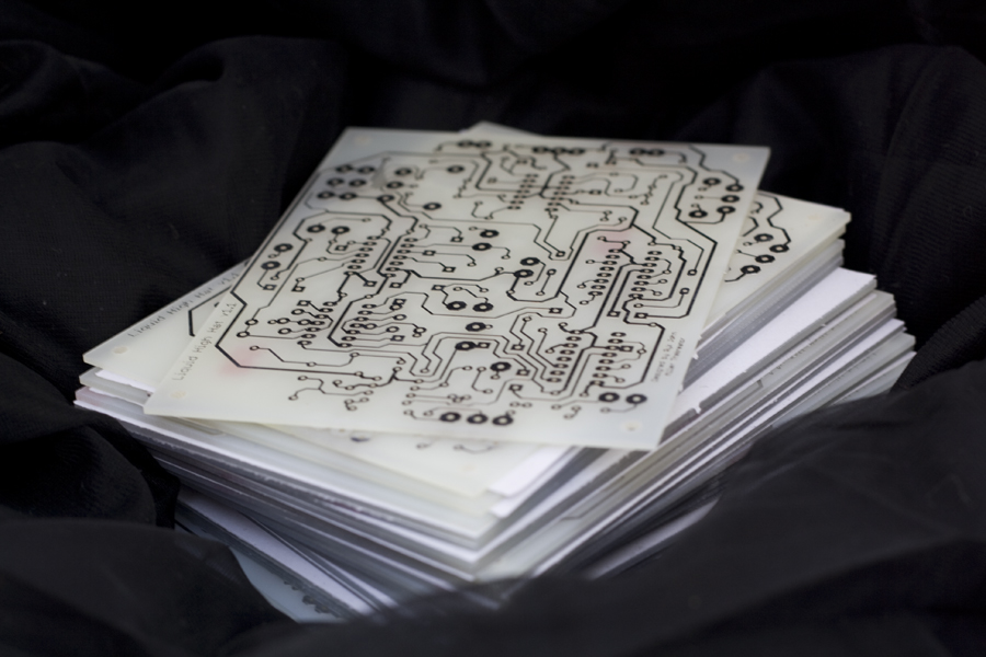

YAY! They're here! And, they look great! (see pics below)
I am going to keep a counter on the front page with how many boards are left and update it as I ship them.
All payments will be taken via PayPal. Price per board is $18.00CAD.
Please mark in the "message to recipient box" or whatever in the paypal order comments with your payment - your EM username, so I can keep track of things! Thanks Smile
I am going to come right out and say this now - I didn't order enough boards. Sad The last few might not get the boards they asked for, unless some people happen to bail out/not pay for the boards they requested.
I am deeply apologetic for this. I did not anticipate the amount of additional boards that would be requested in the time it took for them to be manufactured and delivered. Interest in the thread died down for a bit so I thought people were done requesting pre orders! Argh.
Perhaps a second small run might be in order later down the road...
I will be mailing them out in bunches, and I will make a global notification in this thread each time I get back from the post office having mailed packages out!
(Go to the beginning post for payment information!)
