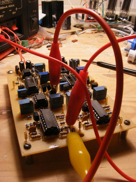

Hi Pantheon,
have built the vca.
The cv side seems to work out correctly,but I have problems in the audio-path.
I tried attenuating the input signal (Wiard Anti-osc/Hertz Donut/Arp-VCO) but it always sounds very distorted and the high freqs are cut off massively. Confused
Have to go thru the circuit once again...
What is the correct mounting-direction of c2 and c4?
- C2 : "+" > right
- C4 : "+" > left
Can you confirm this?
Ah,and please,could you run a saw wave thru your Spice simulation to see if the highs are cut off?
Many thanks and best regards (as always... Wink )
Greg

I had used the vca provided by eric as a basis, so you can look at that for the most part: http://urekarm.tripod.com/synth/jx_vca.pdf.
Yes your cap orientation seems correct.
I have tried a few things in the simulation and yes I also have found that it was cutting off the high-frequencies. Here is what I found:
If you look at Erics VCA, in the feedback loop of the first opamp, there is a [4n7 and 100k] from the output to the negative input. I think this is there to compensate for the High-frequency loss. I stupidly removed that from my schematic for some reason, but when I added it to my simulation the highs arnt as rolled off. You could try adding them in and see if that corrects the problem. I cant think right now why you would be getting such distortion Confused
You can try pulling lower Transistor out entirely, the one with its collector at ground. That would be a little more true to the original MS20 vca.
Let me know if that EQ fix works and then we can see how to tackle the distortion Smile
Thanks for you input Remork, yes it sounds like I should give screen printing a miss for this pannel. I got a little excited and couldnt help myself but to start working on the pannel. I will definately look into transfers for this.
Im looking forward to getting this board etched tommorow.

Hi Pantheon,
vca is working and yes,it`s not a "high-end" sounding one. But that´s MS20,isn`t it? Wink
The distortion-bug was gone after resoldering a wire,my fault... Embarassed
Any idea how to improve the high freqs at 10k and above? I added the 4n7 and a 100k resistor as you suggested and the behavior was much better. Perhaps increasing the value of the 4n7 gives less high cut?

Great news 303, do you have any idea if it has "the ms20 sound"?
I cant think right now of a good way to improve the eq, i'll have a closer look at the ms20 vca from the service manual and see if i notice anything.
Did you try to remove the lower transistor, to see what effect that would have on the sound?

Well... The parts arived today, and the main board has been assembled.
I have completed it about an hour ago, and couldnt resist firing it up before bed. I tested only one of the two vcos, and it looks like I havent made any assembly errors. The wave shapes are fine, lin and exp fm works, the sync also seems to work.
I'll be able to test it much more tommorow, but the initial signs seem good.
There are a few strange artifacts however, such as a marked sensetivity to the presence of my finger near the saw core. Also, the triangle has a slight negative bias too it, and the gain trim doesnt apear to work.
Hopefully I can get on top of these issues tommorow.
But here is a pic of how it looks on my desk just now Smile
 Filesize:  83.01 KB
 Viewed:  342 Time(s)
the8bitpimp.wordpress.com
Sebo
Joined: Apr 27, 2007
Posts: 564
Location: Argentina
PostPosted: Tue Apr 05, 2011 6:47 pm    Post subject: Reply with quote  Mark this post and the followings unread
Great work!!!

brother303
Joined: Nov 02, 2010
Posts: 139
Location: ruhr-area/germany
PostPosted: Wed Apr 06, 2011 5:33 pm    Post subject: Reply with quote  Mark this post and the followings unread
Yummy! Very Happy
Hope,troubleshooting will be successful. Thumbs up!

Pantheon
Joined: Feb 17, 2011
Posts: 36
Location: Edinburgh
PostPosted: Wed Apr 06, 2011 7:06 pm    Post subject: Reply with quote  Mark this post and the followings unread
ok, so i've tested both sides now and they both seem to work almost identicaly which is quite a good sign.
Things of note:
- The triangle symmetry looks nice.
- The gain trim actualy works, it just doesnt have a great amount of range, but its sufficient.
- There is a very slight amount of wobble on the output of each vco (maby 100mv or less), that seems to increases with the presence of my finger by the CA3046 chip. I've had this same wobble on each version of the vco, and I havent been able to get rid of it so far. Does anyone think this will be a problem? Its not audible. I think the best I can hope for is that someone else who makes this vco might be able to figure out whats causing it. It might be present on the MS20 for all I know though.
- The saw still has to be biased a little negative for a good triangle symetry, leading to both the triangle and the saw being offset by around -500mv. I know this can be improved by changing a resistor in the triangle circuit, but its ok for my needs, so I dont think i'll change it, sry Embarassed . I'll point out the resistor when I release the plans.
- Not much else to tell other than I think it sounds realy nice.
So the final thing that I need to do is to etch and test the octave and ring mod board, which I will do tommorow. Assuming that works, I'll post a PDF with the PCB for toner transfer and a small guide on how to tune it in and wire it.
Remember this will be no high end vco, I just want to emphasise that. Though hopefully once it starts getting built by people, some improvements will be suggested. For now, expect something very analoge, warm and with plenty of colour.
