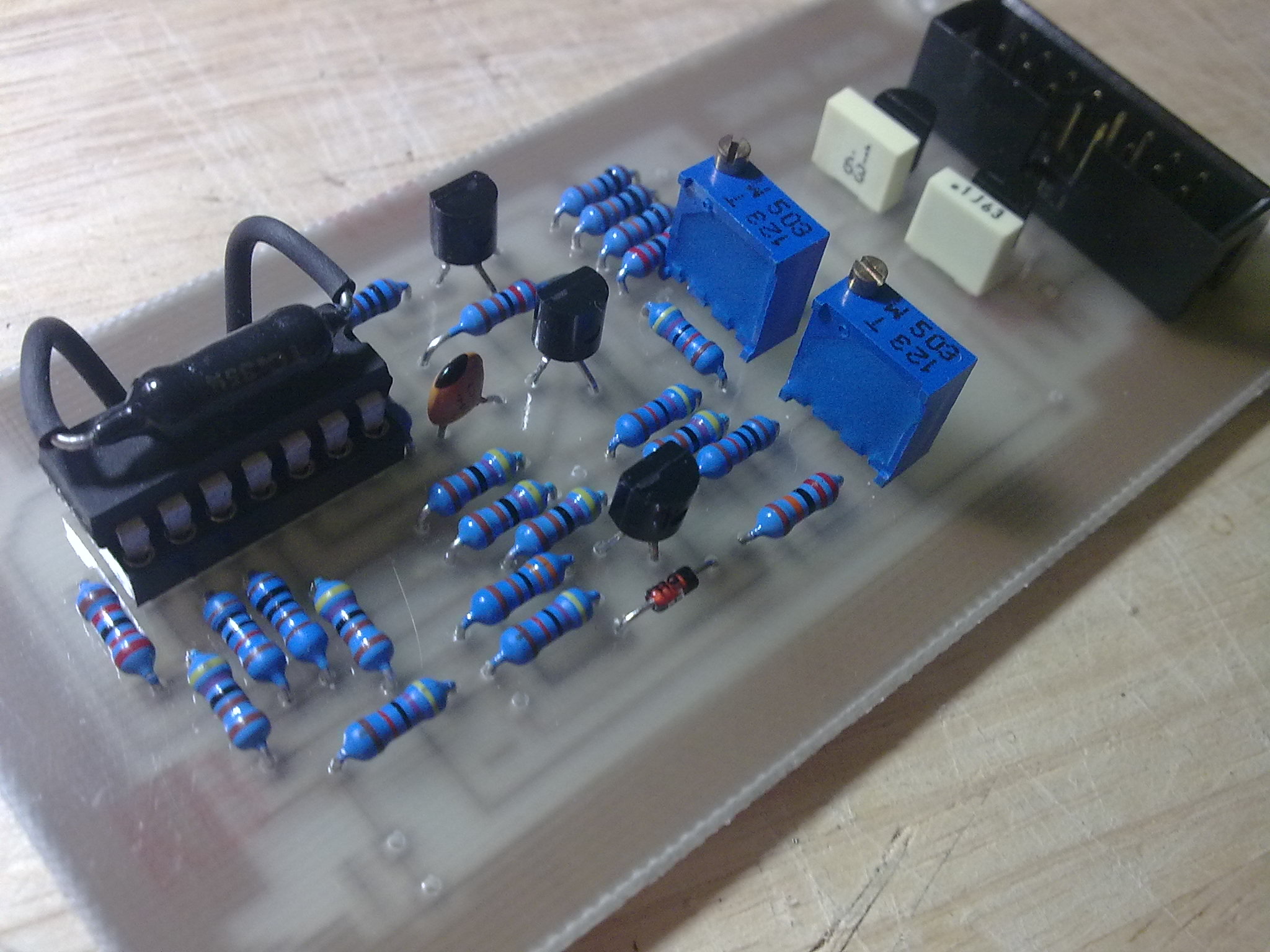

I have just cloned the power isulation by Yusynth VCO http://yusynth.net/Modular/EN/VCO/index.html on the ARP Axxe VCO 3046 clone by EFM http://www.modular.fonik.de/files/EFMforum/orgEFMfiles/3046_VCO.pdf ...I have implemented it to increase the stability and for the use with +/- 15V power supply. I would like to share my little PCB, which is very nice and a much cheaper VCO to simplify the build for all or to help me to find eventually bugs.
VCO3046-mod-15V.pdf
PCB Layout
 Filename:  VCO3046-mod-15V.pdf

PostPosted: Thu Apr 28, 2011 4:16 am    Post subject: The PCB is working
Subject description: +/- 15V mod untested

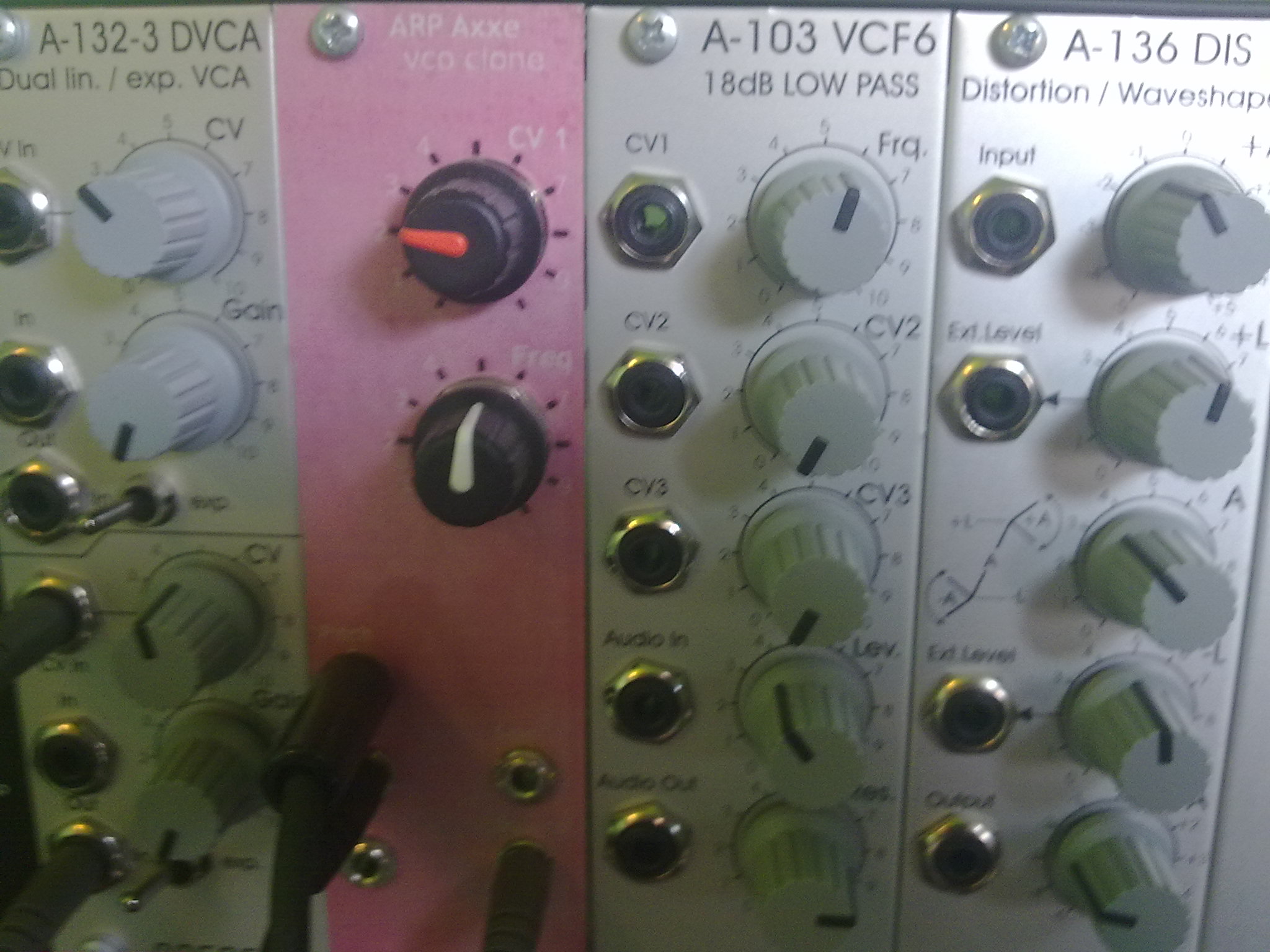

hi vladosh,
I use the version +/- 12V version. The SAW waveform sounds rich and powerful (approximately twice the TB-303-VCO) and fantastic FM modulations. I would like some advice for doing well the +/- 15V version.

furio
Joined: Dec 25, 2009
Posts: 124
Location: Austria
PostPosted: Sun Jun 05, 2011 2:32 am    Post subject: Reply with quote  Mark this post and the followings unread
Hello,
I have tested this PCB, it is very stable, but I can't calibrate the scale.
Maybe for inexperience or some value is wrong...
Hopefully someone would help me to solve this little problem Smile

I have build it, as you stated the square not sound like square (using 12V).
The saw is strong as you said but the top of the saw is cut, don't know why tho...
It is unstable, when trying to tune it with a tuner, I see the the guide line of the tuner is moving all the time.
For scaling trimmer I used 100k instead of 50k for wider range.
I use 1k tempco, didnt have j112 so I used 2n5457, and tried also with 2n5459.
With the 2n5457 I have more range in octaves but when playing with other notes with keyboards the notes are not in tune.
Anyway it's nice but not as stable as you said it is.
I Thank you for the layout, I wish it could work better Confused
Any help with troubleshooting is more then welcome.

Etched this board this week and built it this week. Worked on first startup, but I haven't tried to tune it yet.
Quite a simple build, do think the outputs benefit from a buffer. One of the two outputs is quite a bit softer than the other.
Used a J201 jfet, will need to check the scope to see if how the waveforms look.
Edit:
Had it on the scope tonight, saw output looks great (2.2v p-p), square output is looking more like a ramp wave, very low amplitude (0.3v p-p) and with a big DC component (2v). Needs a bit of tweaking, it seems.

Bought some J112 FETs on eBay, and received them this week. It does seem to make some difference in the shape of the square wave.
Both outputs are now about 2v p-p, but the squarewave output still has a DC component, so I put a capacitor in series with the that output.
Nice VCO, didn't tune it yet, not needed for the noises I am making now.

PostPosted: Sat Mar 02, 2019 1:24 pm    Post subject: Problems
Subject description: fixed voltage on output
Hi, all
I have been using this forum for learning more about modular synthesis and i have built a few bits that i will show in another tread but now i have stumbled upon this axxe clone.
I etched a circuit board and placed all of the components but i cant seem to get it to work.
i also did a test on a proto boeard but same issue there.
Any pointers on what could be wrong or atleast where i should start measuring... i looked so nice and it would be awesome to get this one to work.
