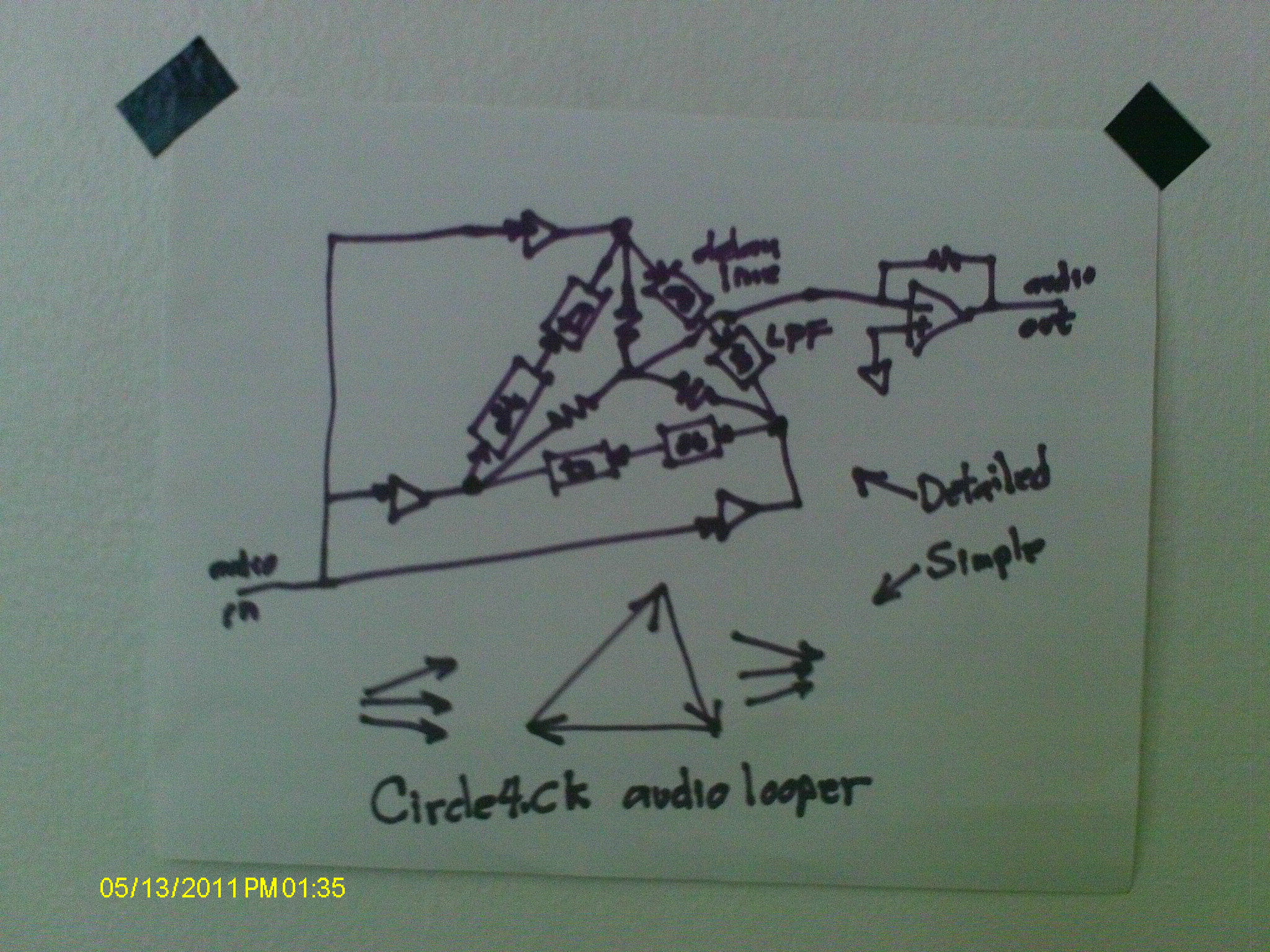

I've gotten back into music and it involves ChucK. I'm remixing audio with loopers made in ChucK.the photo below shows a block diagram of the looper.
I'm trying to mostly create ChucK programs that are implementable in analog circuit form using techniques that I personally am familiar with. That way I can build these things one day if I want to.
This circle looper has a selectable number of delay + filter sections (three is the number selected currently, but i have tried up to 32), arranged in a loop. Input feed points are buffered copies of the audio stream coming in, they loop around, and sum back into the same points where they are drawn out to the output point.
For such a simple circuit, it creates some interesting effects!
