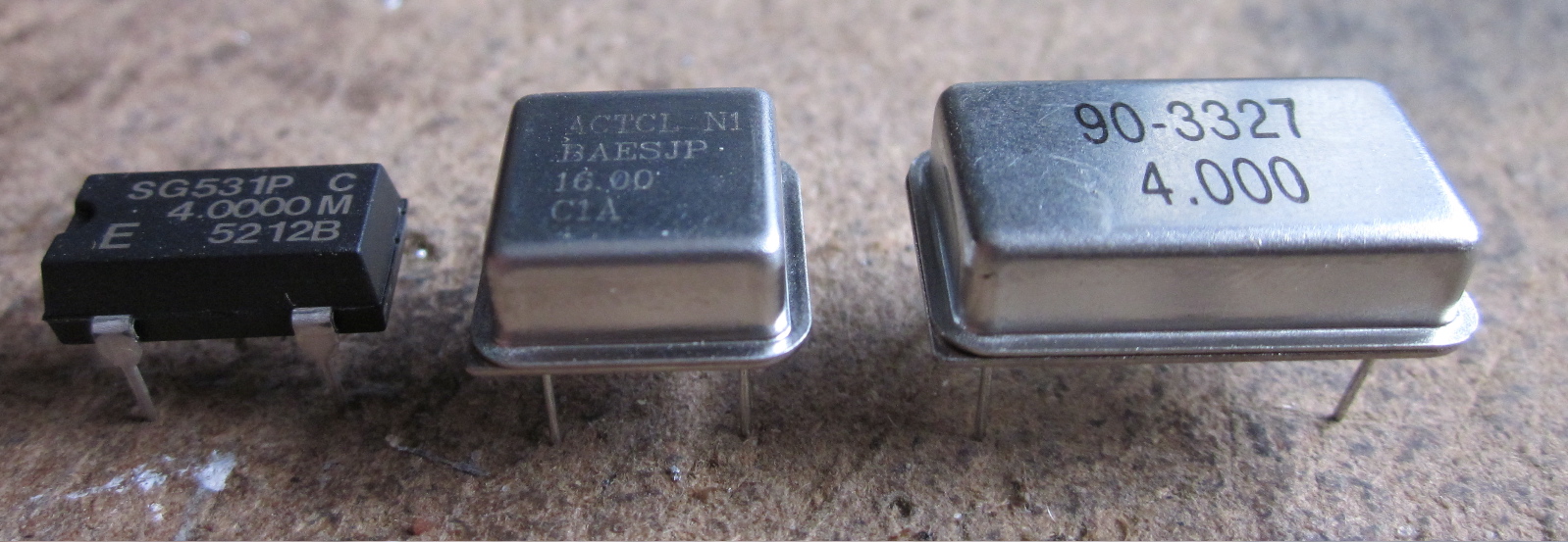

Hi guys.
Hang in there - I'm doing a build guide with pictures - ready soon.
Crystal oscillators are different to 2-pin crystals, which need a small network of components to work. XTAL oscs are a bit easier to use, and keep the parts count down.
On the left in an 8 -pin SPXO package. The middle is a metal can 8-pin, on the right is 14pin. The PCB can take all of these types, but the SPXO is the neatest fit if using an IC socket. (it's also more expensive though.)
Pin 1 is at the bottom left of each one.
The middle one is a 16mHz version which will be tested soon....
stay tuned Wink
(edited to add note about SPXO fit)

PostPosted: Wed Aug 17, 2011 4:51 am    Post subject: Reply with quote  Mark this post and the followings unread
I found this one . It needs to be powered by 5V though. It has 25pf of load capacitance and a frequence stability of 100ppm.
Is that good?
http://tideofsound.net
Dave Kendall
Joined: May 26, 2007
Posts: 421
PostPosted: Wed Aug 17, 2011 5:43 am    Post subject: Reply with quote  Mark this post and the followings unread
Hi.
I can't open the page (my browser is crap) but +5V 4.000mHz is correct.
The UART has a 3% tolerance for speed, so it should be fine. The one I used is an epson SPXO.
