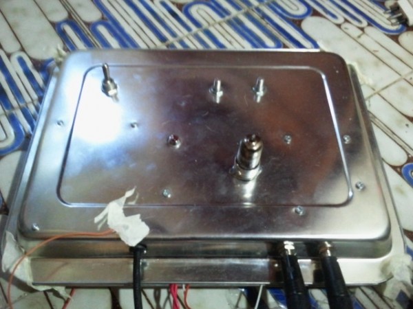

I am building this tube vcf on the CGS site:
http://www.cgs.synth.net/tube/vcf.html
I have the unit almost complete and it is 'semi' working.
I am using a 6CB6 Tube which Mr. Barbour told me was cool, all other parts are exactly what is in the schematic.
As is, the filter mostly acts as an oscillator (a super fat one, by the way).
I like this a lot, but would prefer to have it operate primarily as a filter naturally and when i want the oscillation i would crank up the resonance or flick a switch to alternate caps.
Mr. Barbour says that if the range of the frequency isn't correct, you can "scale" the .01 caps. I have increased the values on these incrementally up to .05. At that point, i cannot get it to oscillate, but the filter isn't really happening. I can hear some sweep, but its not at all strong. At this value i also hear the original signal passed through to the output no matter what frequency is swept.
Check out the audio examples - first one is with the .01 caps, next with 5nf more added in parallel. Third one is 56nf added to the .01s.
My questions are these:
Do i need to also scale the 3rd .01 cap which goes to ground?
I haven't checked tube bias yet, I assume this is critical to do so I will check it out today. Could that account for what i'm getting?
Has anyone built this filter who might be able to post a sound clip as a reference point?
Cheers for any input...

I haven't tried adjusting that cap yet, since I figure I should get the voltages correct first. So, I checked them and here's what I'm seeing:
Plate: 143V
Cathode: 317mv
Grid 1: -88mv
Grid 2: 17v
Do these seem ok? It's a 6CB6 tube.

[quote]Do i need to also scale the 3rd .01 cap which goes to ground?[/quote]
[size=18]YES. You have to scale ALL the capacitors in the feedback circuit together.
If you change 2 of them and not the third, you won't get resonance.
They all have to be the same value.
The bias resistor on the cathode might need to be different for a 6CB6.
Try 2.7k ohms instead of 1.5k.
Do you understand that adjusting the screen-grid voltage will change
the Q or resonance of the filter? And that it also affects the tube bias?
And that changing the bias will change the behaviour?
And that different tubes will behave differently in the same circuit?[/size]

Thank you both for the input and advice, I truly appreciate it.
I upped the cathode resistor to 2.7k.
(Removed extra caps so it's only the .01's)
Fired it up and that really seems to have helped a great deal, i can hear the filtration much better now. I am a little curious what 'lowering' those .01's would sound like instead of raising them (which lessens the depth it seems).
Plate Voltage: 160v
Cathode: 800mv
Grid: -6mv
Grid 2 changes with the Q pot so not tested
