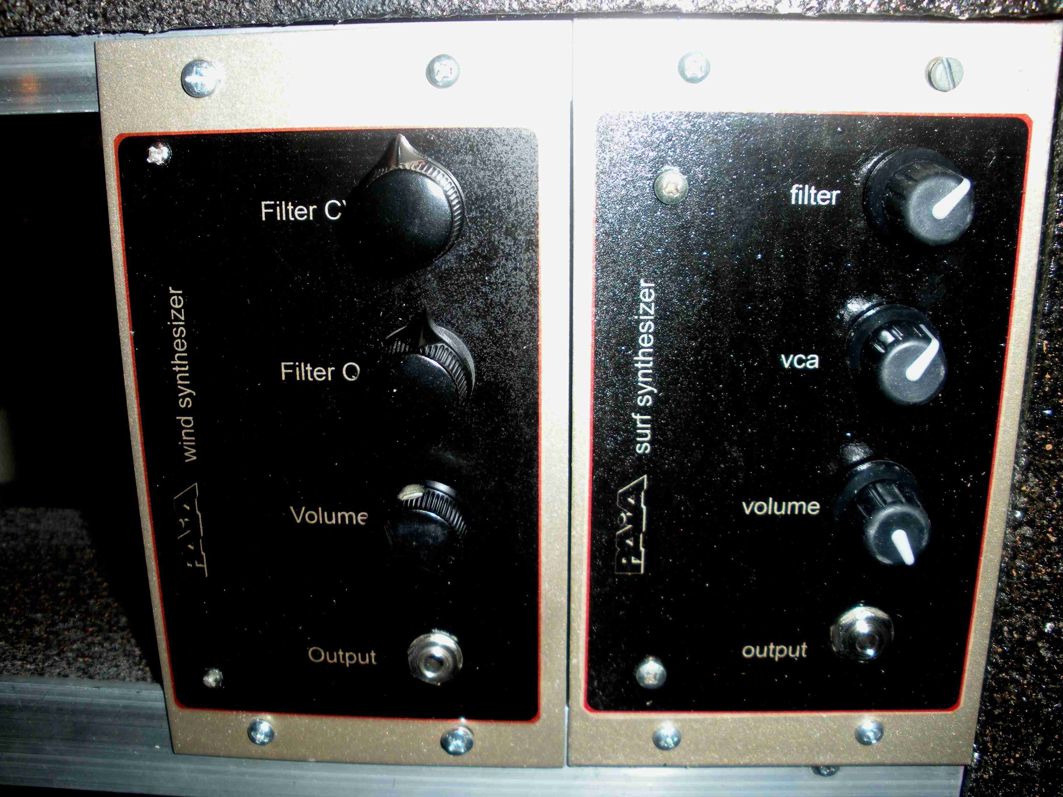

I just finished creating a John Simonton "Wind" using the manual found at PAIATalk. The circuit is so simple, it's best built on perfboard. It's a nice short weekend project. Really cheap too! No chips, just transistors and diodes for semiconductors.
I've mounted it in my homebrew FracRac cabinet with it's sister (brother?) product, the PAIA Surf Synthesizer. This was my very first Synth DIY project built the summer of 1977. This is about my 3rd restoration of it.
The surf synth has the mods suggested in a reader letter from 1972 with the exception of not reversing the filter diode D1. That just leaves the silly thing wide open with no control.
Both units use panel mounted pots instead of trim pots and have a volume pot for mixing.
the audio sample I recorded uses both units set to the extreme.....so it's like a wind storm at the beach. You can obviously dial everything back so it could be a pleasant day at the beach, but that's just not as fun!
Here's my homebrew panels in my homebrew case! (hick!)

I was curious to see the schematic. It was easy to find on PAIAtalk. I can see that Q7 is the noise source, buffered by Q8, into a twin-T filter built around Q9, but I don't quite understand the prupose of D1 and why there are 3 multivibrators also feeding in to the filter at D1.
Do you have a sample without the surf module playing so I can hear what it does on its own?
I could breadboard it, but I have a lot of other projects in the 'todo' pile before I get to this one! Surprised)

D1 acts like a voltage controlled resistor. John Simonton used this technique a number of times.
The 3 multivibrators create a pseudo random CV to the filter. The output wave are ramped squares /---\ but their periods are of varying length so you get different intensities instead of a steady triangle wave modulation which sounds very artificial.
I'll run a surf sample when I get a chance. I was planning on running one channel with surf and one channel with wind so you could separate the two, but I must've forgot to pan the inputs of my mixer before recording.
