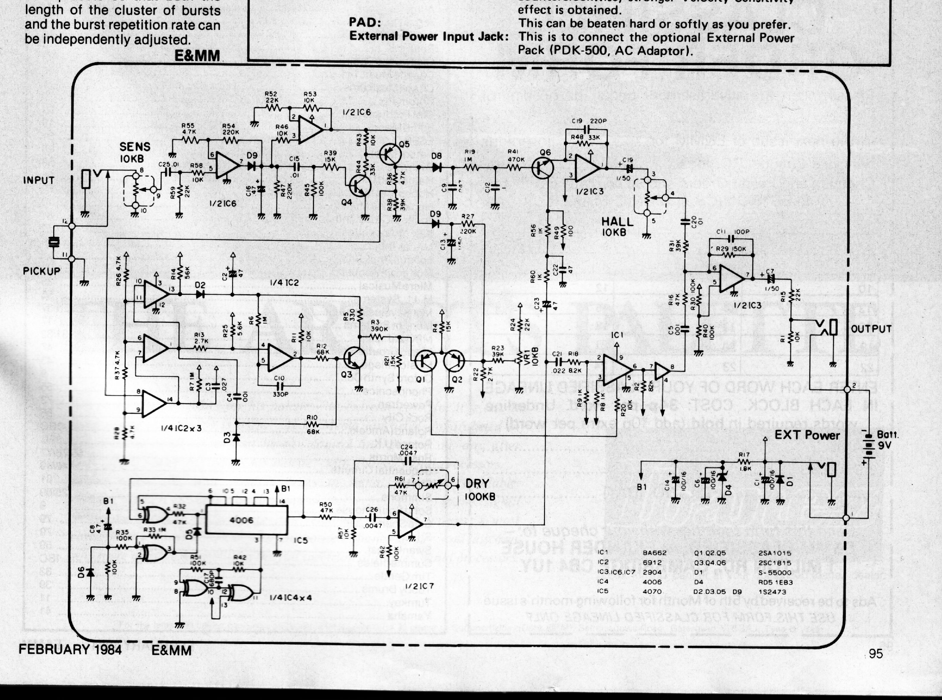

I have seen the schematic for this on electro-music and in other locations on the net, but not pcb layouts. I'm not skilled in doing layouts, has anyone done one...? If so can you share? thanks in advance.

The HC2 is pretty much the same as all the other Roland claps. Sound differences are probably to do with single supply problems and different component values. The schematic out there does include noise , it uses a CD4006 shift register. The schematic that is full of errors so reverse engineering or just using one from the drum machines should be easier. Take note it uses the ba662 so you will need to substitute it with a 6110 or 13700

So, i got inspired to start messing around with my HC2 again. i had previously performed the modifications recommended in this E&MM article-- which definitely helped. But I felt like there's still something wrong with this clap sound. Anyway, i disconnected one of the resistors, R7, that I had earlier changed. I think it's part of the pulse repetition timing. Whatever it was, when I disconnected it, it took out the high pitched clickety-clak sound that was bothering me. Now it sounds like a thick 'clud' clap. I can still hear the multiple triggering sound, but it's darker now; sounds the way it should now-- really great.
I put it through a band pass, and sharp digital delay. It sounds just like a Martin Hannett production.
I don't know if maybe there was something wrong with my HC2 to begin with, because as long as I've had it, the two tone controls, 'Dry' and 'Hall' do extremely close to nothing. I can hardly believe they'd put it on the shelf like that.

I was about to post something moderately interesting about the trimpot in the HC-2. I remembered I had dealt with it to reduce the level, thus letting more 'hall' through in comparison. Before posting I wanted to check it and the trim changed nothing but the level - no 'hall' at all… mmm… then I changed the battery (7.18V) for a newer one (8 something) and hooray, 'hall' ! And the trimpot acts as expected at first. With a wallwart (well over 9V i fear) I could get lots of that 'hall' thing. Conclusion : voltage matters. Still moderately interesting, but perhaps a bit more.
Oh and the 'dry' pot has a noticeable if not radical effect on my unit…

DRY is too small. Try 1M. It controls the Q of that bandpass filter. A mod to try would be to make the resistor to ground (can't read what the schematic says,) at that op amp's input variable for the filter's center freq.
Another thing to try is to make HALL a pot that balances between the two audio paths.

I'm into trying these mods out, I'll report what I find. I'm starting to really like this clap-- it's starting to do what I had always intended it to. But, it could be even more useful with a little bit more control. I don't need or want too much control on a 'drum', but a little variation would be good.

Any other thoughts of the Hall control? Although i can see the usefulness in having a balance control-- I think what the Hall control was intended to do would be most useful here. I think it was effectively like a decay control-- but it doesn't add to, or attentuate the decay on mine at all.
You're referring to R40-- 100K to ground--on leg 5 of IC3?
Here's an extra large image of the schematic, if you please.

ericcoleridge wrote:
No, R57 at the 2 caps around 1/2 IC7, the noise filter. A 100k pot in parallel with that resistor could raise the filter freq. Replacing R57 with 1k in series with a 50k pot could raise or lower the filter freq.
Oh my! That's real easy for these ol' eyeballs! Thanks!
The two sources being a pulse cluster and filtered noise?
Um, they're both filtered noise. The "bottom" path is the cluster; the top is delayed (I think,) and is slightly low pass filtered by C22 so that it sounds a little muffled compared to the cluster.
I think HALL is supposed to control how prominent the fake echo is. You could try decreasing R31 or increasing R48 to give IC3 more gain.
