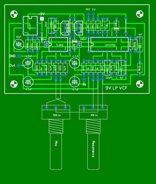

I found the layout, but I'm not sure which file-format you prefer
but here's a gerber file with the layout
(you can use http://www.gerber-viewer.com/ to view and convert it)
and an image which shows the component placements.
I didn't use a TLE2426CLP but made a simple voltage follower with a ua741
(you can use a different opamp for it), I also increased the capacitor size in
the audio path. (from 2.2uF to 4.7uF). the frequency potentiometer is
connected to the pad marked pot (that makes sense I think) and there's an
extra pad for an external control voltage, I also added some protection
diodes (labeled BAT). use some schottky diodes for these like BAT85.

tokyomatik
Joined: Jan 20, 2011
Posts: 171
Location: berlin
Audio files: 6
PostPosted: Sun Mar 11, 2012 8:17 pm    Post subject: Reply with quote  Mark this post and the followings unread
hey phobos thanks a lot!
that layout looks is for sure less scary than wiring on perfboard
i'll try to etch a board soon as possible

I have etched and populated one of this pcb but the filter doesn't work...??
it is powered with a 9v psu and I checked the voltage at the ICs the UA741 and TLC22062 are ok from my point of view with aproximately 8.8v
but if I check at the 100nF capacitor that is right before pin 11 of the 13700 the voltage is also 8.8v but directly on the pin I have 4.4v, is that ok?
should i try to replace the ics?

PostPosted: Sat Apr 04, 2015 8:56 am    Post subject: Reply with quote  Mark this post and the followings unread
basicly only the Mix pot is working....mumbling Shocked
ics also replaced....same...

do you have a pot connected to set the frequency or an external CV source ?
It looks like the original PDF is removed but I should
have it somewhere floating around on a harddrive.
Will see if I can locate it later.

PostPosted: Sat Apr 04, 2015 10:37 am    Post subject: Reply with quote  Mark this post and the followings unread
i have all the pots for freq, mix and resonance connected, all 10k
Posts: 5881
PostPosted: Sat Apr 04, 2015 12:22 pm    Post subject: Reply with quote  Mark this post and the followings unread
I located the PDF and the filter I build so I will measure some voltages.
do you get any sound out when the mix pot is turned to the filter ?

PostPosted: Sat Apr 04, 2015 12:54 pm    Post subject: Reply with quote  Mark this post and the followings unread
the sound is coming out nicely but unfiltered....
