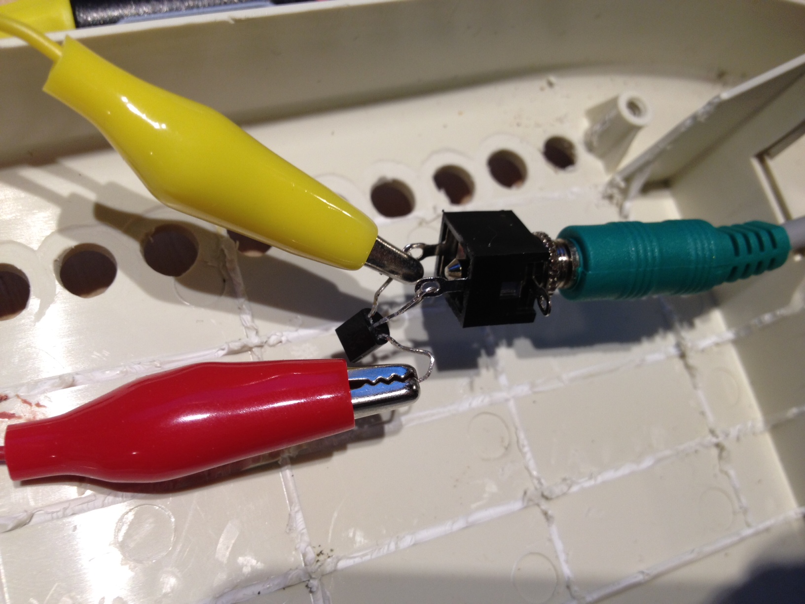

Quick overview. I have a Suzuki Omnichord that I'd love to retrofit for CV triggers for all the buttons. My plan is to do all of the strum pad and all of the chord bank, so it's 25+ triggers.
So i'm starting slowly with the strum pad.
The strum pad connects to a 16 pin header, 1 is a common "ground", shorting 14 of the pins to this plays that note of the strum section, you can connect more than 1 pin at a time and it plays both notes. The 15th pin is the sound kill switch.
My play was to use the transistor as a switch method. So put 14 jacks on wired to transistors so that a trigger pulse generated by my modular synth would act like a switch and short the pin to the common.
Last night I started trying out my plan, and I can get 1 note to work using the below layout (please excuse my scary test setup, the final thing will be soldered and pretty looking).
I can get trigger to generate a note - hooray!
The issue I'm having is if I try and hook up two using the same format, and I connect the common "ground". I now get 2 notes for every trigger into either jack.
I'm almost wondering if I have my ground backwards. Or my transistor backwards.
Two attachments below show the trany setup and the corresponding header connections. Yellow is the common connection.
In the first image my transistor is wired up I have the transistor wired up flat side up if it's not too clear, which means the pins are from bottom to top:
E, B, C.

OK, small update. I think I found one issue. The single pin isn't common ground, that's the single "voltage source" the 13 notes pins are the common ground.
It seems if you pipe anything from 5-12v (12v is about what the omnichord pipes in) into any of these 13 pins you get a note.
<warning>
So I can actually take the trigger from the jack, ground to common ground (like the ground on the speaker), hot terminal straight into one of these pins, no need for transistors or any of that complex stuff.
I'm completely confused how to do this with transistors now. Just watched a bunch of YT videos on them, apparently the resistor is needed so you don't blow the transistor (ho hum).
Running triggers straight into an omnichord, do I run the risk of blowing up my eurorack? Should I stick a diode in there to stop voltages coming back up the pipe?
<end>
I still need to do some sort of trigger voltage switching as I just tested the chord switches and they only have 2volts going through them, and it's a lot of connecting point a with point b and point c with point a and point d with point e, etc.
So i still need to either get my head round transistors or maybe look at optoisolators?

PostPosted: Mon Mar 19, 2012 2:28 pm    Post subject: Reply with quote  Mark this post and the followings unread
Thanks - I understand now - I assumed you were trying to go the other direction.
So for the strum bar it sounds like it might be as simple a rigging a small value of resistor and a diode on each pin. The cathode point toward the omnichord and the anode toward your synth. I would suggest trying that on one or two pins and see how it works. If it seems ok, go for the rest of them.
That chord section sounds like it will require some work though. I'm a bit hampered by my complete lack of knowledge of how the omnichord gets things done. Have you run across a schematic of it ?
Gary
nomeist
Joined: Mar 19, 2012
Posts: 5
Location: NJ
PostPosted: Mon Mar 19, 2012 2:33 pm    Post subject: Reply with quote  Mark this post and the followings unread
Nope haven't been able to find a schematic.
The chord and the strum sections are really very basic. They both use (for want of a better term) simple momentary switches. For the chords they really are momentary push buttons, if you short two points on the circuit at the base of them the chord changes.
Strum is a little more complex, but still just a basic short (common voltage to 1 of 14 "grounds" - no idea if those terms make sense).
Right now I have a working bread boared and multi transistor CV controlled LED's. So I'm using that as my starting point. Just now apply it to both situations on the omnichord and see if I can get it to work.

It lives !!!
Now time to put 12 of these on perfboard. Damit Transistors are a pain on perf, especially if you need access to the middle leg.
