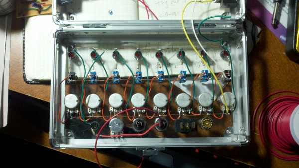

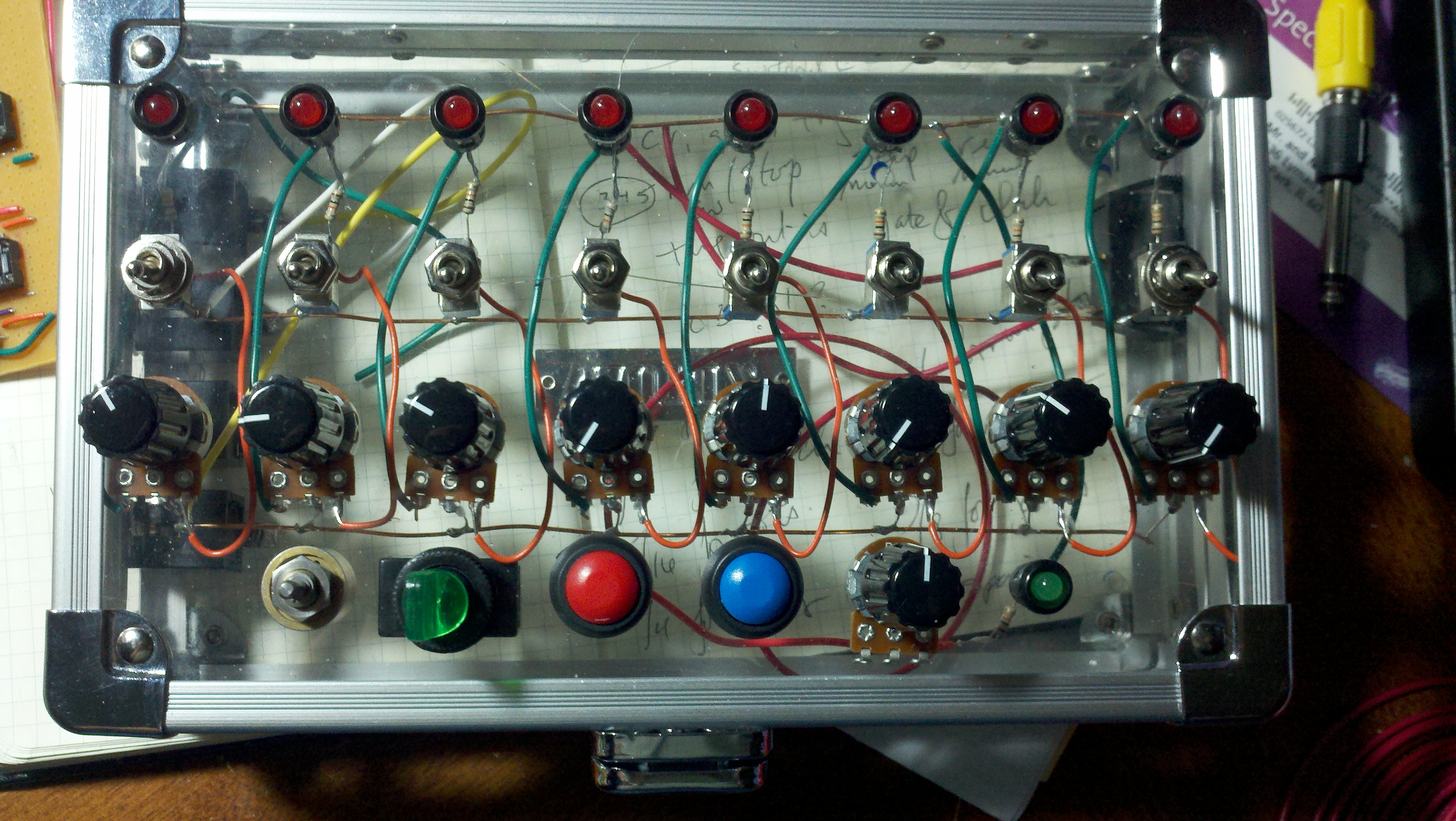

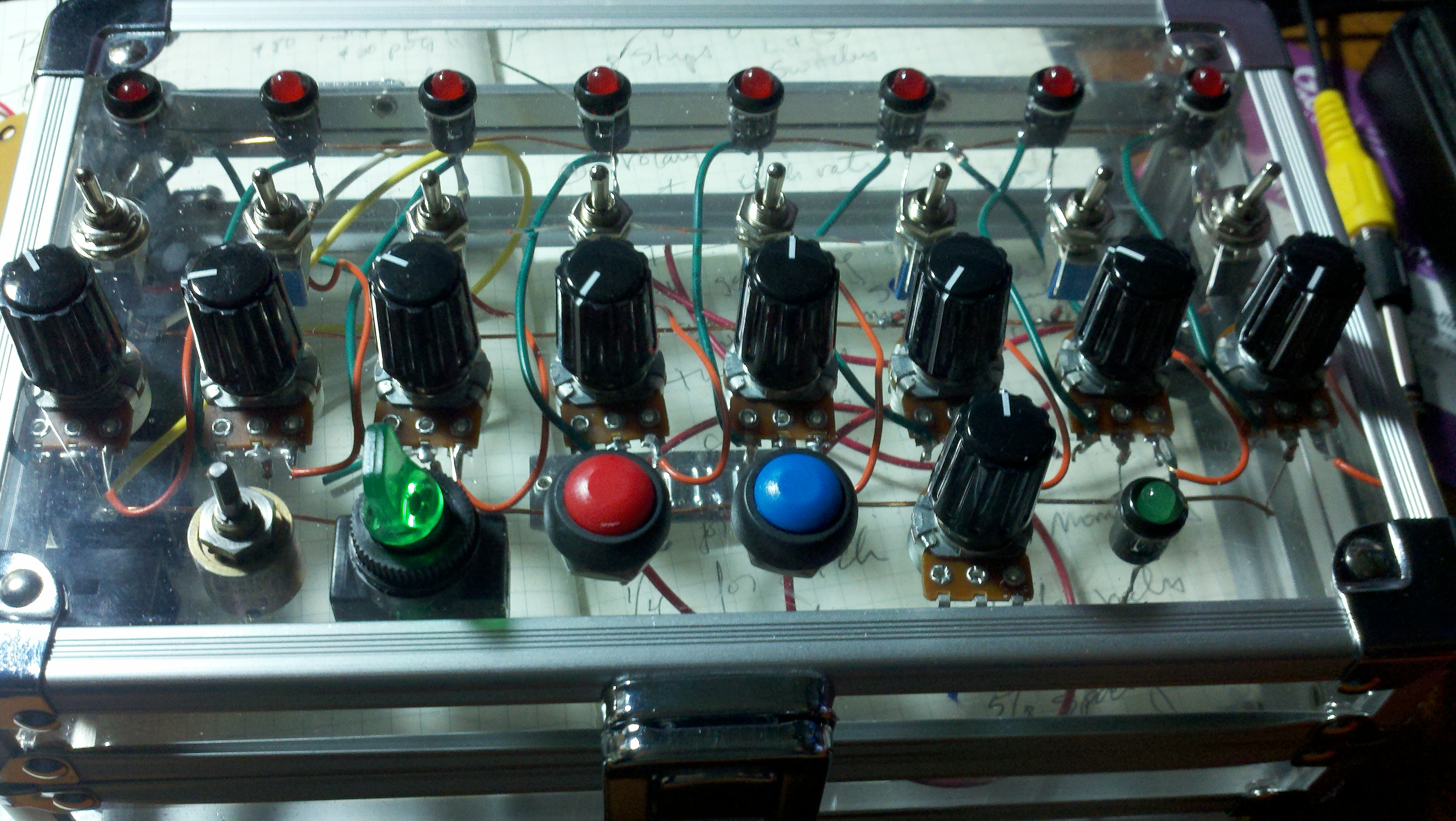

PostPosted: Sat Dec 29, 2012 5:37 pm    Post subject: Question about functionality Reply with quote  Mark this post and the followings unread
Sorry if this is an old thread.
I've built this sequencer as practice before I start on a 16-step design from MFOS. I wanted to be sure that the CV in on my Moog Rogue was functioning properly before undertaking a larger, more costly project.
So, the sequencer is built, the LEDs light in sequence and respond to adjustments on the timer. When I connect it to the Moog Rogue, the sequencer functions as normal as long as the next step in the sequence is a higher voltage, and on reset the sequence repeats with a higher baseline voltage. If the next step(s) in the sequence are a lower voltage, then the pitch will slowly glide down, but not nearly as fast or far as it should. Basically the Moog is acting like it's storing a charge from each step, thus increasing it's ground/reference voltage, and not resetting at each subsequent step.
I haven't had a chance to look at the sequencer's output on an oscilloscope yet, but my analog voltmeter responds as expected to the sequencer. Also, I connected a variable power supply to the Moog's CV in to verify that quick changes to the CV produce the expected pitch changes, and they do whether increasing or decreasing the voltage.
I'm puzzled by these observations. The sequencer and Moog seem to be functioning properly when used separately, but used together they do not.
Does anyone have any ideas of what may be going on? Or to those of you who have built this design, is this just a design flaw?
PostPosted: Sat Dec 29, 2012 7:22 pm    Post subject: Reply with quote  Mark this post and the followings unread
Definitely sounds like you have some noticeable capacitance somewhere in there.
I would be interested in
1) does it do the same thing controlling any other CV controlled device (if you have another around)
2) do you have any other source of CV to test with the Moog?
I've built this stripboard, but I want to put it into an enclosure that I haven't tried before so I've been working on other projects before completing this one.
enigmatrix
Joined: Dec 29, 2012
Posts: 3
Location: Asheville, NC
PostPosted: Sun Dec 30, 2012 8:56 am    Post subject: Reply with quote  Mark this post and the followings unread
The only other CV device I have is an analog voltmeter, which exhibits the expected behavior (sequencer seems to work as intended.)
I've used a variable power supply with the Moog. The result was snappy pitch response, nothing erratic or unexpected there.
Both devices seem to work alone, but not when used together.

Here's my crack at the enclosure for this stripboard, still in progress...
(ha ha notice the crack in the top if you look closely....)
I have added switches for gate, all the various optional pieces, and a quad AND chip to take gate and clock and generate a trigger of sorts. Going to take a clock out too just for completeness sake (since 4 jacks fit reasonably well along the side)
 Filesize:  2.21 MB
 Viewed:  1337 Time(s)
 Filesize:  2.13 MB
 Viewed:  1086 Time(s)
 Filesize:  2.07 MB
 Viewed:  1428 Time(s)
PostPosted: Sat Jan 05, 2013 12:04 am    Post subject: Reply with quote  Mark this post and the followings unread
Done wiring, but not working entirely. Will post video when it's uploaded/processed, but I'm having some issues with it. I've tried some mods to help, but they haven't really. Going to brain dump in case someone sees something that helps resolve the remaining problems....
So mods:
0) Did all the optional mods minus listed, pluse the switches for gate out as mentioned before
1) added clock/gate AND (with a 4081) to get a trigger out
2) ran a 47k resistor from 4017 reset to ground so it wasn't floating
3) ran a 10nF cap from 555 pin 5 to ground, per usual 555 circuits
4) Adjusted the component values; set the timing cap to 2.2uF and "R2" to 5k instead of 10k, so I could get things a little slower to my liking
5) ran the clock pulse through a 2N3904 inverter--this helps with #1 and also let's me send a clock out as well (so I could conceivably make this a clock source for some other simple project). Basically instead of being high all the time with downward pulses, it's the other way round. The 4017 doesn't care of course, but other things do.
Originally I just bolted the stripboard right up against the clear plastic (polycarbonate??) in this pencil box, but that seemed to make things REALLY unreliable, so I have used nuts as standoffs to get it just off the plastic. I don't have bolts long enough to get higher up, nor clearance above the board.
Even being more reliable, I still double/triple hit some notes and eventually get hung up on one. Most often this seems to be happening on step 5, but it is not always. Physically banging the box almost always resolves it, now that I have the PCB up off the plastic.
I don't think I have any lose bits of junk running around, and if I did I'd expect the banging to change the symptom entirely instead of ending up hanging in the same place (as I say, most of the time anyway).
Anyone have any ideas? I'm going to go over it more carefully tomorrow.
BTW earlier I had one of those moments: that sinking feeling when you realize you just wired your reset rotary backwards....
