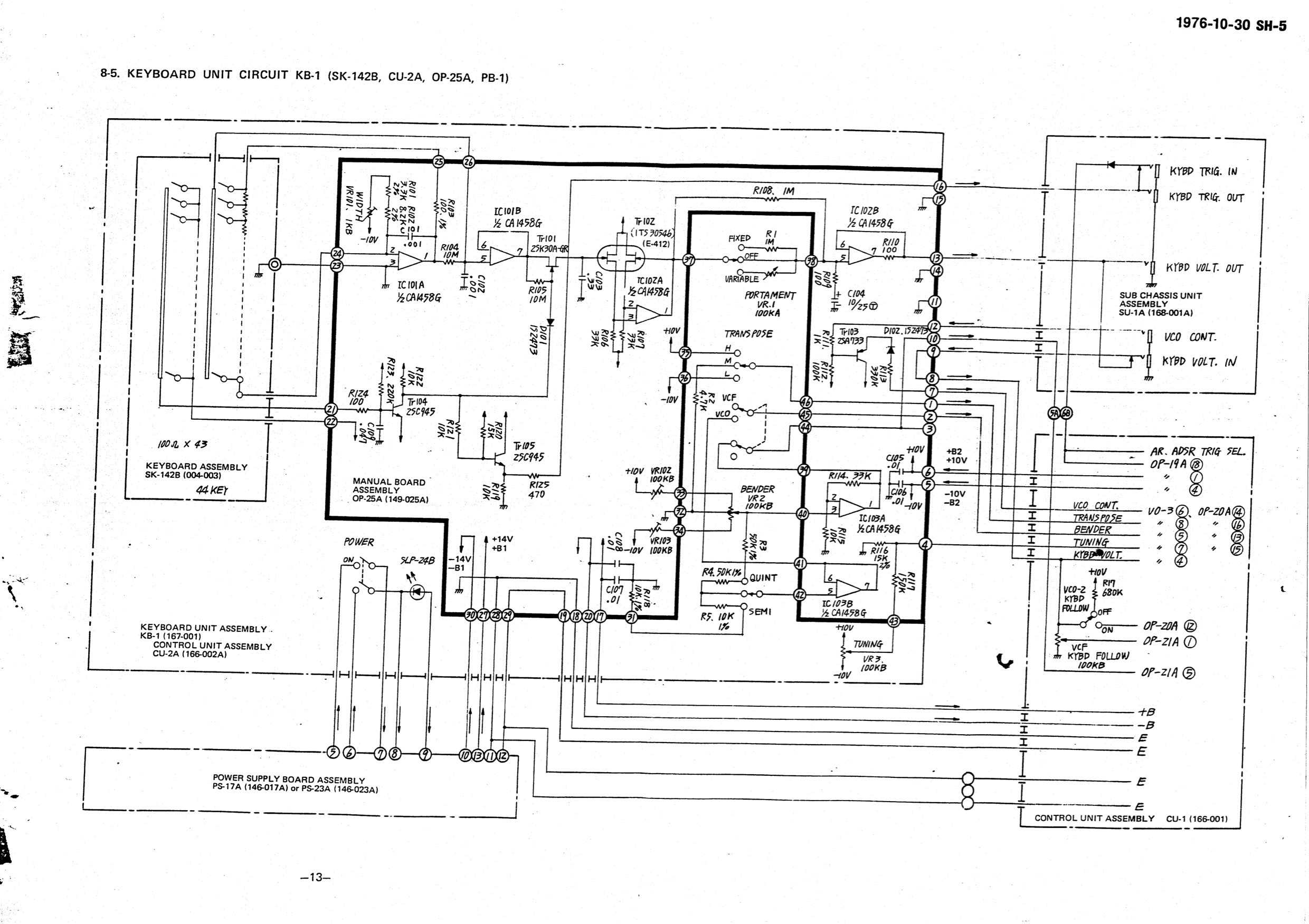

Hello, my roland sh5 seems to drift (frequency),when I use the hold or sustain function. If I keep a keyboard note held down, drift does not occur. I have looked at schem, but a little confused as the hold and sustain/decay knobs are on different pcbs. I know first off to check voltages from the power pcb. But can't get my head around where to check voltage for the after key hold hold function. Any help appreciated. Thanks

I'd try replacing C103 in the keyboard circuit unit. (page 13 of the service manual).
If this doesn't fix it check pin 1 of IC102 on the same board. If the voltage is drooping there I'd replace the FET pair and op amp with a low bias input FET op amp.

I've been followng this thread to see what you come up with but I feel I should pipe up now, if the voltage is increasing then the hold cap is getting voltage from somewhere. What op amp is it connected to? I assume it is connected to an op amp wired up as a voltage follower, or perhapsc some sort of dedicated analogue buffer?
9 volts
Joined: Jul 15, 2012
Posts: 28
Location: Au
PostPosted: Tue Aug 28, 2012 5:24 am    Post subject: Reply with quote  Mark this post and the followings unread
A ca1458 (1c101B) then a 2sk30a (tr101) then the hold capacitor. I have just done a few more tests. The voltage coming out of the ca1458/into the 2sk30a is constant, the voltage leaving the 2sk30a is not (everything beyond this point rises etc). I'm thinking it's probably worth trying a 2sk30a replacement.
(B+ and- and 10- and+ at the entry point on this board have been tested and are ok).
Thanks for getting back to me.
My basic understanding is that the 2sk30a should lock the voltage?
JingleJoe
Joined: Nov 10, 2011
Posts: 878
Location: Lancashire, England
PostPosted: Tue Aug 28, 2012 11:08 am    Post subject: Reply with quote  Mark this post and the followings unread
The transistor in question (or perhaps FET) charges or discharges the capacitor to the voltage coming from the keyboard. However your layout description makes mea little dubious.
The op amp, which I suspected might be a CA series op amp, is a probably high impedance buffer AKA voltage follower which can output the same voltage as the capacitor, without discharging it. However from the datasheet it looks like the input impedance is a bit low for that sort of application. The CA3140 is a good high impedance input op amp.

Yes this is the page I'm referring to

There's a good chance the problem could be the buffer consisting of TR102 and IC102A. Since you probably can't a replacement for TR102 easily I'd suggest carefully removing it and IC102 and replacing IC102 with a low bias input, low offset FET dual op amp.
Remove R106 and R107.
Leave out TR102.
Join gate-source pads of both FET's. (ie:C103 will go to pin 3 of the op amp, join pin 1 and 2 of the op amp).
If you put a socket in for the op amp you could try the TL072. The TL072BC actually has better offset voltage specs than the CA1458. The OPA2134 would be better, and there would be even better choices than that. You want the lowest input bias possible so as not to drag down the S&H cap voltage. This was the reason for having the dual FET there.

I reckon voltage may be leaking in from that FET pair (TR102) However I am also wondering what the voltage is like on the gate of TR101, Personally I'd like to probe that. D101 will keep it low or negative but if that diode is faulty it could be turning on TR101 when it shouldn't and allowing in some stray voltages, so I'd also like to probe the output of IC101B and see what's happening there. I know you mentioned it's output voltage is constant but what is it constantly? positive? negative? 5 volts? 0.5 volts?

I've just done a few more voltage tests. By constant voltage I meant stable (does not drift).
ic101
pin1 = 3.66
pin2 = 0
pin3 = 0
pin 5 = 1.29
pin6&7 = 2.65
fet (tr101)
gate (from diode 101) = -13.57
source (from ic 101 pin7) 2.65 (influenced by note on then returns to 2.65 after note released)
diode 101
-13.94 (when note is pushed becomes 13.94)
-13.57 (to gate)
Thanks again

Just a quick note to say I tried the mentioned rewiring tonight (got rid of tr102 etc) and it has fixed the problem! Thanks to everyone for your advice! It now losses about .01v per 1.30 mins which seems alot more like the kind of behaviour i would expect (slow droop). I may experiment with cap size while I have the synth pulled apart. Thanks again there is no way I could have done this without your help!
