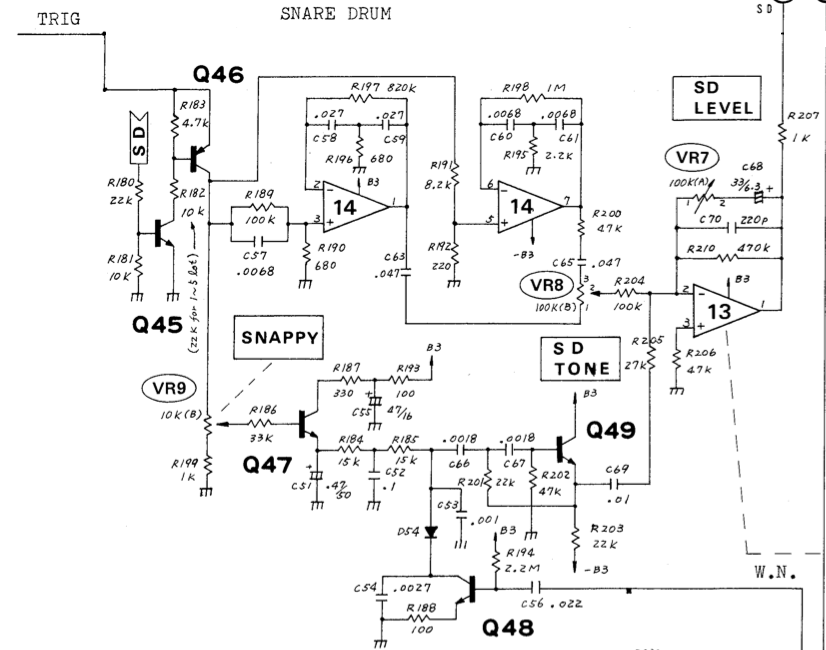

Hi everyone ! And many thanks to you minus ! You have made my months ! Everything works perfectly and sounds awesome !
I only have a little issue with the snare module, it works great but there's a constant HF, i'm sure the noise leaks, any idea how to fix it ? By changing the noise pot maybe ?
Cheers, and you have my eternal gratitude
PostPosted: Thu Jan 14, 2016 10:53 pm    Post subject: Reply with quote  Mark this post and the followings unread
How are things wired up? Maybe you need shielded wire from the output to the jack?
lysergist
Joined: Jan 14, 2016
Posts: 36
PostPosted: Fri Jan 15, 2016 7:02 am    Post subject: Reply with quote  Mark this post and the followings unread
Mhh it doesn't comes from the jack, other modules are clean with the same jack, it's not a ground loop. What i here is a constant noise coming from the snare. It's weak but enough to disturb me, it's a bit noisy. I think there's something to adjust in the noise part, the pot is ok so maybe some resistors in the noise part circuit.
PostPosted: Fri Jan 15, 2016 7:07 am    Post subject: Reply with quote  Mark this post and the followings unread
I'm talking about the output jack. Perhaps the noise generation is inducing noise on the output wiring that you're picking up as you feed the output signal further downstream.
Obviously it's not "The jack", but the wiring could be -- if you shield the connection you can rule it out.
Also, stripboard uses lots of long parallel runs, you should check where the noise signal runs through the stripboard and what other traces are nearby and could be inductively coupled.
If you're hearing it constantly, even when there are no triggers, it will have to be somewhere after the "vca" section though. That's why I jump to the wiring to the output jack.
PostPosted: Fri Jan 15, 2016 7:59 am    Post subject: Reply with quote  Mark this post and the followings unread
So, here's the schematic for the snare. Obviously the standalone stripboard has its own white noise generation as well, that comes into this circuit in the lower right and into the base of Q48.
If you have the level (VR7) *all the way down* and you're still getting the noise generator's output, then you're likely getting inductive coupling between the trace that goes from the white noise to Q48 and the trace that goes from the op amp tot he 1K resistor and out to the wiring going to the jack.
Question: does the snappy control affect the sound of the bleed in the output? If so, then it's not that initial trace, but some other trace within that "snappy" section in the bottom center.
I don't see the SD stripboard in this thread, so I don't know which one you're working from to speculate further. I've never had a lot of luck finding old stuff on these forums, even when I know it's out there somewhere. My own SD that I mentioned above in this thread was built on protoboard rather than stripboard, straight from the schematic.
As noted, I think your best first option is to get some shielded wire, ground the shield (on one end only) and run that in place of whatever wire you have running from the board to the jack. After that, you need to actually look at how things are routed on the stripboard.

So the noise path does not appear to run particularly close to the output path, BUT both the output op amp and the noise op amp are on the same chip, IC2, so that could be relevant.
C21 and C22 are the decoupling caps for that chips power supply, you might want to make sure they've got good solder joints. Measure the power supply pins and see if you are getting any extra noise there, and possibly increase the size of those two?
I'm still going to bet on the shielded wire though Very Happy

Hahaha ok i've just spotted something. I'm so stupid. The constant noise is normal i think, i worked with the level pot (the volume, not the noise) all the way up. The output volume was low. I did it for compensate the low volume caused by the low trigger. I've a beatstep pro wich triggers almost everything. All the other modules are well triggered. But it seems that in this case the snare needs higher voltage to works correctly. With higher trigger, i've to lower the volume, and the noise problem disapears. So stupid... Sorry haha. In fact there's only one problem, the triggering. So maybe i have to change a resistor in the trigger part.
PostPosted: Fri Jan 15, 2016 10:28 am    Post subject: Reply with quote  Mark this post and the followings unread
No need to apologize Smile
The original circuit expects a 4V -> 14V level on the accent input.
What are you putting into that? How do you have the trigger and accent hooked up when you're using the BSP?
Edit:
the BSP is supposed to send 10V gates which should be plenty high, but you might check the width of the trigger as well. Original circuit expects 1ms triggers on the accent input and wider than that for the "trigger" input. (Long story, ask if you like Smile )
lysergist
Posts: 36
PostPosted: Fri Jan 15, 2016 11:20 am    Post subject: Reply with quote  Mark this post and the followings unread
Well, after few hours... A 220ohm instead of 10K in the trigger section... LOL.
Everything works fine now.
I've found some differences between the original version and Eric Archer's one, I thought TRIG and ACCENT were inverted.
PostPosted: Fri Jan 15, 2016 3:58 pm    Post subject: Reply with quote  Mark this post and the followings unread
That's an artifact of that long story....
The way the original worked, the sequencer itself was done by a microprocessor.
There was a common trigger bus that went to all voices all the time. This is the "TRIG" input you see in the picture I posted. The trigger was 1) 1ms wide and 2) varying height, depending on the setting of accent for the given clock step. If accent was not active it was 4V or so. If it was active, it would vary from there up to 14V. How much it varied was set by the accent level pot.
So then you ask: why don't all the voices sound every single time?
Because there was a second input that was basically a "gate" for the voice. If you look at that schematic again, if the SD input is 0, then the NPN connected to it is off, and when the trigger comes through, there's no where for the voltage to flow. If it's on, then that transistor conducts, and the trigger comes in and effectively goes through a voltage divider that turns on the PNP transistor and actually injects the trigger into the voice.
So in the normal course of things, if the snare was to fire on "this step", the microprocessor would raise the gate for the snare, then generate the common trigger with it's accent level, then lower the gate.
When Eric Archer adapted the circuits for standalone voices, I think he felt it was more straightforward to make the accent a "level" input to the voice, and use a trigger in place of the gate. And in most cases that works just fine. On my own standalone 808 BD module I have normalled the trigger to the accent, but I could just as well have put it on the wiper of a pot doing voltage division.
I could definitely see how having a 220 in place of that 10K would be a problem Very Happy.

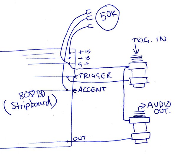

I admire your knowledge ! Thanks for helping ! Yes i've seen this way to do it.
 Filesize:  65.94 KB
 Viewed:  20890 Time(s)
PostPosted: Mon Jan 18, 2016 9:53 pm    Post subject: Reply with quote  Mark this post and the followings unread
That should work fine.... though you may want to put an additional resistor between the 50K and ground. Back of the envelope suggests about 15K should put the bottom side of the pot at 4V, which was the minimum the original circuit expected to be at the accent point.
Also, I don't think the stripboard layout you're working from has it, but you'll notice that Eric Archer's version also puts a gate -> trigger converter on the front end of the trigger input, to be sure that is just a pulse rather than a possibly extended gate (which won't respond the way you expect). If you're tying accent to a steady voltage, I think that's a good idea to do as well.
I thought your attachment looked familiar, it was my 808 trigger wiring sketch form 2009...
http://electro-music.com/forum/post-275530.html#275530
