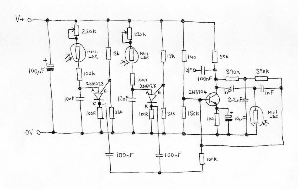

This circuit came about while I was thinking about buzby's stripboard challenge:
http://electro-music.com/forum/topic-55837.html
I never did think of any great ideas (which would fit on 5 x 6 holes piece of stripboard), but it did start me playing with PUT oscillators, as you only need a single PUT to make one. What I did eventually produce (only on the breadboard at the moment) was the circuit below. Because the PUT oscillators produce very narrow spikes, the sound is a bit whiny and rather cat-like. To enhance the cattiness, I mixed the output of two PUT oscillators and passed the output into a twin T filter. The frequencies of all 3 parts are controlled by LDRs, so by waving your hands over it, you can get quite annoyingly accurate cat-like sounds. The two pots (actually presets on the breadboard) are only there for fine tuning and are not strictly necessary. I built it for a 12V supply, but it does work on a 9V battery.
I've put it here just out of interest, as it may (or may not) inspire someone to come up with a more musical effect.
Gary
P.S. I know it's not strictly a lunetta, but you could use CMOS oscillators in place of the PUTs, if you wanted to (but would it be as catty?).

P.S. nice circuit, it would be good to learn more about thyristors (that is what PUT stands for isnt it?) but I don't think it's lunetta! Surprised It's too analogue!

It's a Programmable Unijunction Transistor, but yes, it's very similar in structure to a thyristor, with 4 layers P-N-P-N. They were often used in thyristor/triac circuits as a trigger generator (instead of a diac). Yes, I know it's very analogue, so not a lunetta - sorry! Very Happy

doing some tests with the circuit right now (might update along the way).
first I hooked the output of 1 oscillator up to my scope and as I expected by the sound it makes, it's a really narrow pulsewave.
I have to turn the intensity of my scope up to full to even see it else it just looks like a flatline. This does mean that you could
probably make it with some cmos chips, a diode in the feedback line of an oscillator should do the trick I think.
Something I noticed was that the oscillators have a tendency to lock on to eachother, can be nice but having them just out of
sync creates those nice phasing effects. The only way I could see the lock happening was either through the power rails
or because they are mixed together. I tried some extra caps in the power rails but that didn't have any effect so I changed
the circuit a bit by adding a second 100K resistor. So instead of tying the output caps of each oscillator together to one 100K
resistor,. they now both have their own resistor and those are tied together. No more locking Very Happy
editi:
added some 10K pots in series with the 10nF caps, this turns the narrow pulse into a sort of saw wave, which makes
it a bit less harsh sounding. (filter does this too off course)
Yes, I had problems capturing the short pulses on my scope as well. I also thought that you could use CMOS oscillators to do the same job, but as I said, the circuit started as an attempt at Buzby's tiny stripboard challenge, hence the PUTs. I bought some tea candles on the internet and I got a very similar result to your "Candle Cats", but I hadn't recorded it yet.
Something I noticed was that the oscillators have a tendency to lock on to each other, can be nice but having them just out of
sync creates those nice phasing effects. The only way I could see the lock happening was either through the power rails or because they are mixed together. I tried some extra caps in the power rails but that didn't have any effect so I changed the circuit a bit by adding a second 100K resistor. So instead of tying the output caps of each oscillator together to one 100K
editi:
added some 10K pots in series with the 10nF caps, this turns the narrow pulse into a sort of saw wave, which makes it a bit less harsh sounding. (filter does this too off course)
I hadn't noticed the locking problem - I'll have to have a go at those changes you have suggested.

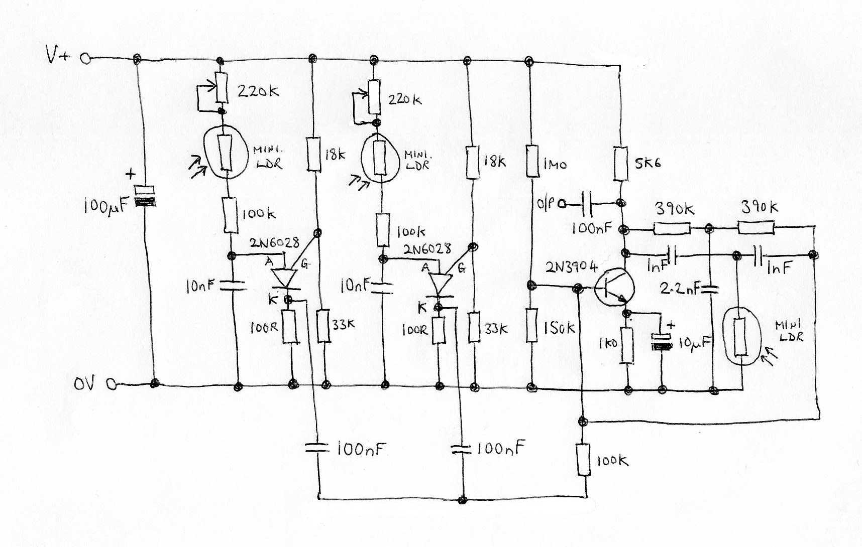

Having acquired some PUT's and wanting to try this out before embarking on another box build, I shot a short video with the scope in the background, even though it doesn't add anything to the sounds already offered in this thread.
I made the circuit according to the schematic (using slightly different resistances since I didn't always have the exact values), plus the changes suggested by PHOBoS.
Having only really made oscillators from CMOS chips, I don't really understand how this circuit works. I blindly swapped a few caps to see what happens, but the values in the schematic seem to be the best.

What it does add to this thread is that thought that I must get a proper oscilloscope one day! It is really difficult to get my PC scope to show anything really useful with those narrow pulses (perhaps I just haven't learned how to use it properly yet).
I knew very little about PUTs myself. I had come across them in SCR/Triac circuits and I knew that you could make an oscillator with just one of them. My "inspiration" was looking at this article:
http://www.allaboutcircuits.com/vol_3/chpt_7/8.html
The basic PUT oscillator that I based the circuit on is near the bottom of the page. I'd like to say that my approach was deeply scientific, but in fact, I kind of did the same as you, swapping components to see which worked best (or at all - sometimes it just stops oscillating).
Gary
Posts: 5883
PostPosted: Tue Jan 01, 2013 6:11 pm    Post subject: Reply with quote  Mark this post and the followings unread
a video, nice Very Happy
I didn't do much experiments with the oscillators yet (different caps change the frequency of course), did try some
different values on the filter and here I can agree that the values in the schematic seem to be the best. (unless you want a completely different sound).
analog_backlash wrote:
What it does add to this thread is that thought that I must get a proper oscilloscope one day! It is really difficult to get my PC scope to show anything really useful with those narrow pulses (perhaps I just haven't learned how to use it properly yet.
The signal on the scope is the output after the filter, which I wanted to mention is a damped sine,
with a rather small amplitude. But you can now see it yourself in the video Very Happy
Not sure what I will do with the circuit, probably add some sort of random voltage modulation, a CV in or maybe just leave it simple as it is.
I do have 25 of those PUT's now Wink
analog_backlash
Joined: Sep 04, 2012
Posts: 393
Location: Aldershot, UK
Audio files: 21
PostPosted: Wed Jan 02, 2013 3:14 am    Post subject: Reply with quote  Mark this post and the followings unread
The signal on the scope is the output after the filter, which I wanted to mention is a damped sine, with a rather small amplitude. But you can now see it yourself in the video Very Happy)
Yes, I realised after posting that this was the post-filtering waveform, which I could see on my PC scope. It was the original PUT pulses that I had trouble capturing (it was past my bedtime... sleeping )
I have about the same number of them - they were one of my impulse buys. I have lots of components that I've bought over the years, thinking "I'll find a use for those one day". If I come up with other circuit ideas using them, I'll let you know.
