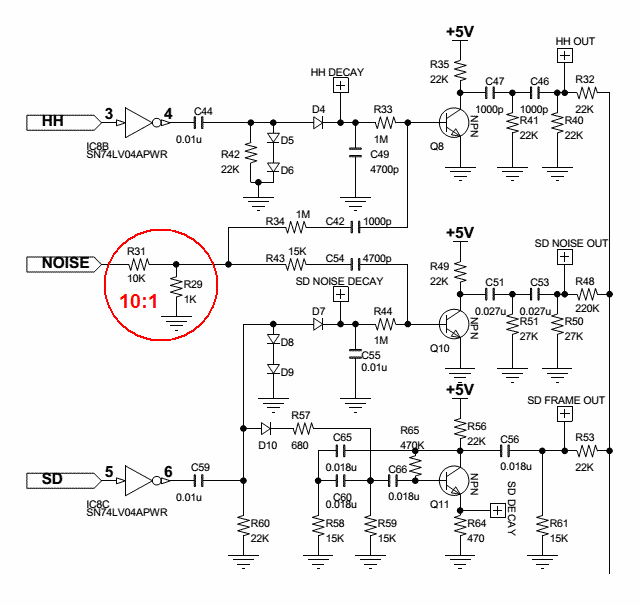

Working, but noise source not a good match, way to high on 9V with opamp buffer, and without its still not in the right range, messed about with pots between and so on today without getting satisfied, will try some different transistors tomorrow.
Kind of hoped that was a no transistor picking needed circuit :/
(Courtesy of Richardc64 I think it was)
This is the first time I've heard of noise being too high when powered by 9volts. Is that really what you meant to say?
In the monotripe the noise gets attenuated by a 10:1 voltage divider (R31, R29) before being applied to Q8 and Q10. By adjusting those two resistors the 2-transistor noise source should provide a sufficient level even without an op amp buffer.
R34 & R43 also affect the levels that reach Q8 and Q10.
Although the three randomly selected transistors I tried for noise produced equal-sounding levels, I still used a socket (3 receptacles hacked from a low-profile d.i.p. socket,) for the reverse-biased transistor.

PostPosted: Thu Nov 27, 2014 7:35 am    Post subject: Reply with quote  Mark this post and the followings unread
Yeah, Im socketing and trying some different transistors later today, and those are the resistors Im fiddling with.
Its also in a thing with lots of hanging wires, so its picking up a lot of rumbly noise which is what I meant with to high, as in to sensitive and amplifying that to much.
