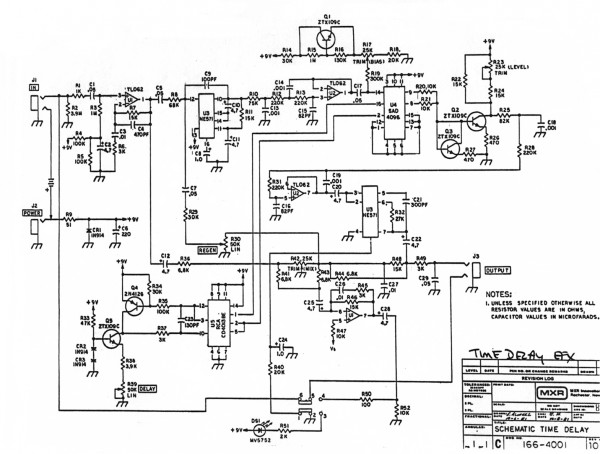

Hi All
THis has a wiered fault-no clock at the clock inputs-clock osc OK?
No sig at BBD output-but its at the input of BBD-probably a knackered SAD4096
I would love a schemo if available
Thanks in anticipation
P

Possibly this one?
 Filesize:  742.02 KB
 Viewed:  1691 Time(s)
StephenGiles
Posts: 507
PostPosted: Sun Mar 10, 2013 4:11 am    Post subject: Reply with quote  Mark this post and the followings unread
Not stereo but probably similar though!

Many thanks-thats the one-AND.............youv'e guessed it....the 4096 is FUBAR
Another guitar pedal doorstop/projectile.!! Ho-Hum
